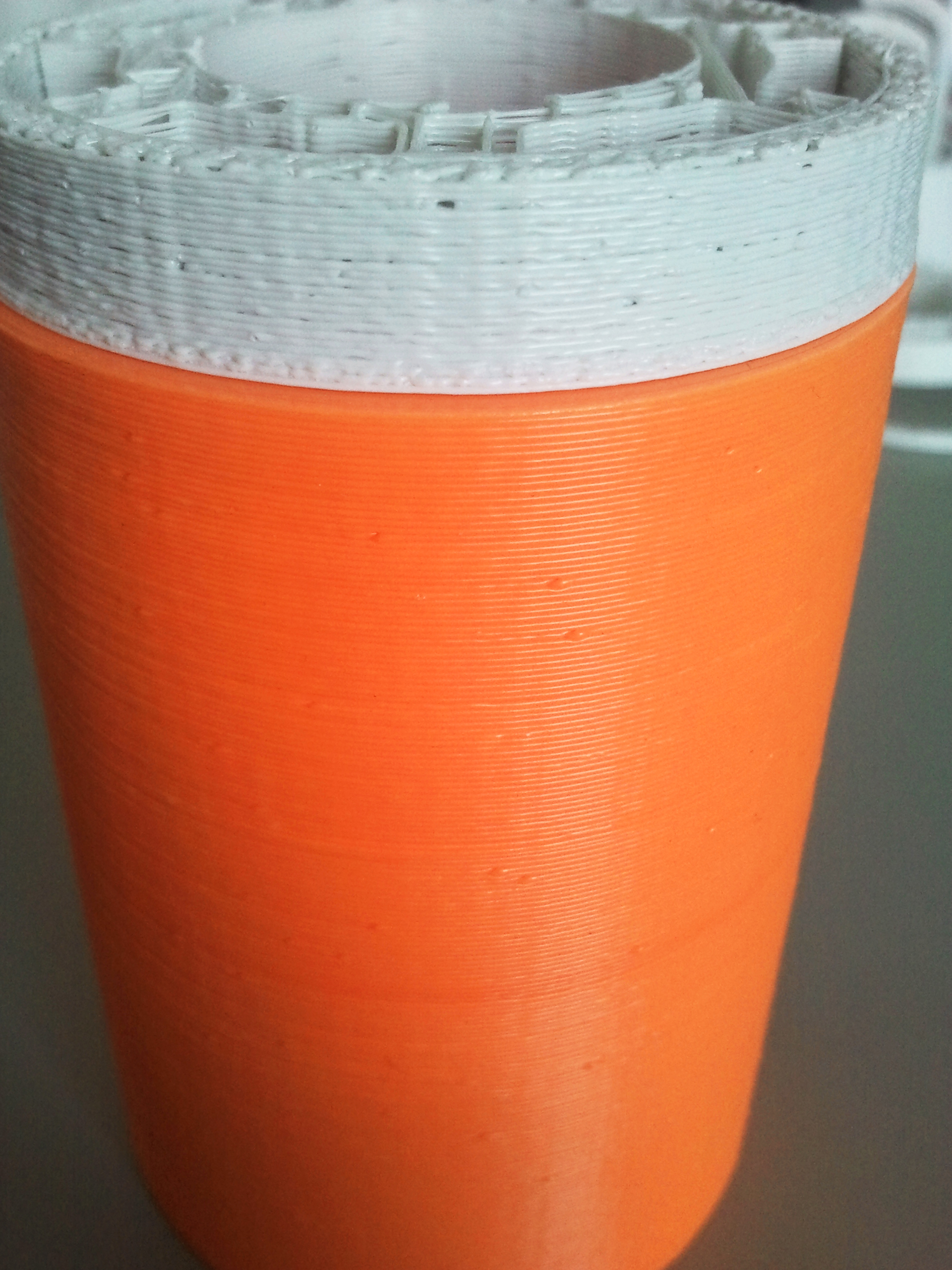

Back from a 2 week vacation and my printer (XZY Davinci) suddenly doesn’t produce the quality prints it did before.
See attached image for the difference. Orange is what it used to print like (have dozens of flawless prints like that) and the white is what it produces now.
It zigzags in the Z direction and there are a lot of small gaps.
My first suspect was the software update from Repetier Host, after a few test prints I did a rollback on my computer to get the old software back. That worked but didn’t affect the prints quality.
Of course I tried doing the obvious tweaks. Levelled the bed, cleaned the nozzle, tweaked Z offset, extrusion multiplier and print speed. Most where set correctly so they didnt have any significant effect on the quality.
I’m not sure what I can tweak or look at any more, so I’m hoping someone has had the same experience and can point me in the right direction.
Right now I’m leaning more to a hardware issue, but I wouldn’t know what to look at.
Thnx for any help/advice you can give me.

Have you checked the tension in the belts on your machine? This can cause major problems sometimes. If there is a lot of movement in the belts, in the x or y direction try to tighten the belt until it is taught, then try to test your print quality again. If this does not solve the problems you could also check for any loose screws in your machine that cause any kind of wobble. Also you could try greasing up the smooth rods to aid in smooth movement for the extruder. Make sure all your print setting are as they were before, e.g.no change in feed rate or flow rate. I have had a similar issue on my da vinci, I did all of the above and it seems to print good now (most of the time anyways).
Hope this helps somewhat.
First, I find white to be a very unforgiving color. Temp might be an issue as it’s a different pigment. I printed a lot of white at around 215°C. When I look at the orange for similar issues, I can see them (perimeter voids and waviness), though they are diminished. I’d double check the severity by printing something in orange for comparison.
Do you have the bearing slop issue? Grab the front of your bed and move it back and forth. Is there significant wiggle? Check out this video:
I have this issue. When printing round, curved or thin wall parts, I see waviness like that when it starts to loosen. I have to re-jam the shim into the gap. I expect the plastic yields with heat and time increasing the gap.
This may sound silly but if you using the XYZ ABS in white, it prints terrible… so change material and see if that makes a difference…
Also check the white idler pulley on the carriage belt, as that’s prone to wear if not lubricated frequently, the metal pin in the centre of the the pulley wears into the plastic causing quality issues with prints…

I’ve put my filament in the oven for about 2 hours to dry it out. That had no effect on the print quality. Did the same (a bit longer) for another spool, also without any effect. Although I have to agree with all advice here that the filament really isn’t sticking properly.
Maybe the temperature of the nozzle isn’t correct?
There was one setting that had a big effect on the print quality. Turning infill before perimeters off. To my surprise though because before turning this setting on actually improved all my prints dramatically.

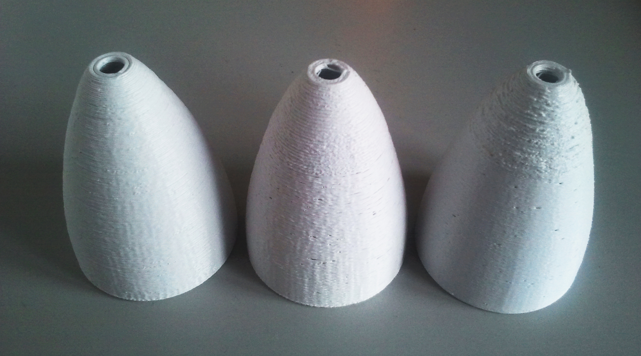

I added a pic of the results so far (also showing a whole new problem), sorry for the poor quality (new phone broke).
Left is what it printed like up to 3 weeks ago.
The middle one 3 weeks later without making any changes (besides cleaning the print nozzle and leveling the bed).
On the right is the current result.
Besides the top part getting messed up (does that every time, but only with this model, no clue yet what causes it) it looks pretty similar to the original old print. The print is still a little bit zigzagging in the Z axis, but definitely acceptable. The problem I have is the seems, they are pretty wide and go inwards while the original goes out. With this white filament the shading makes them very visible.
Is there any way to tweak this and get them seems tighter and maybe oozing(?) out a little bit.
