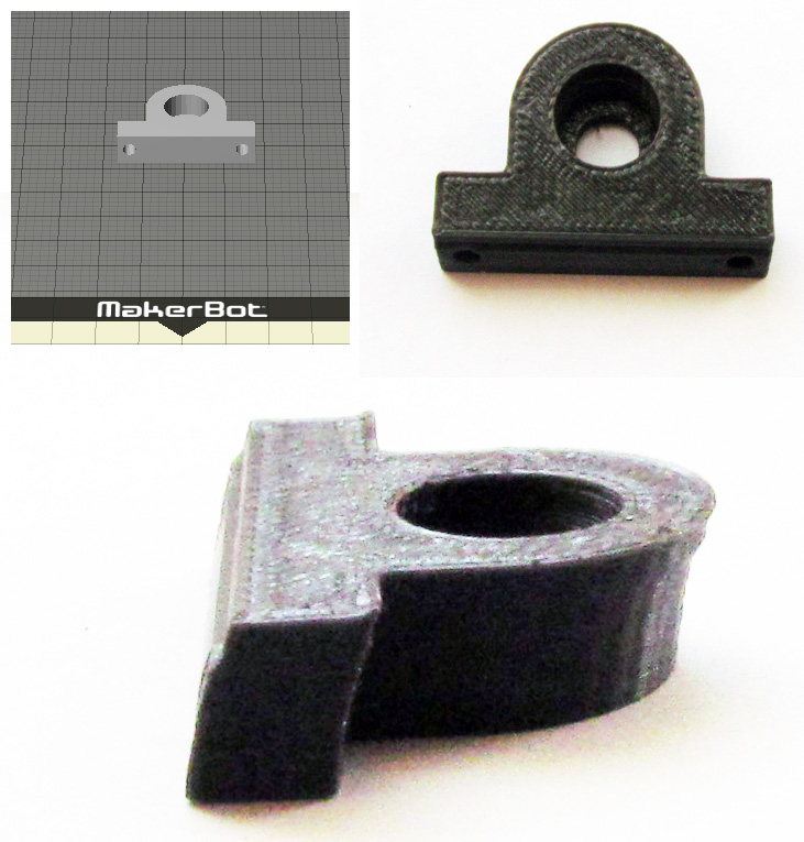

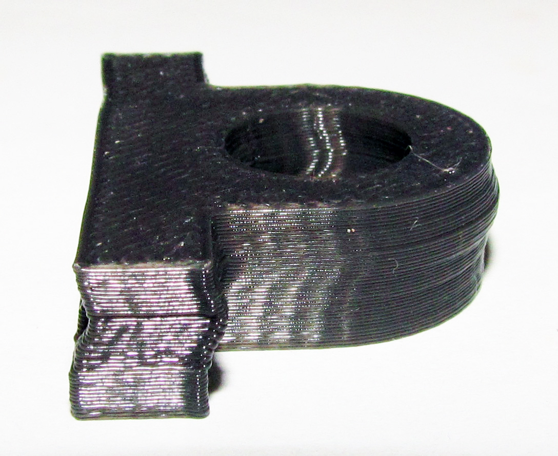

I printed one of these brackets, but it prints the layers ok, but they are not lined up properly, its like 1mm step on each layer so it looks like a pack of cards that have been slid to one side. any idea why its doing this?
I have a ebay “ctc duel extruder mk8” and i’m using MakerWare MakerBot desktop v3.7.0.108.

the last print was not dead center of the printer bed so i put the object in the center with makerbot then send it of to print and its a lot better but still not straight as shown in the pics, im hopping this might pin point my problem better.

I just uploaded a new printout. i changed nothing other than the location of the object on the print bed and its a lot better but still off a bit.

Could be one of the stepper motors is not behaving right. there is an encoder in the motor to tell the drive board where it is, from the photo, one of the axis is off, then other is good and the Z is good. Try unplugging and replugging the cable into the motor to make sure it is plugged in correctly. It may have come loose from shipping.

Check the grub screws on the pulleys are not loose
i checked and tightened all the screws and alan bolts and some were loose i now have very good prints.

No problem, pulleys often get overlooked the grub screws can be tight enough to grip but under jerky movements it can slip.
This issue of “stepping” layers is caused by 2 things…
first as as others have suggested ensure nothing is loose or binding on your axis travel.
second… An underpowered stepper motor will be unable to hold its proper position allowing it to drift as the print proceeds, as I am not familiar with your printer check your documentation on adjusting stepper currents.
our reprap has adjustable pots for every axis on the main board. Slightly increasing the current provided to our problem axis fixed the issue!
