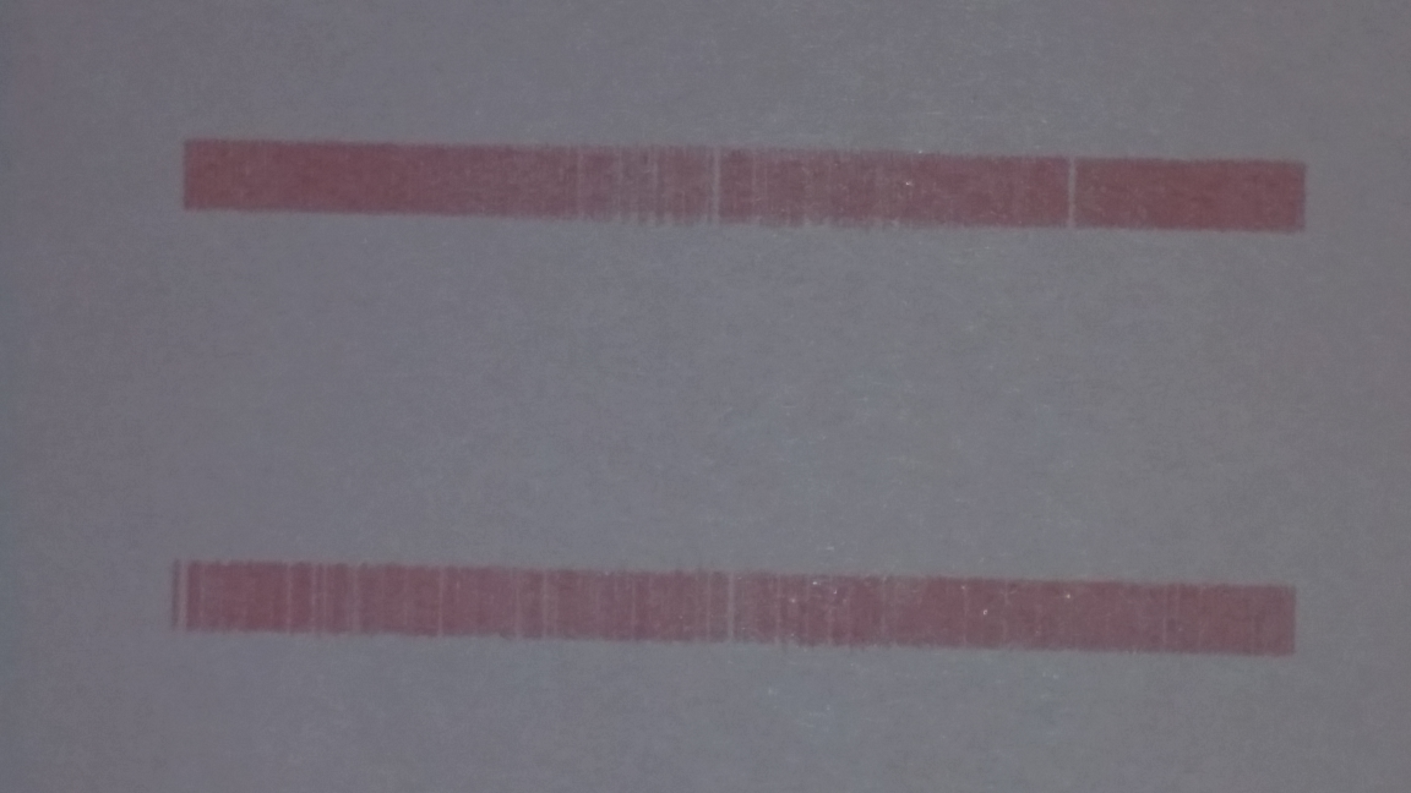

How many nozzles are you down on the pattern test on each head?

I just ran a pattern test at 1:40pmEST, did a heads cleaning wizard and ran another pattern test at 2pm. See images attached. I think the support (left) has two definite voids. The right head (model) many but they’re spread out. There is definitely a difference between before and after the heads cleaning wizard. I think I ought to run that about 20 more times…! What do you think? Thanks, Juliana

Thanks for the input. We half-tried the alcohol but the job wasn’t monitored and the alcohol dried up while it was soaking (bad but maybe not catastrophic). We re-hydrated with more alcohol, reinstalled the heads and I’ve been doing head cleaning and pattern checks. I haven’t run a weight test (aka load cell calibration) yet but it’s on my list of things to do. I just found a video on line for it; thank you YouTube! -J
I’ve been running an Alaris30 since 2010, and only had to replace one head this calendar year. Since I only run VeroWhitePlus, I can’t speak to the Durus materials, but my practice has been to more blot with a denatured ethanol dampened cloth, with about a 30 second soak against the heads.
When the one head failed abruptly following a crash, I tried to resuscitate it by flushing it with alcohol, after removing it from the machine. This was not successful, and actually demonstrated a negative result. Consider trying the the ‘solvent’ they sell for long term storage. It’s actually a base like the support, without the curing agents.
Good luck!
Hard to make out from the images exactly, but I was told the print head will need replacing if:
Up to 5-7 nozzles blocked in one place MAX.
Up to 12 nozzles blocked in total across one head.
You can fit the print head yourself.
The printer overlaps the print pattern to compensate for some blocked nozzles, but if more are blocked than detailed above this will have an effect on the parts.
Thanks for these good ideas. Our heads were swapped about a year ago so I think I might have some Durus model material gunk in either head so I have to do the heavy-duty cleaning on either/both. We half-tried the alcohol but the job wasn’t monitored and the alcohol dried up while it was soaking (bad but maybe not catastrophic). We re-hydrated with more alcohol, reinstalled the heads and I’ve been doing head cleaning and pattern checks since then (about 2 weeks). Unfortunately, they’re printing worse than ever now. I have some NaOH here from when we had a Stratasys 1600 SST system (soluble support meant we kept a bath of NaOH for dissolving it). Hopefully it can burn away any of the old gunk and new gunk. It is tempting, however, to pack them up and send them off to the print head recovery company… For $129 (99pounds) each, it seems like they know what they’re doing and I’m just fiddling around. Thanks for your input. So, you don’t expect the NaOH to burn up anything on the inside of the head? I could try using a syringe to push it through the ports… or, we could pay those nice people to do it. Hm. Decisions decisions. -J

OK, so we do have a service contract - BUT it doesn’t cover “consumables” and the heads are considered consumables. A tech came out a year ago and swapped heads (model-support) and that bought us more time. Thing is, they didn’t really give us great detailed instructions about how to clean the heads. We/ I thought I was following the directions but without proper training, the interpretation is wide. Plus, starting 6-mo after we got this printer, we used Durus material and it appears that Durus is harder on the heads (aka it gunks up faster) compared with Vero. The service contract NOW contains a once-per-year training and maintenance visit. That would have been great to have gotten last year.
The two main reasons why I think the heads are the problem are: (1) the July-service contract tech says so and (2) because the prints are bad (even on things that used to print fine). From knowing what the stl and solidworks model looked like, I can see where the support was meant to print and instead the model material above it has sunken down in the spot above it. I used to be able to print a whole bed of these small knobs and then a few months ago, I saw them “sinking” - the support not showing up most of the time and the model material blobbing down as if it were deposited but fell to the lower height since the support wasn’t there. One time this spring, I printed a whole bed and the parts were basically glued-down - no support, just model material straight on the print bed. I chipped them off and I’m very impressed that I didn’t scratch the print bed (which I believe is only aluminum) with my steel scraping tool! The tech that was here did a load cell calibration in July and said that the heads are bad but that he’s tried to get as much as he can out of them - I take that to mean he’s increased the voltage to the drivers/actuators that push the material thru and he said if we keep doing this, it will become erratic. I haven’t done a load cell cal yet myself - it’s been a month and we did a soak in alcohol since the last one. It’s on my list of things to do but I’m not looking forward to “erratic” behavior.

Hi, you can take the heads out, make sure not to loose the small seals on each side, than you can put the heads in isopropanol and also fill the inside with isopropanol, leave it overnight , make sure not to damage the electronics and cover the isopropanol bath so it does not get evaporated over night, than blast with compressed air, if it is not better than you have to go for new heads, I am running an Eden 260 for more than 6 years, good luck
Use pure IPA (isopropyl alcohol). Put it in a syringe (10 ml) and put a 1cm long rubber tubing instead of the needle. Remove the heads and clean them first with IPA (don’t forget to wear nitrile gloves, of course). Be sure to have pure IPA and clean (never used: no particles inside). Then, flush the head with the syringe through one of the holes on the head (where material refills the head usually), but don’t forget to close the other one with your finger (wear clean nitrile gloves for that) or you’ll have IPA in your face… Do it as long as the nozzles are clogged (typically 2-3 times).

I took these photos almost a month ago and never posted them. I tried increasing the voltage to the piezoelectric controllers. (They are what control the opening and closing of the little doors that allow or restrict the flow of the uncured material.) The tech had the voltages pretty high and I just increased the model voltage to the max. Then I ran the weight cal test and it asks the printer to print 4 or 5 grams of material. What I got from the support head was close to what was requested. The model head just made a thin layer which I scraped off and weighed. It was just dust really and nowhere near the amount I want. The model head is BAD. Now, I’m just waiting for the $ to get a new one. Once we have a new one, I would like to try cleaning the old one with the methods described here but for now, I’m learning to live without a 3D printer. So sad… sniff, sniff! Thanks for all your help, 3dHubs. -J

Hi EB. Well, I’m not sure this is going to be the standard answer, but… a few weeks after I posted this, my boss got on the phone with our 3D printer support/ reseller company - the people between Stratasys and us. I don’t recall the phone call being particularly loud or anything but a few weeks later, a new head arrived and we didn’t pay for it…! A few weeks after that, I was at a training event with our support people and I told them that I had wanted to say thank you but I didn’t want to get into a mess or overstep my station. They said that it didn’t come from them, and it would have come from Stratasys?!?! I don’t know that this will ever happen again but you could try. I think they (both groups) sold the Durus material without stressing that it needs an intense (and different than Vero) cleaning regime. When we got the new one, I wanted a proper tech to show me how to install it and when he did, he took the old one back! Too bad - we had plans for trying to clean it.
Unfortunately, as soon as it was clearly not working well, it just got worse and worse. I tried like crazy to clean it with alcohol and Print Head Wizard but it just kept getting more and more clogged. I did do the thing where you jack up the power to the piezo-electric gates. They were at their max and just about nothing was coming out. We sold our old Durus material on eBay and are promising ourselves not to buy/ use any more. Vero is not bad stuff. A little more brittle but at least it works!!
