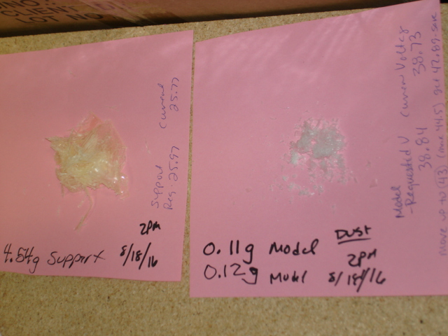

I just ran a pattern test at 1:40pmEST, did a heads cleaning wizard and ran another pattern test at 2pm. See images attached. I think the support (left) has two definite voids. The right head (model) many but theyā€™re spread out. There is definitely a difference between before and after the heads cleaning wizard. I think I ought to run that about 20 more timesā€¦! What do you think? Thanks, Juliana

Hard to make out from the images exactly, but I was told the print head will need replacing if:
Up to 5-7 nozzles blocked in one place MAX.
Up to 12 nozzles blocked in total across one head.
You can fit the print head yourself.
The printer overlaps the print pattern to compensate for some blocked nozzles, but if more are blocked than detailed above this will have an effect on the parts.

I took these photos almost a month ago and never posted them. I tried increasing the voltage to the piezoelectric controllers. (They are what control the opening and closing of the little doors that allow or restrict the flow of the uncured material.) The tech had the voltages pretty high and I just increased the model voltage to the max. Then I ran the weight cal test and it asks the printer to print 4 or 5 grams of material. What I got from the support head was close to what was requested. The model head just made a thin layer which I scraped off and weighed. It was just dust really and nowhere near the amount I want. The model head is BAD. Now, Iā€™m just waiting for the $ to get a new one. Once we have a new one, I would like to try cleaning the old one with the methods described here but for now, Iā€™m learning to live without a 3D printer. So sadā€¦ sniff, sniff! Thanks for all your help, 3dHubs. -J
