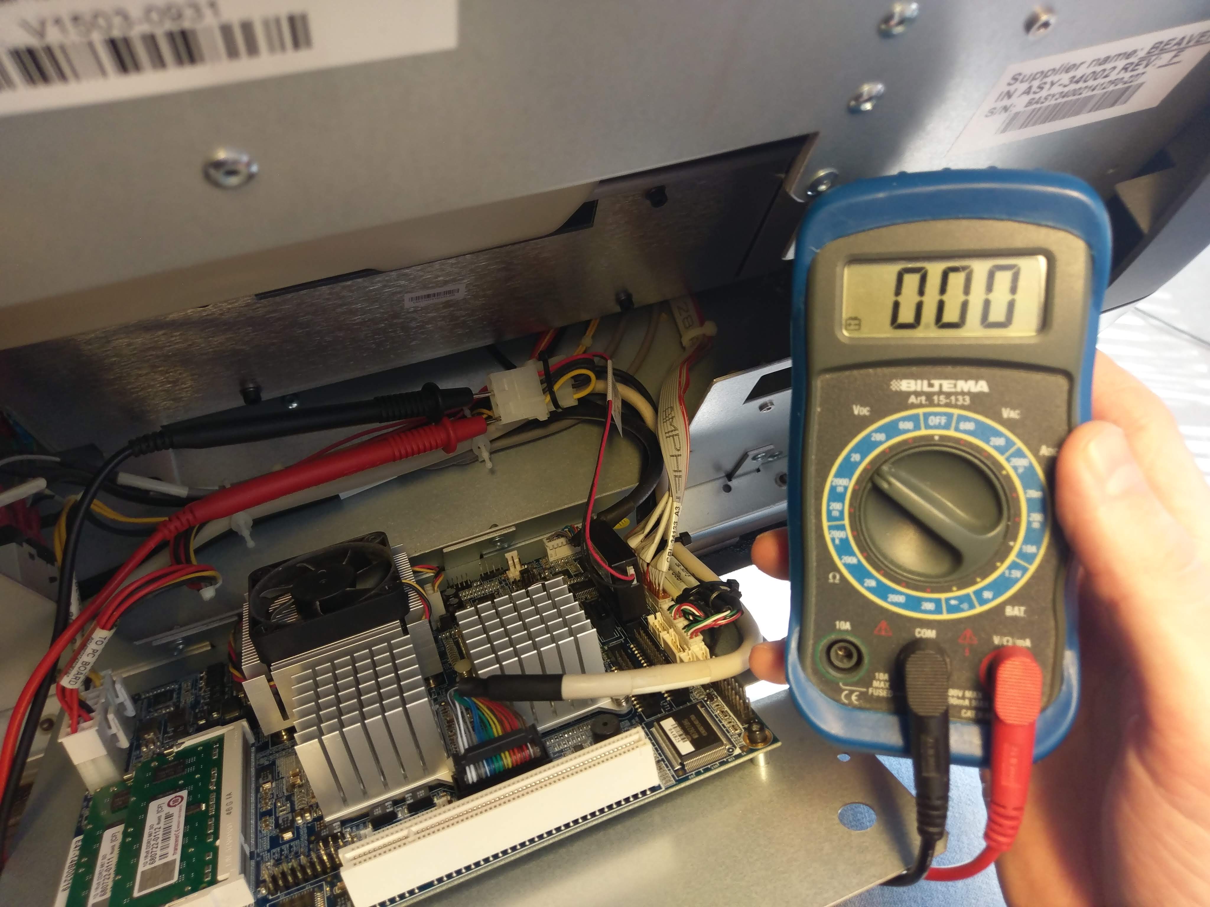

I tried with a multimeter, and it seems as if there is no power coming out of the PSU (see attached image). I also tried to check the current on the cable in top left corner of the internal pc (“to PC board”). No current there either.
Am I right in saying that the PSU is faulty? Question then is, how to take out the PSU. I tried opening up the front panel on the objet (next to print material drawer), to see how the PSU is connected to the stratasys board. A daunting sight to say the least. Are there any tutorials out there? or schematics of the cables at least?
Still, i would rather spend days detaching all the cables instead of paying 5000€ ++ for someone else to do the same job.
Sounds like the PSU is dead but to make sure, check the voltage (120/240) going into the PSU. If its present, then check for fuses on the power supply itself. If those are good, then its a good bet that the PSU is faulty. Perhaps you can order one and replace it yourself?
