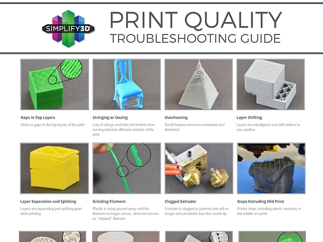

The team at Simplify3D combined their broad base of experience into the Print Quality Troubleshooting Guide, a user-friendly tool to help users identify 3D printing issues, understand what causes them, and find solutions. Twenty-three common print quality issues are identified and multiple solutions are offered for each problem, providing a one-stop resource for all kinds of 3D printing questions. The company is already working on expanding the guide, ensuring it will continue to be a valuable resource as new techniques and settings are available in the future. Although there are some solutions unique to Simplify3D Software, many fixes can be applied regardless of your software and hardware situation.
Simplify3D has a unique perspective to understanding printing challenges and solutions. “We work with 3D printer companies from all over the world to optimize the output from their machines,” explains Simplify3D CEO Clayton Webster, “so we have a deep understanding of the typical problems people encounter. We’ve worked with an extensive list of printers and filaments, and we know how to coax quality to the highest possible levels. We realized that our knowledge of troubleshooting could be a huge help to the broader community.”
The guide was developed with all levels of 3D printing expertise in mind. Highly detailed images help new users identify and name their problem. After they find the photo that most resembles their print, they can click to see multiple causes and solutions. Or, if users know what the issue is called (i.e. under-extrusion, stringing, layer separation…), they can browse a list of terms to find a solution.

- Are there STL files for these issues? IE a test cube with 3 perimeter lines?
- Are there test files I can print to see if I have any of these problems?
- Are there ‘Correct’ pictures showing what is felt to be a ‘cure’ to the problem?
- Are there MAPs? ‘Make this adjustment… See this go here, See this go there.’
IE, once a correction is made, it would be typical to have a different problem if the adjustment is too much.
Too little extrusion to too much extrusion to wavering around okish to REALLY nailed it.

Awesome guide, thanks. I’m a huge Simplify3D fan. The suggestion for providing .stl files to be able to print and compare results is a great one.
These are all great suggestions! New additions to the Guide are already in progress, so we will be sure to consider these as well. Thank you!
