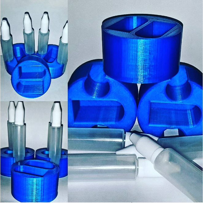

I disagree with the point your making on price. The printers in the $225-$500 are largely the same kits rebranded, or closed source designs that require their own branded filament, which poses its own headaches and horrible price points. The prints below were printed on my ANET A2, cheap printers are fine, yes, a bit slower, but acceptable. The prints below were all printed at 50mm/s theyre consistent, completely seamless, and dimensionally accurate to a point where any size discrepancy could easily be blamed the calipers factory +/- 0.05 accuracy rating… Printers in this guys range are fine, they just require a little love, and patience…
