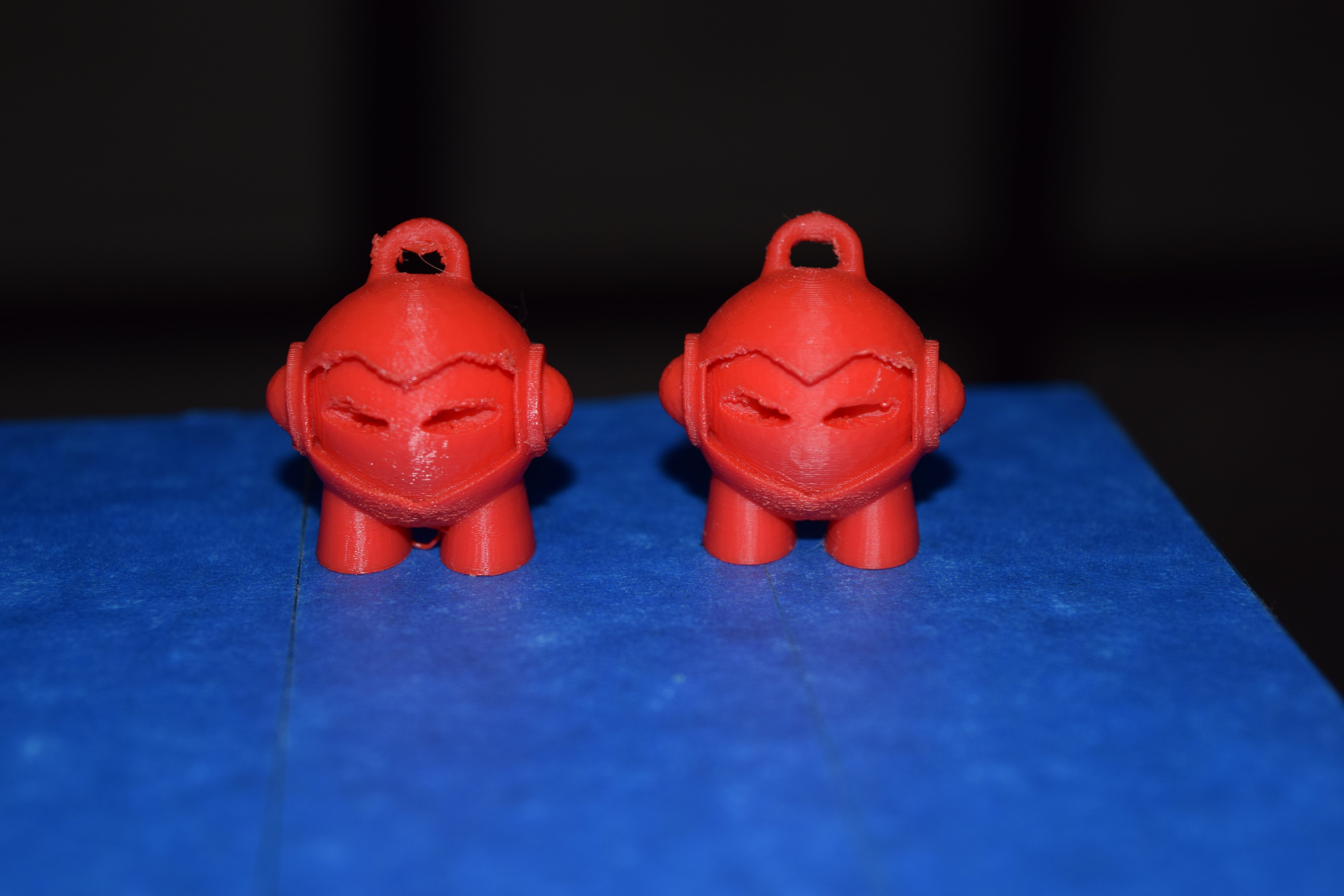

I did import the model into tinkercad, and export it. S3d would then duplicate it, but tinkercad reduced the polygons and changed the texture.
photo of the dimpling caused by reduced polygons
