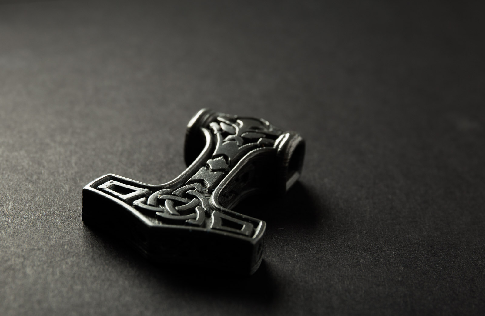

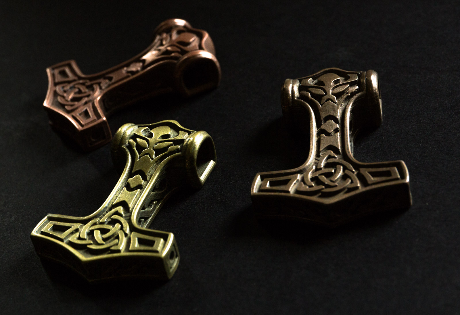

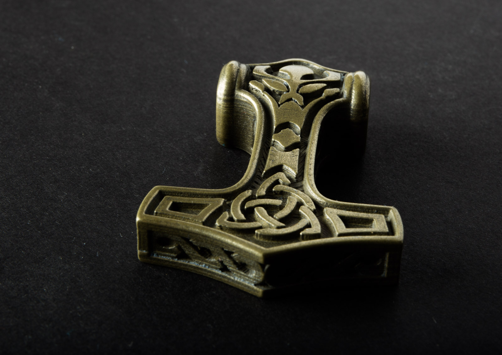

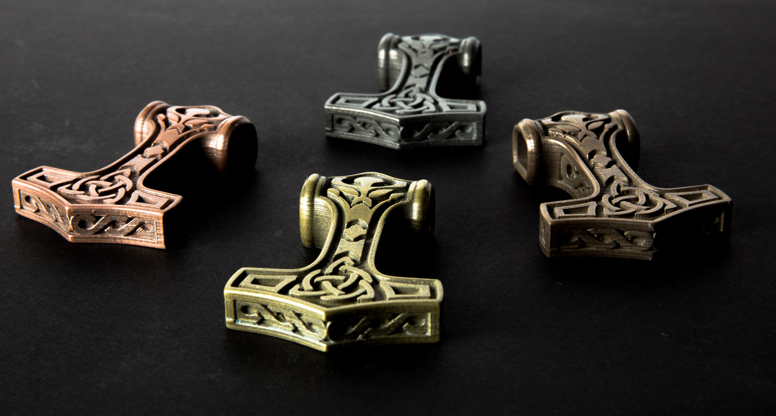

This is Mjolnir (mjolnir by januszeko - Thingiverse) printed on my UMO+ in ProtoPasta stainless steel and Colorfabb Copperfill, Brassfil and Bronzefill. Polished in self designed rock tumbler (Affordable Rock Tumbler by J_T_3_D - Thingiverse) for 48 hours and finished with buff wheel.

Woah! Those are some sick prints! @victorp @pherkan check it out
These are awesome! I’m kinda jealous.
Amazing! How many outer walls did u use?!
Yep, nice pieces of printcraft (and photography).
What tumbler filler did you use to polish these?
These look great! Great pictures too!

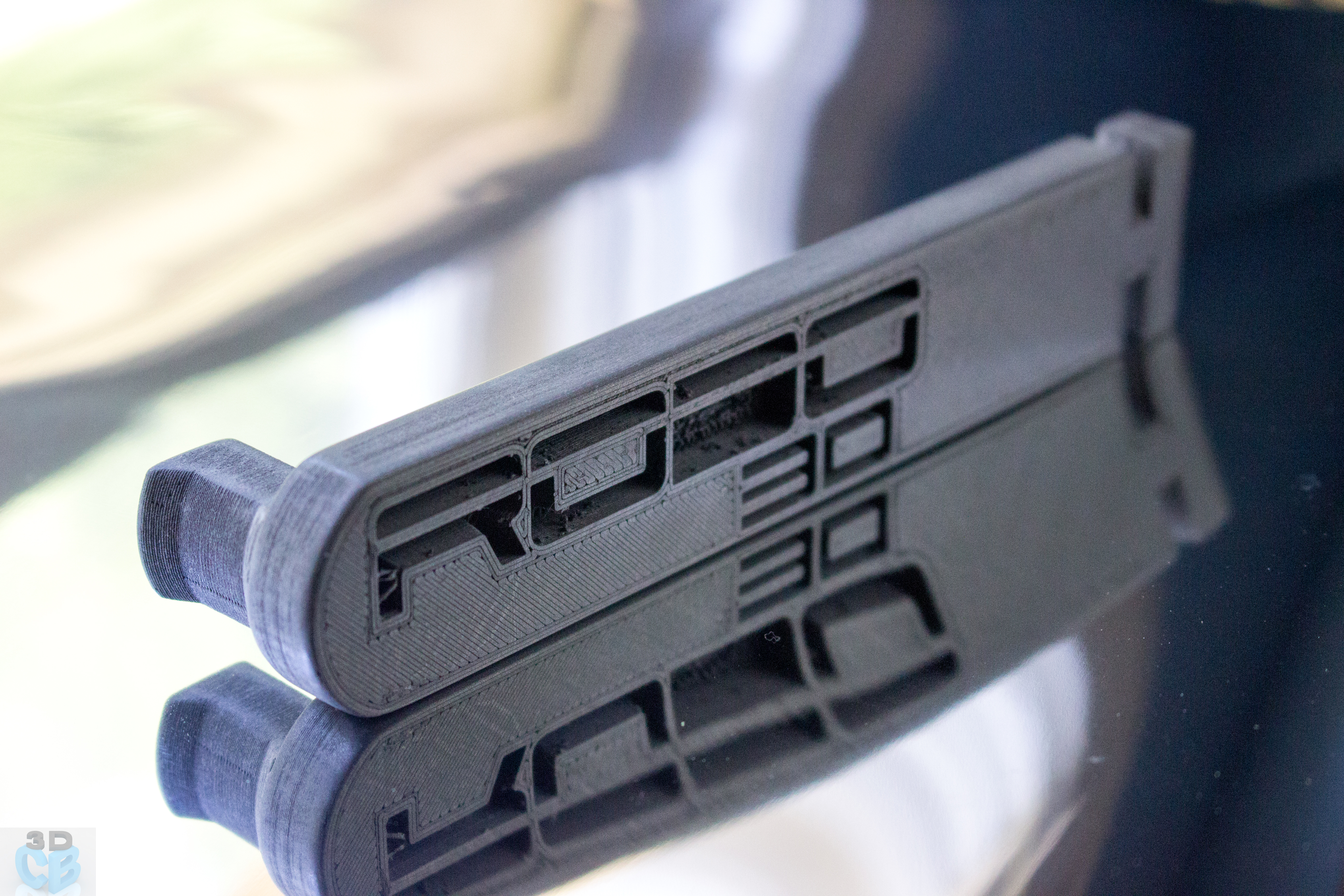

Here is a Proto-Pasta Stainless Steel Print and a Filamentive Carbon Fiber I did
brass screws approx. 24 hours and walnut shells for ~24 hours

Walnut shells? I haven’t heard that one. That tumbles metal? Gonna have to give that a try.

the nutshells make the surface smoother - in theory
I am not sure if this is really necessary. Sometimes things help, allthough they only exist in your imagination
