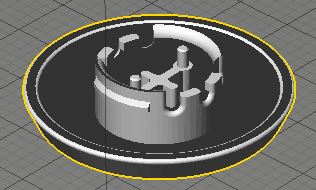

Hi guys I don’t know the right search term for this problem on the forums. I have a part I’m trying to print that is concave or dish-shaped. It seems like no matter what setting I adjust, the software entirely fills the dish shape with plastic as if it’s holding water. It’s a small part with 1.5mm wall thickness. Does anyone know what setting(s) could be causing this?

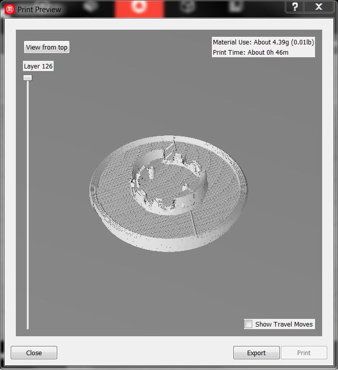

Sure here’s a screenshot of the original part in Solidworks, and a shot of how it turned out in real life.

Interesting, are there any hidden surfaces or anything that would cause the slicer to treat it as an enclosed solid space? how does it look in the slicer before slicing?
In the Solidworks save as dialog I can see the STL triangle wireframe, and there are no hidden surfaces there. The shading in the slicer isn’t great, but you can clearly see geometry there that ultimately gets completely filled in.
UPDATE:
My solidworks model was all surfaces. I knit them into a solid, and the preview now corresponds to reality. I will try this out but it looks good so far. Thanks for responding!
I cannot see from this picture, inside the dish structure which shape has the plastic ? It looks like the exagonal structure of the standard makerware infill, maybe there is an error in the model or a “ghost” surface.

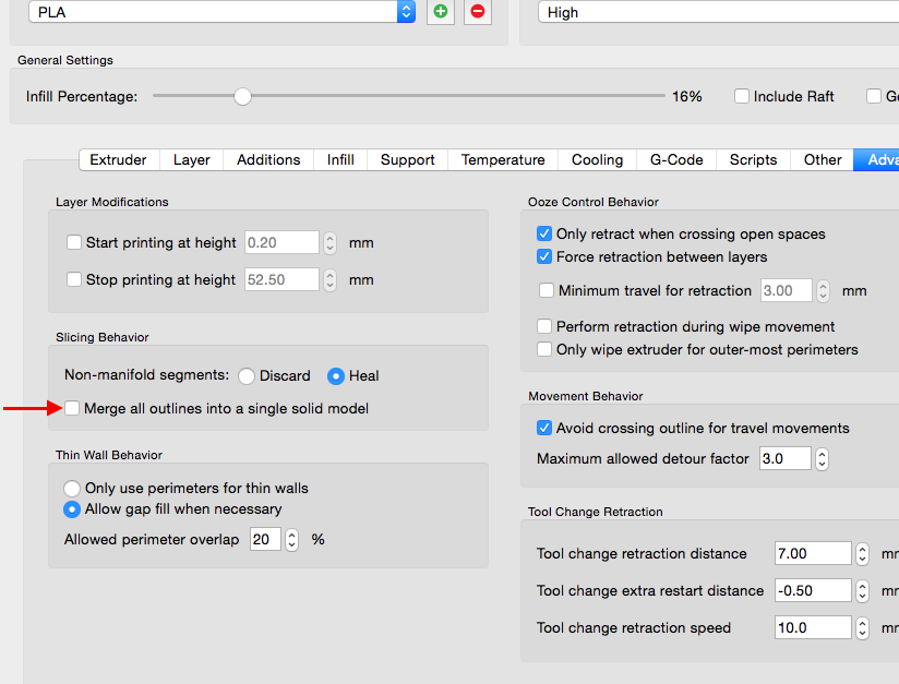

also make sure the “merge all outlines into a single model” box is unchecked

Thanks for the help everyone! It was a result of trying to save the file as multiple surface bodies from SolidWorks. Converting to a solid first fixed the problem.
