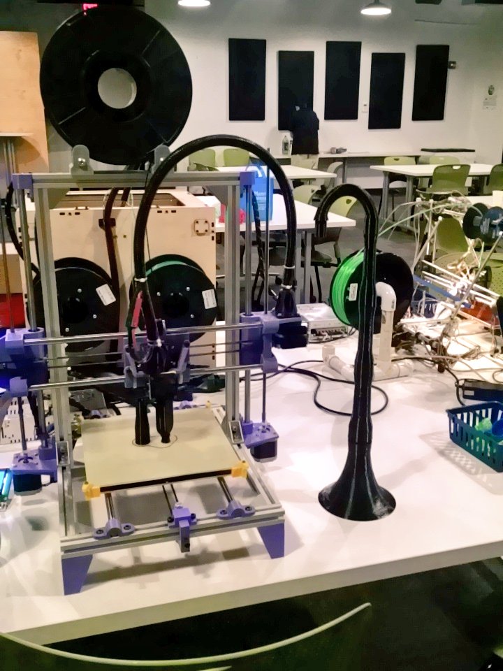

Branden brought down his Flex Drive printer which combines elements from a direct drive extruder and a Bowden. It’s lightweight and reduces the reciprocating mass on the printhead yet has the extruder gear directly connected to the carriage. Equipped with a B3 Innovations Pico hotend and a 0.6 mm nozzle he printed additional parts for his 3D printed horn seen below.
