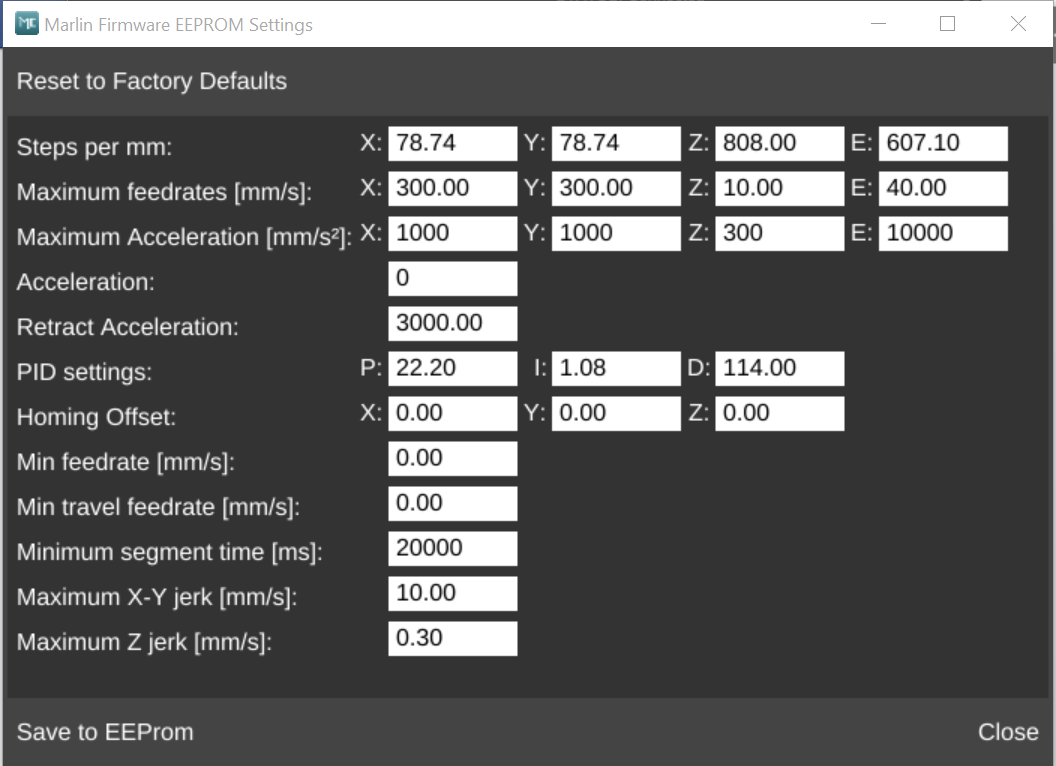

How do I stop the acceleration greater than a jet plane?
Someone in the company thought it would be a good ide to have the accelerations maxed out, Quite literally faster than a supersonic jet plane. To fix this you need a program called matter control. It is one of the few programs that can adjust the firmware in the printer without destroying it.
Put the settings in as such:

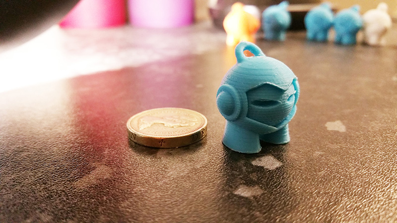

Here is an example of a print from the Creatbot DX 03. Never mind the background, it has better lighting.
That’s one ridiculously good looking Marvin, thanks for sharing! What settings did you use?

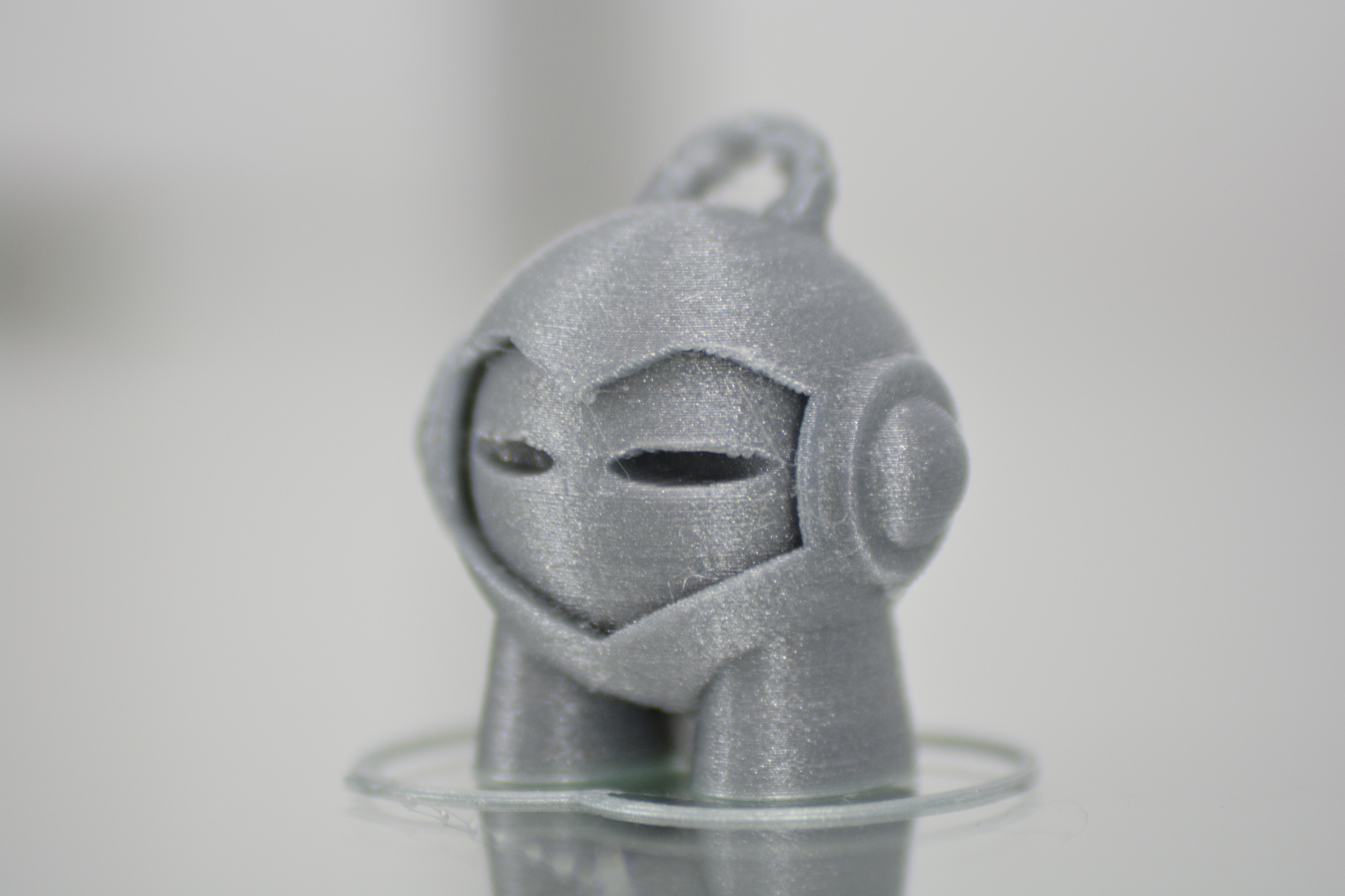

BTW:
Attached Marvin to check the quality (100microns, 20%, ABS Light Blue).
Thank,
Adam
