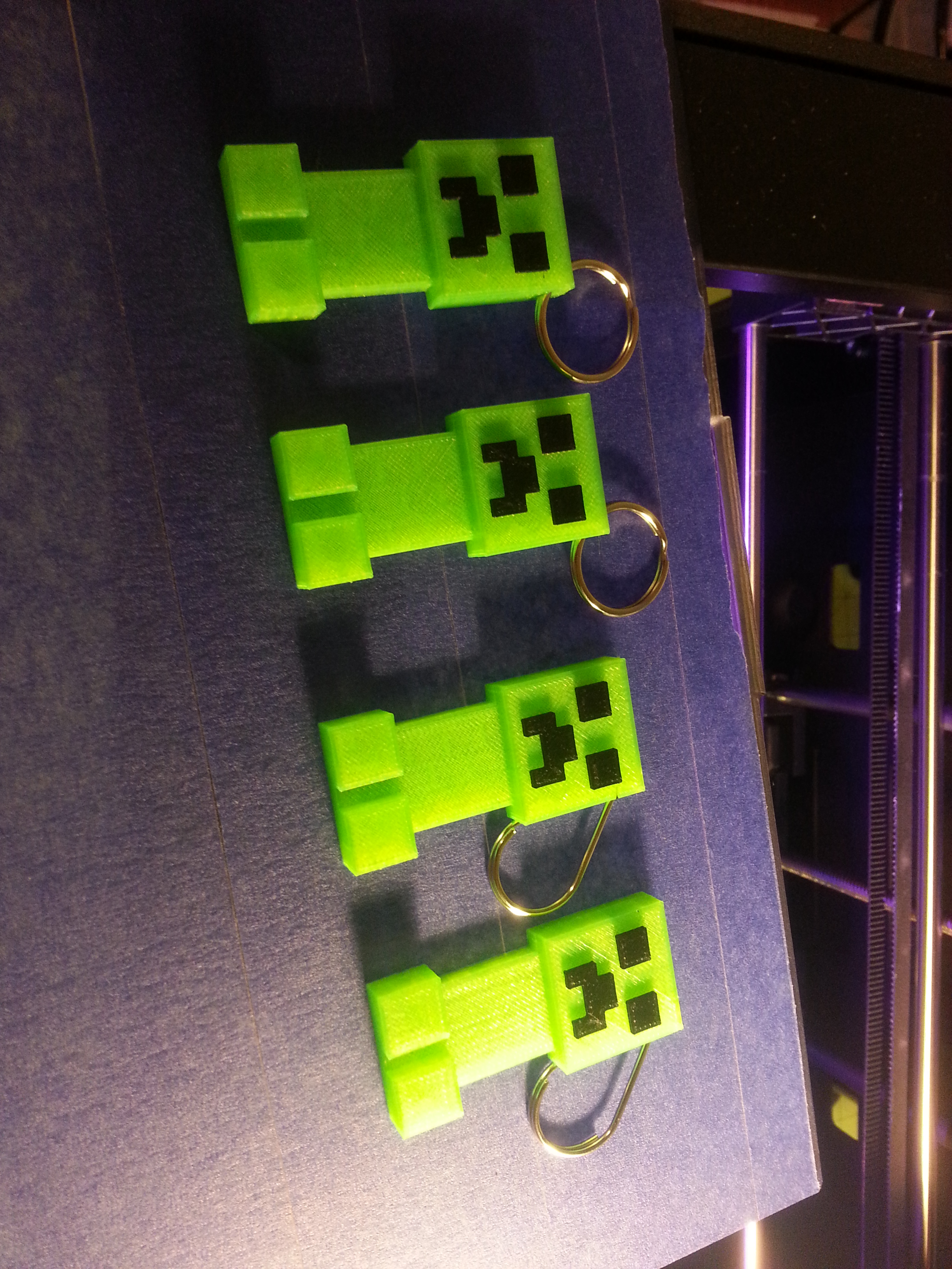

Waddell, did you get the info you were looking for? I have some very easy methods of doing this on a single extruder machine (Replicator 2) with Simplify3D and I’m willing to create a tutorial video to show you how. I just don’t want to waste a lot of my time or yours if you have already got it with a way you are happy with. I actually specialize in doing crazy creative stuff like this. Here are a few pictures of some of the work I have done with this technique.
