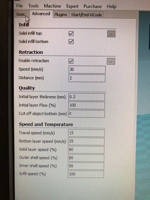

Thank you for your help. I am not able to see if all the pictures loaded. if not I will add them one at a time.

i printing directly from catia.
For the expert config your filament sizes are not 1.75mm as you said the filament is, this will cause over extruding if its the 1.5 value is being used (this would cause a clog in extruder) and under extruding if the 3.0mm value is used.

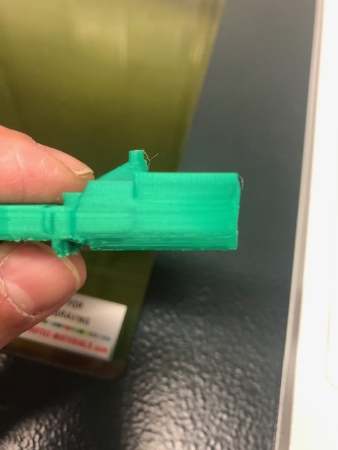

thank you for your help. I changed the fila diameter to 1.75. I was able to complete the whole piece but lines are very noticeable. I was thinking the Z offset was too high. So I changed this by .05 and currently printing another piece and seems to be looking better. Also factory setup for gap 0.2mm and I see most people set theirs at 1 sheet of paper.
Picture one heavy lines printed laying flat. I changed the Z offset .05 and rotated the part vertical picture 2. only thing is bottom of part looks like it may have taken too much heat from the bed. What do you think? because the rest of the part looks good.

It good you getting prints now, if you have steep overhangs then the quality may not be perfect. There are a few things that affect this including heat, try lowering the bed temperature (PLA can print without a heated bed on some surfaces) and ensure the part cooling fan is high enough to cool the filament fast, also the enclosure on your printer may be a hindrance because PLA is better quality when it cools fast.
Layer height also affects overhangs the lower the layer height the steeper the angle can be. You can also try increasing the extrusion width a bit this can help and it may also give better adhesion between layers. i use between 0.44 - 0.5 extrusion width on a 0.4mm nozzle. Also if you are able to choose the z seam position try make sure that it doesn’t start on a overhang if possible as this will help quality.
If you want your parts to be close to perfect on the overhangs you can use your second nozzle with dissolvable filament printing supports, this will take longer for prints but you should get a better finished product.
There is also an elephant’s foot that occurs on the bottom of prints this occurs from the bed being too hot and the first layer being too close to the bed, for PLA the glass transition point is around 60 degrees so id recommend this to be the highest bed temperature used. You can also lower the bed temp after a few layers as the weight of parts can also be the reason for the thicker bottom. if you cant get around this then you can use a deburr tool to cut away the extra filament.

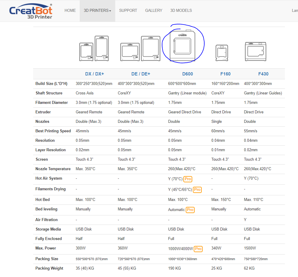

Do you use a D600? I can print the small stuff but nothing large. I have been reading that I should be using 3.0 filament for this printer. so I purchase it and it doesn’t fit the extruder even after creatbot support told me it would. FML LOL 3 weeks with this machine and nothing.
I don’t have this printer but most printers have the same trouble shooting, with a printer as high end as yours it should run no problem so not sure whats going wrong.
I added a photo of the creatbot website and circled the printer i assume is yours, on their specs it says 1.75mm for that model, some of the others support 3.0mm but not that one as far as i can tell.

If the filament looks like it is under extruding then try all of these before your next print (raise the nozzle temp, lower the speed, check the extruder gear that comes into contact with the filament and ensure it is gripping enough and that filament isn’t stuck between the teeth, make sure that the nozzle is actually 0.4 mm as set and make sure the nozzle is unclogged before every print).

My printer has option for 3mm only it is only designed for 1.75. So I think it is standard setup for all their printers. What I have changed is
  1. set the printer to 3mm not 1.75 even though I am running 1.75
  2. turned of retraction and added Z hop .25
  3. heat 210c bed 60 shut off after 5th layer
  4. increase feed to 115%
  5. 30mm/s print speed
  6. extrusion width from .4 to .7
  7. extruder nozzle from .4 to .8
    When this is finished I will try to increase print speed not really sure what to do. What I am printing now has cycle time 107hrs way too long. my piece 300x300x50. I need this time to be cut by more then half in order for this machine to be worth the cost.
