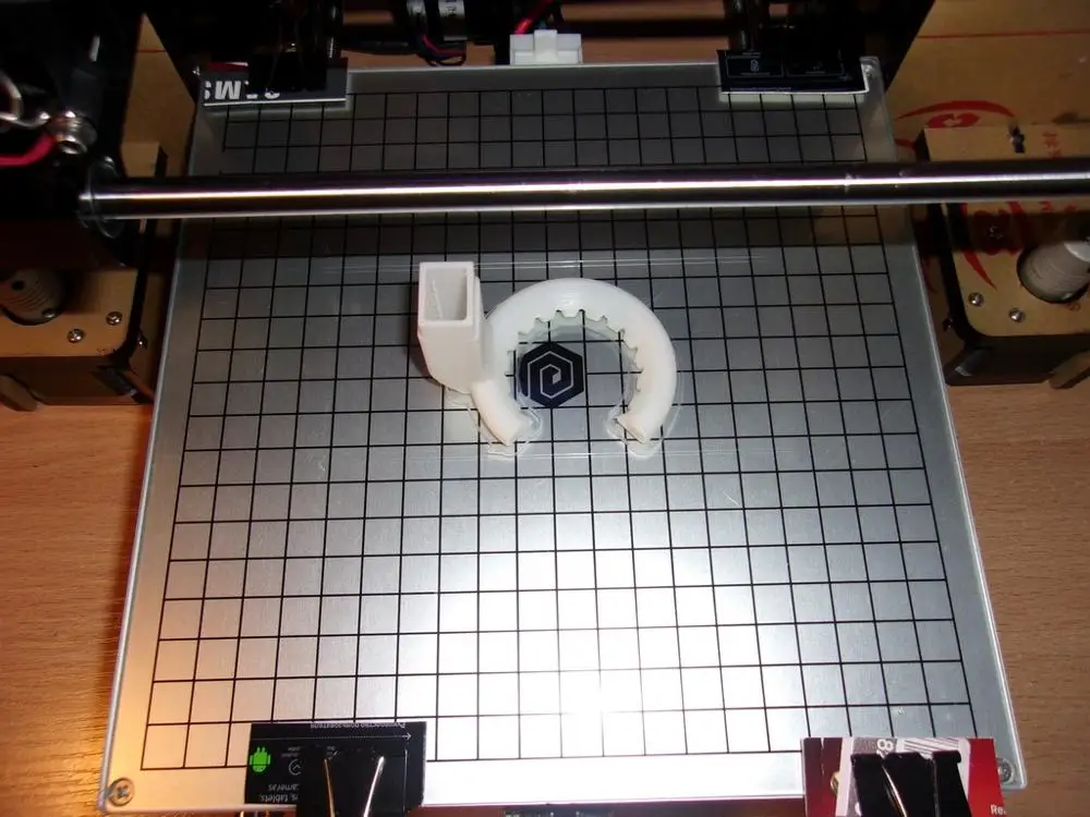

You can’t really go wrong with normal window glass I went to wilko and got a clip from slightly larger than the bed and glass cutter from the tools Isle and scored and cut the glass sanded corners with 600 grit paper (wear a respirator and do it outside!) and I’ve had the same piece of glass for over a month now no problems with it but the only drawback being the clips need to go on the back of the bed and the sides not the front out your head will crash into them, I’ve had the bed upto 125°c and its functioning fine still no cracks
