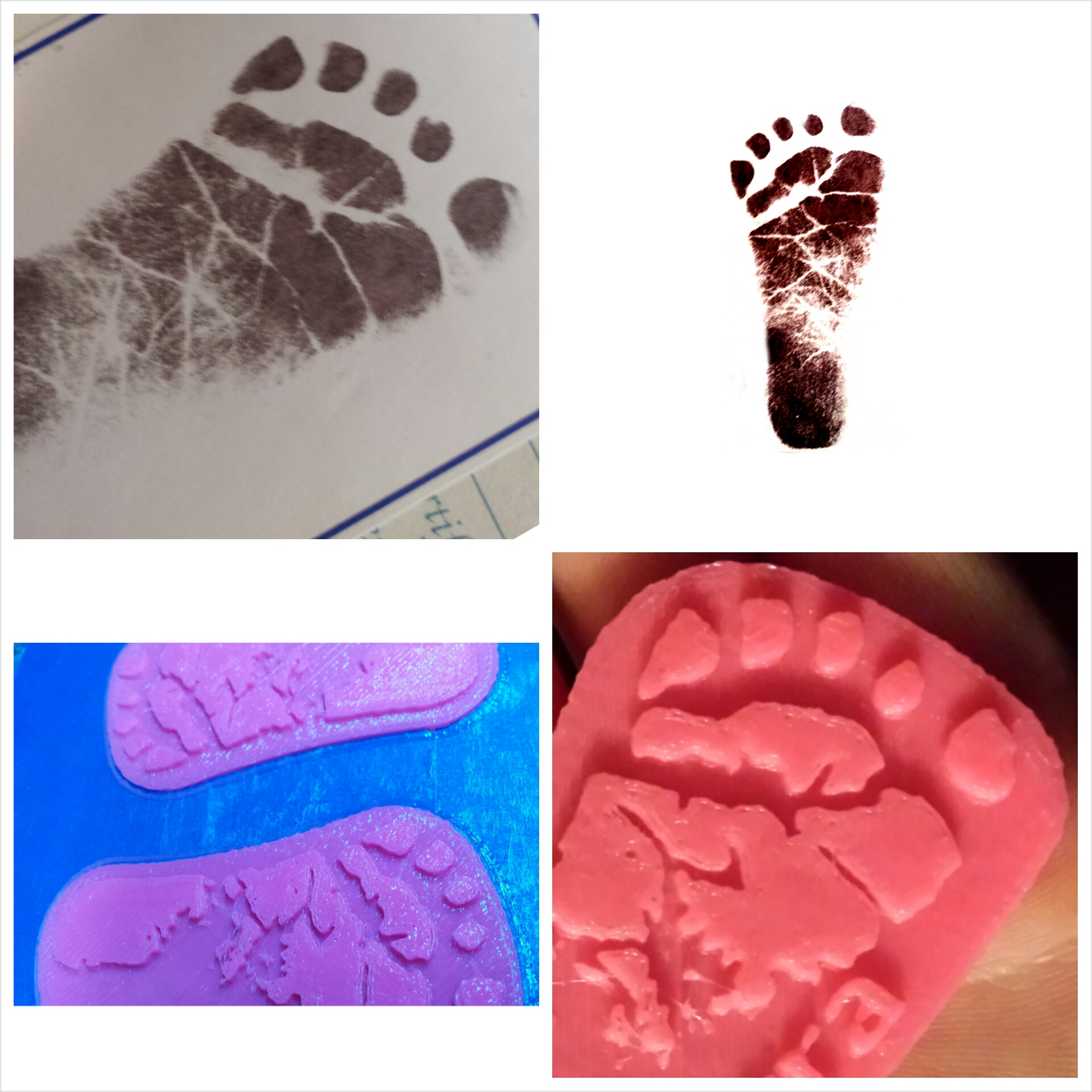

I have had a customer request for a 3D print but at the moment cant see how I can help.
Wondering if anyone has any good ideas.
The lady in question has a friend who has lost a baby, her friend has the babies foot print in ink on paper but this is starting to fade and wondered if there was any way of turning this into a 3D Print.
Thank you, any ideas welcome.

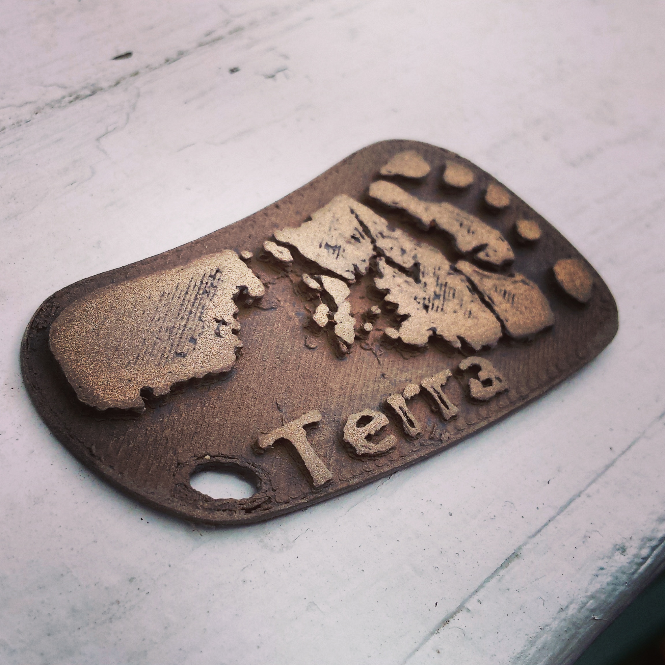

There’s this awesome option to create memorable keepsake of child foot. @Alexander_8 came up with this great idea and placed it on instructables you can check it HERE. But it does not have to be only keychain or magnet. It can be like 3D picture on the wall with a frame.
So you can try and do something following tutorial, or contact AtomJaay to help you out if you like, or you can drop by my HUB and we can talk some more. I can make you lovely keepsake wall 3D picture of baby’s foot printed and polished in bronzefill or copperfill.

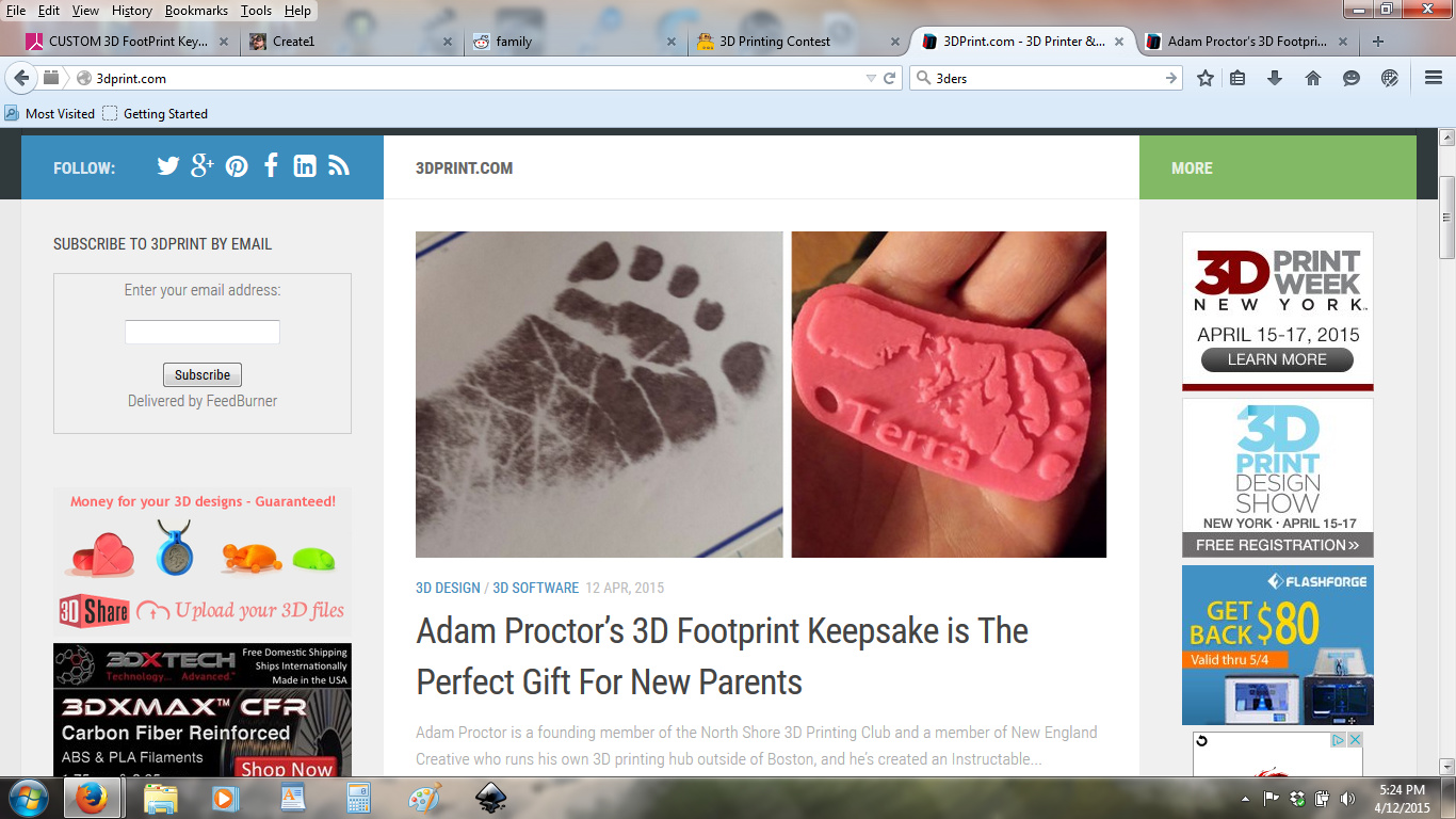

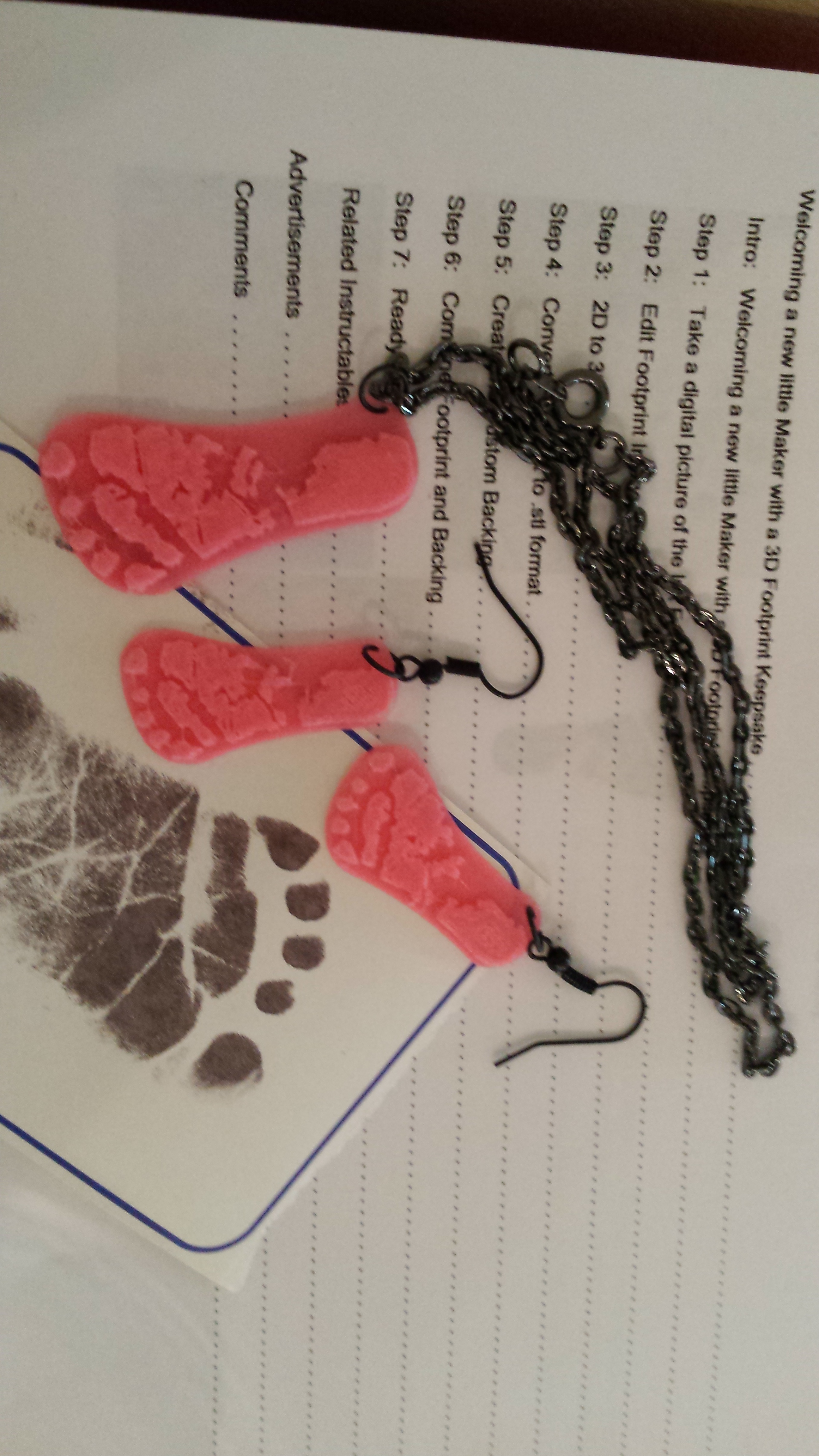

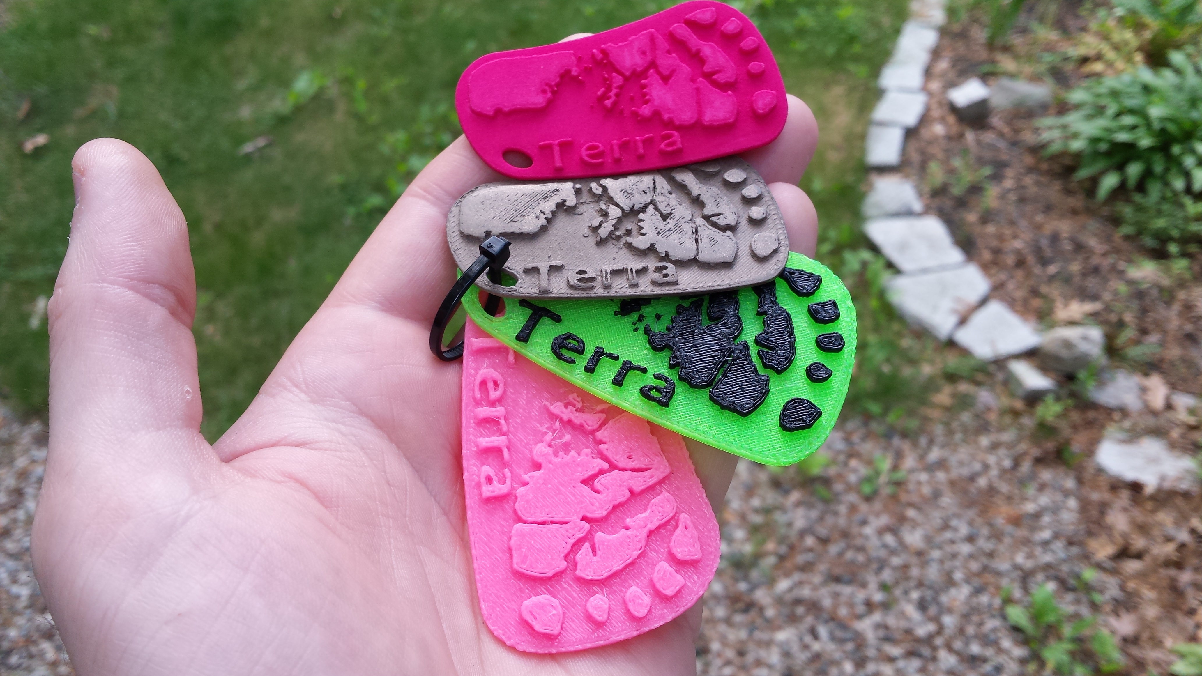

I can absolutely help. http://www.instructables.com/id/Welcoming-a-new-little-Maker-with-a-3D-Footprint-K/
I made this when my daughter was born and I’ve been trying to start a dedicated service based on the process.
The files of the backing can be found here https://www.myminifactory.com/object/backing-for-3d-baby-footprint-keepsake-instructables-included-6497

What software did you use and is it possible to have the depth to adjust to the intensity of the color? Now you just got the base layer and extrusion to a specific height, nothing in-between

The online shapeways tool I used in the instructable has an option for height based on contrast intensities.
