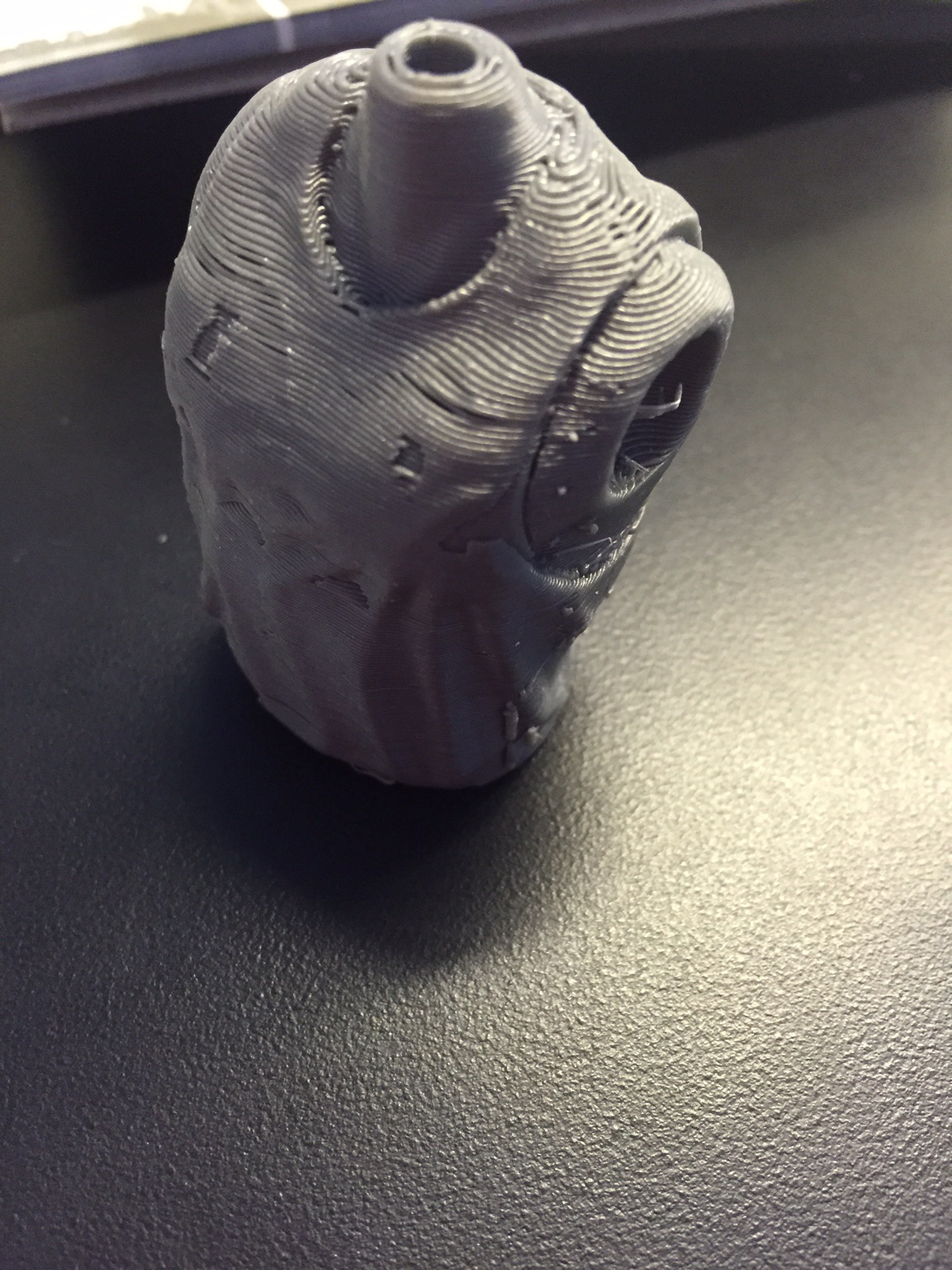

Hi Everyone,
My name is matt, I’m from Cleveland, Ohio, and I recently purchased a FlashForge Creator Pro 3D printer.
I completed my first print last night, and I’m wondering if you can assist me with tweaks necessary to achieve better results. I’ve attached some pictures. One, the gray one, is the model I printed with the FlashForge Creator Pro. The other, the white one, is a print I had done at my library with a Makerbot Replicator 2. As you can see, they’re noticeably different in terms of quality.
I’ve read online posts in which details of tweaked settings and such were explained, in order to achieve optimal results. Basically, my problems with the FlashForge print are as follows:
1) There are parts of the model that simply didn’t print - they look as though they were “eaten away” from the final product. I’ve tried to take close ups of said areas for reference. In addition, there are parts of the figure that seem to have accumulated excess bits of filament. Again, I’ve shown photos for reference. How to I keep this from happening, to create a smoother result?
2) I’m unhappy with the banding, compared to the MakerBot print - what I mean by that is that the “lines” of printed filament are very, very obvious in the FlashForge print. On the MakerBot print, they seem to be more smoothed out and compacted. They’re still somewhat visible but certainly not to the degree of the print from the FlashForge.
Help! Haha.
I’d love to know how I can remedy these problems. I really want to stick with the FlashForge Creator Pro - I’ve heard great things about it and, up until the actual print, I was very happy with it. Any advice you can share would be greatly appreciated.
Thank you!
matt

Hey Matt,
your biggest problem, the “banding” is simply a matter of increasing the resolution, aka. layer height. Your flashforge print looks to be on the order of 0.3, while the makerbot print is probably 0.2 or slightly less. You should EASILY be able to change this in your slicer.
The parts that “simply didn’t print” can be a result specific to the slicer you are using. It is a little hard to tell ffrom the pictures, which features you exactly mean, but I myself had embossed text disappear between one and another slicer. I don’t know what flashforge recommends for their printers, but you could try Cura for comparison, it’s free.
For a cleaner, stringy-free print, try lowering the print temperature slightly (in 5°C increments). Additionally you can increase the retraction distance by a bit (I’d suggest 0.5mm increments). If you go too far with the retraction you risk a hard to clean hotend clog, so be careful.

Matt,
Printing over USB might make a difference, but I bet it is your slicer and slicer settings. Try printing from the SD card to make sure it is not a USB data transfer rate problem.

Install latest Sailfish firmware, use Makerbot slicer or even better Simplify 3D plus check all belts to be tight and all pulleys to be firmly screwed.
Don’t expect wonders but you should be able to reach the same results as the white print.
Your layer height is too thick causing adhesion and resolution issues. For best results don’t print thicker than 50% of the nozzle diameter.

The thing that I have found makes the most difference is your speed. My default settings in Replicator G were way too fast. On difficult prints, like spheres, I’ll slow it down to 24mm/sec and a travel speed of 30mm/sec. Simpler shapes can go faster, but I rarely go any faster 48 & 60 mm/sec
You should never print with a layer height that is more than 80% of the nozzle width, otherwise your interlayer bonding will be seriously compromised. The largest practicle layer height for a FFCP with the stock 0.4mm nozzle is 0.3mm.
If you try to print with say 0.4mm layer height, you will have virtualy no contact between the two layers, its like two 0.4mm cylinders laying ontop of each other, there is only a very thin strip of contact where the circumference of the plastic that makes up the layer touches each other, printing at say 0.3mm means that each layer is pushed 0.1mm into the layer below it, which flattens the bottom of that cylinder, and significantly increases bonding. If you tried to print at say 0.5mm with a 0.4mm nozzle the layers would theoreticaly not be touching each other and the print would fall apart.
