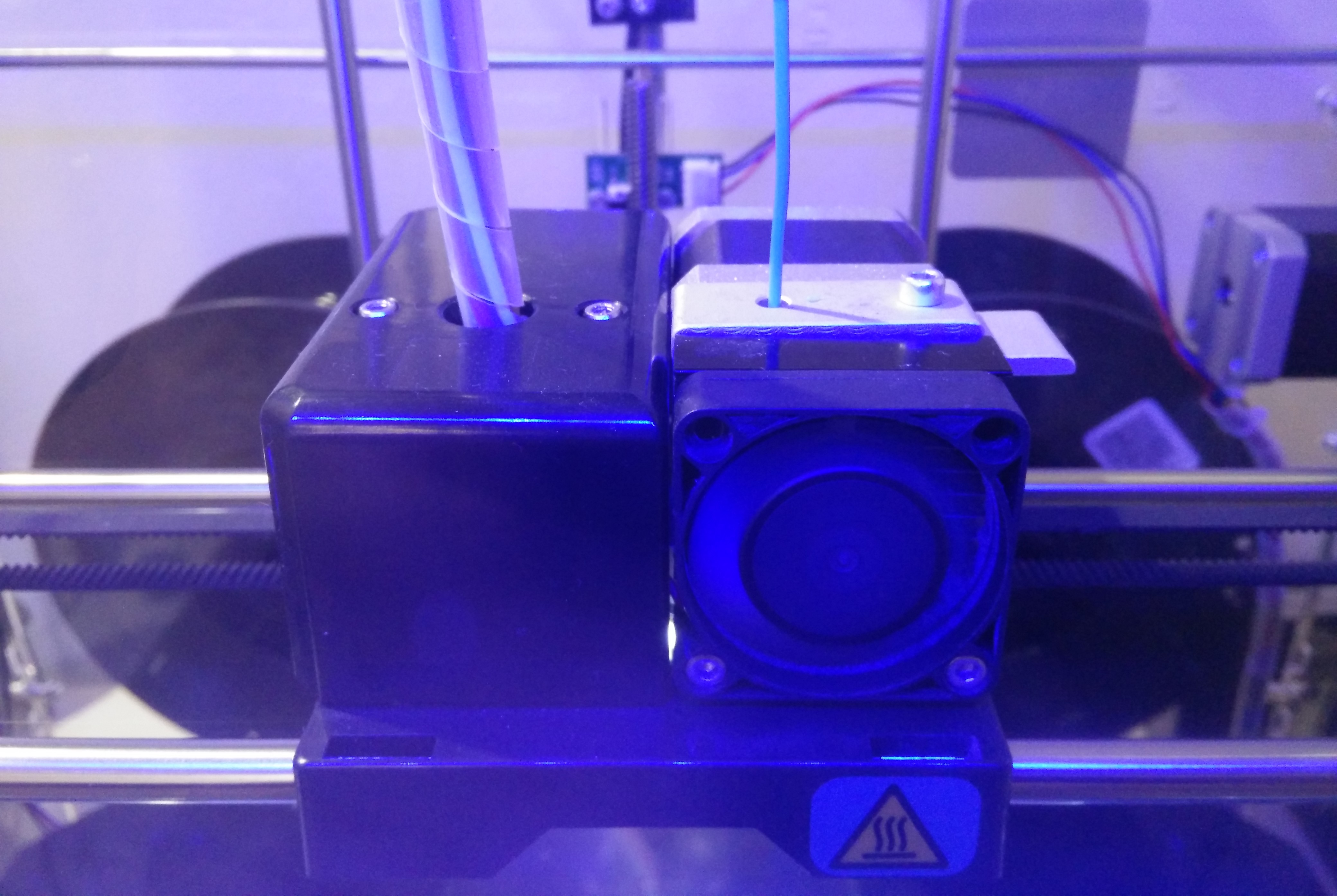

No I don’t have a bowden extruder I have a direct extruder with no chance to put a ptfe tube
this is my extruder body
this is my extruder

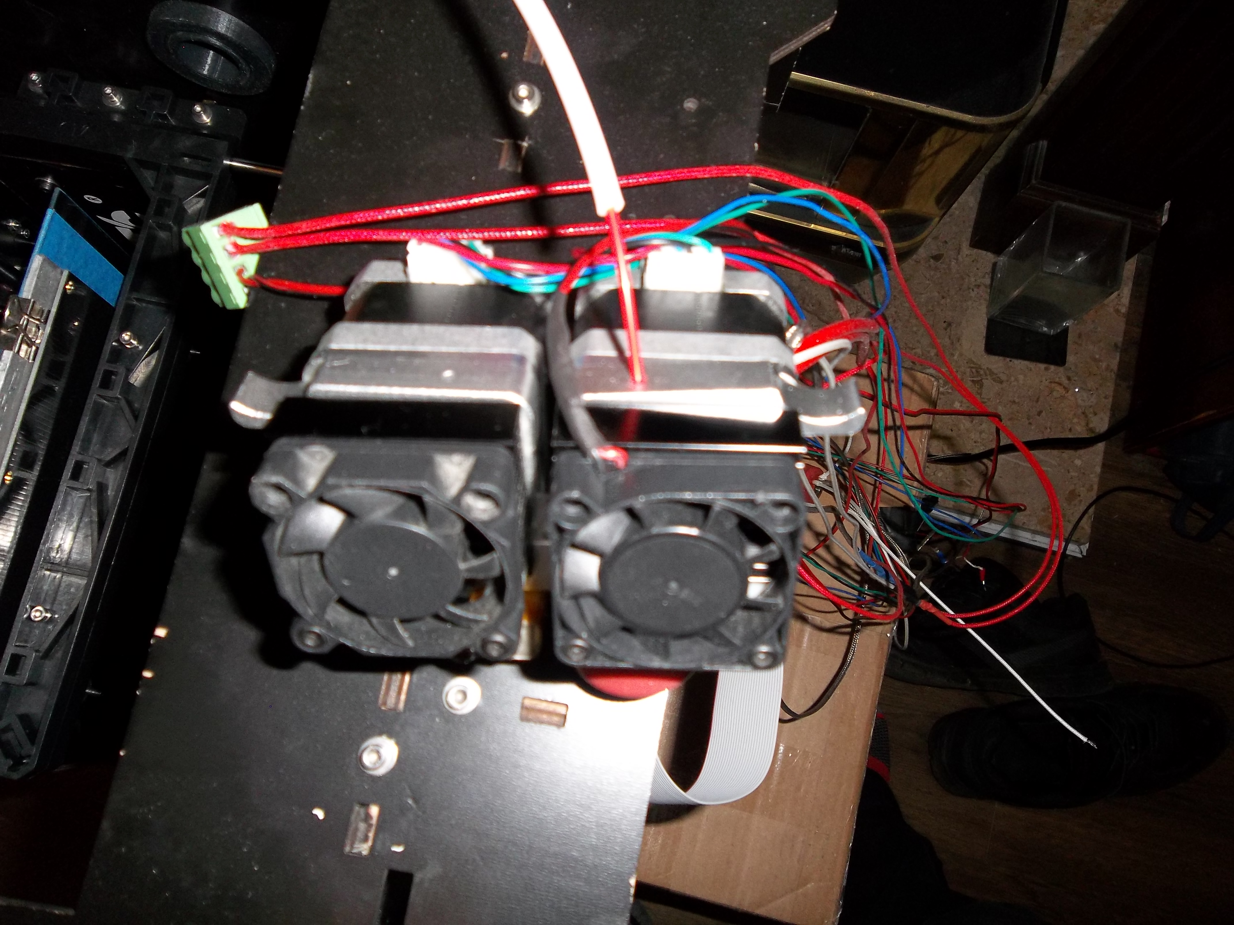

and you use a ptfe tube?
yeah i was getting prints you was but now better give it a go for £2.50
bort this as well

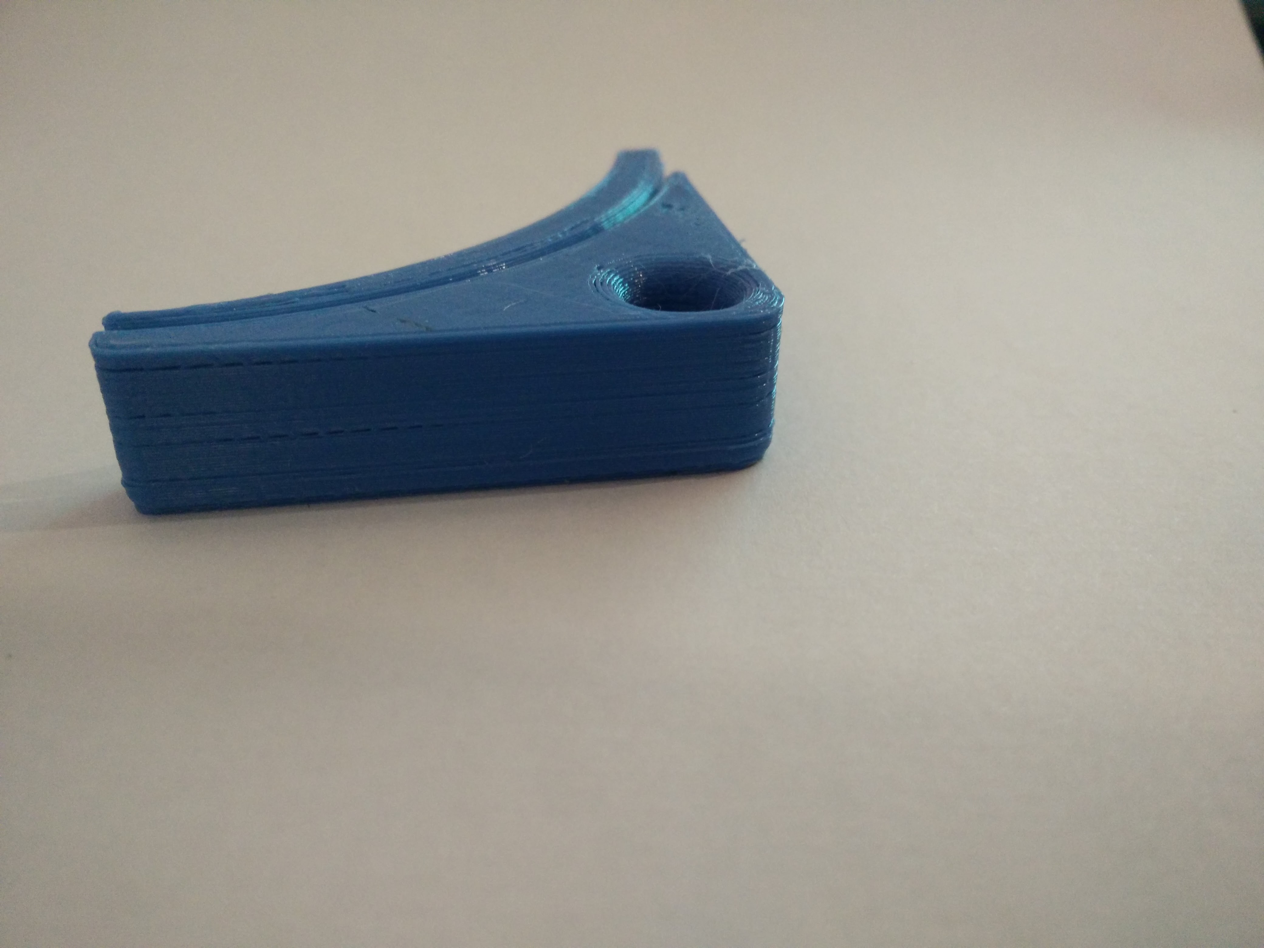

3. The holes in the bottom of the piece on the second picture is due to layer adhesion isssue on your first layer.

Both cubes you see, have the top side facing the camera. The other side is perfect (no little holes there).
