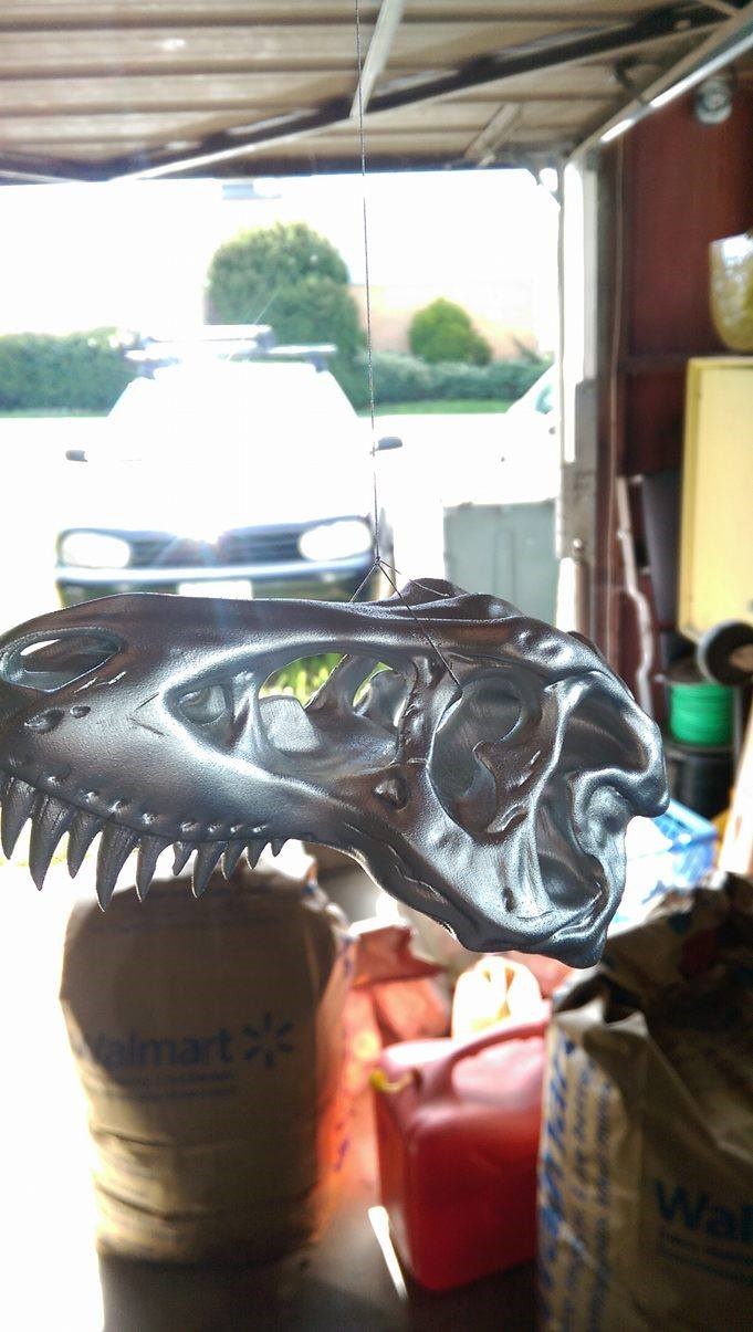

Hey Bud,
Here is a few pictures my room mate just took. The model is pretty much ready for paint now, which I’m going to try and do over the course of the next few days. I’m an amateur when it comes to painting, so I’m going to try and take my time. Hopefully these photos are what you were wanting. We have more from other angles, but I just picked the ones showing the lower jaw.
Cheers!
Tim

Hello Tim, sorry to reply you late. Thanks so much for your sharings. These pictures look awesome. Could you please tell me which settings you use? Thanks in advance:) Have a good day!
We just printed it really slow, I think at 20 mm/s, with a slow travel speed as well to be safe. Also lowered the temperature of the hot end, but that’s more a filament/machine combination specific kind of thing.

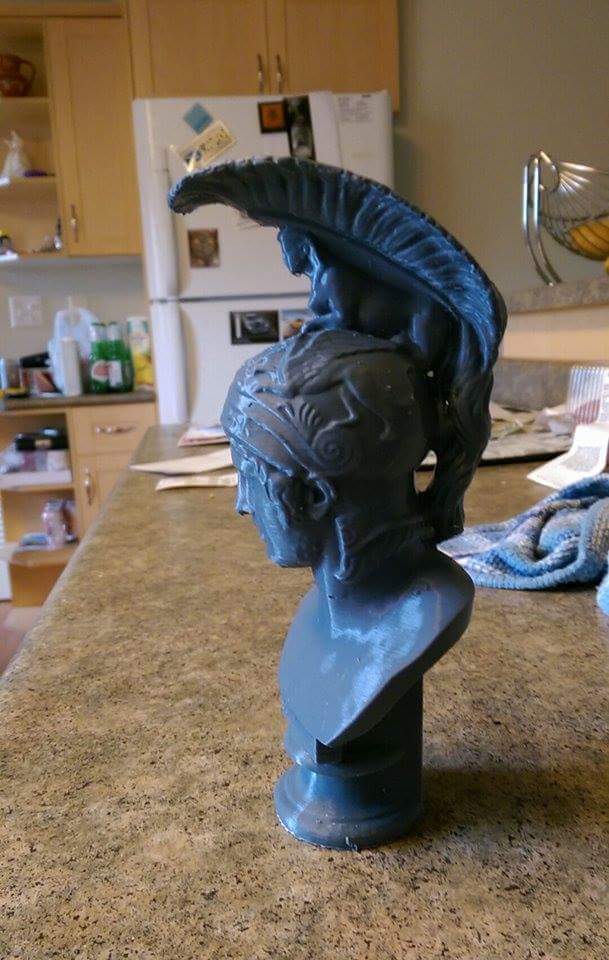

No problem, sorry I couldn’t remember all of the settings for the T-Rex print, but here is two quick pics of a print that just completed. Please keep in mind this is fresh off the printer, and literally nothing has been done other than removing the supports (not very well at that).
The settings were,
print speed 20 mm/s
travel speed 100 mm/s
density 20%
0.8mm shells
0.8mm top/bottom
100 Microns
ColorFabb Grey-Blue
Temp @ 200 (ColorFabb seems to need hotter temps, at least from my experience)
Full supports, otherwise it would have been impossible (at least for my printer).
On that note, I’m never using Cura again for supports. Virtually all of the supports failed, but I let it keep printing because I was convinced as long as the supports on the helmet worked the print should work out after a bit of sanding. Thankfully, those supports did work, and the print finished. Granted, a fair bit more finishing work is required, but all in all it turned out pretty nice.
I’ll send a pic when it’s sanded and painted :wink:
