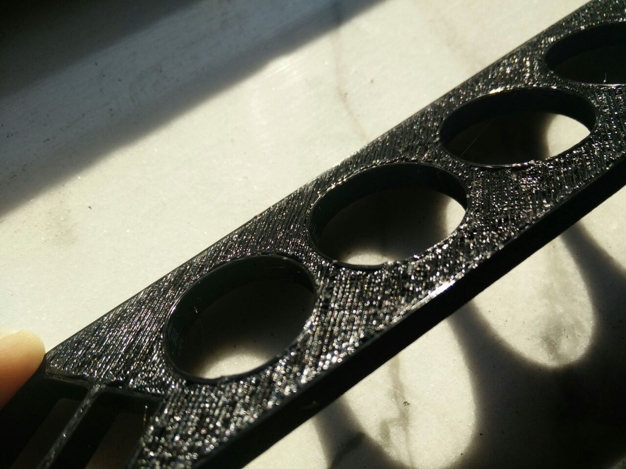

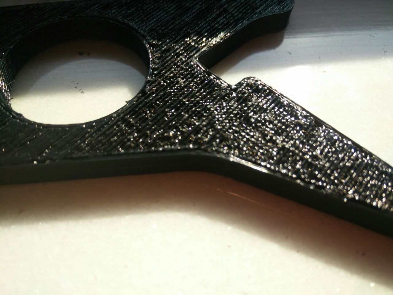

The problem you are having is that the top faces are not closing. I have this set to 8 layers on the top and bottom and that has been working. You may be able to cut down on layers if you have a cooling fan that you can blow directly on the print. You may also want to try increasing infill to support the top layer.

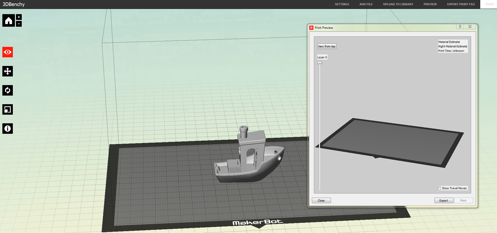

If you have any problems with this file please let me know and I will help you out. To load this file you first need to add the FlashForge Creator Pro Dual printer using the add printer menu. Then click Settings & Controls, then click Options then import. This should change all your settings to match the file. Also, you will want to change your settings from Basic to Advanced to change some of the things I talked about previously.
