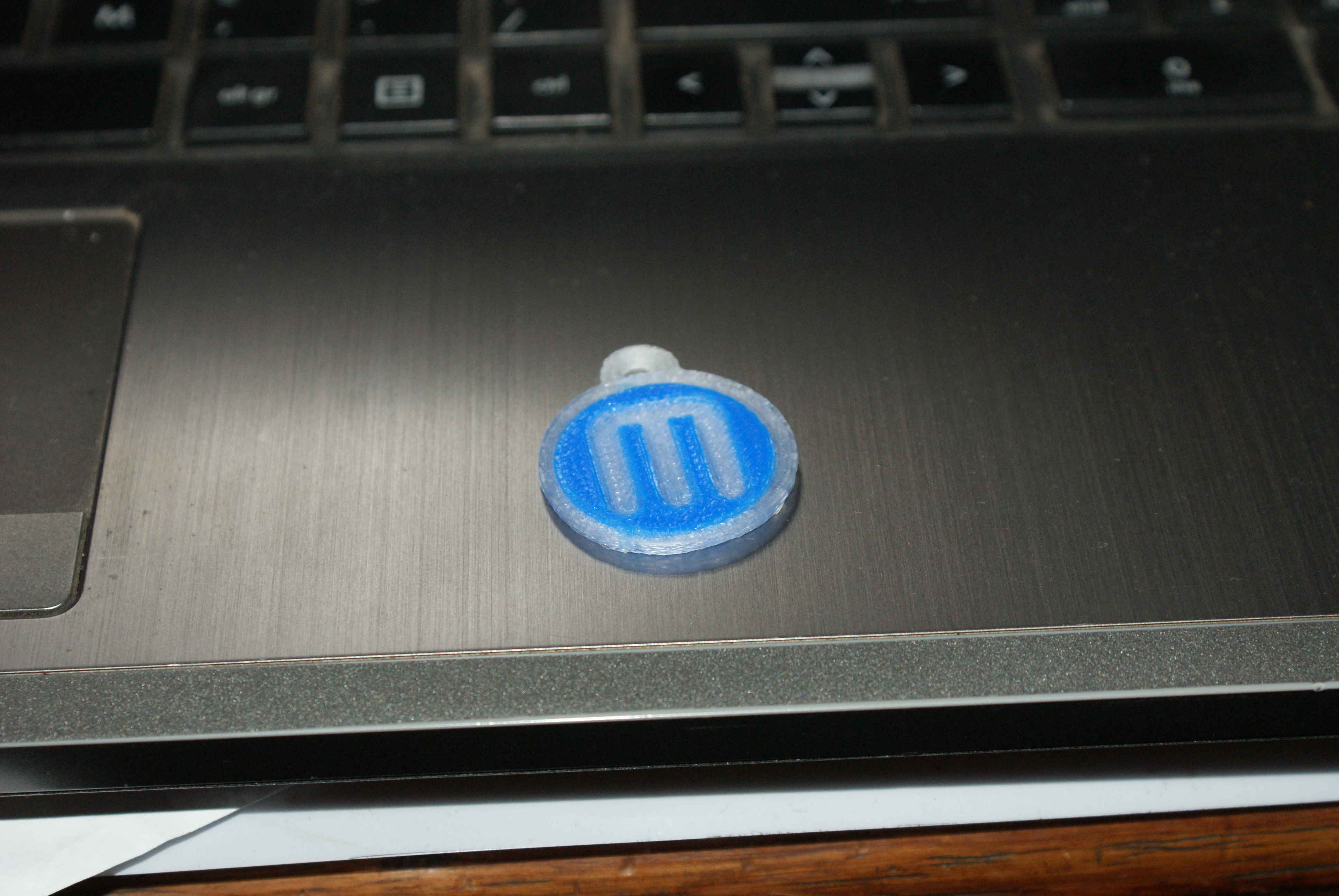

Hey! Thanks! The problem was with the Makerbot software. Apparently there was a glitch…
Thanks anyway!

**Update 2**
Nope. It’s definitely 0 and 1 to assign the extruders, but the software is ignoring 0 when I use it.
