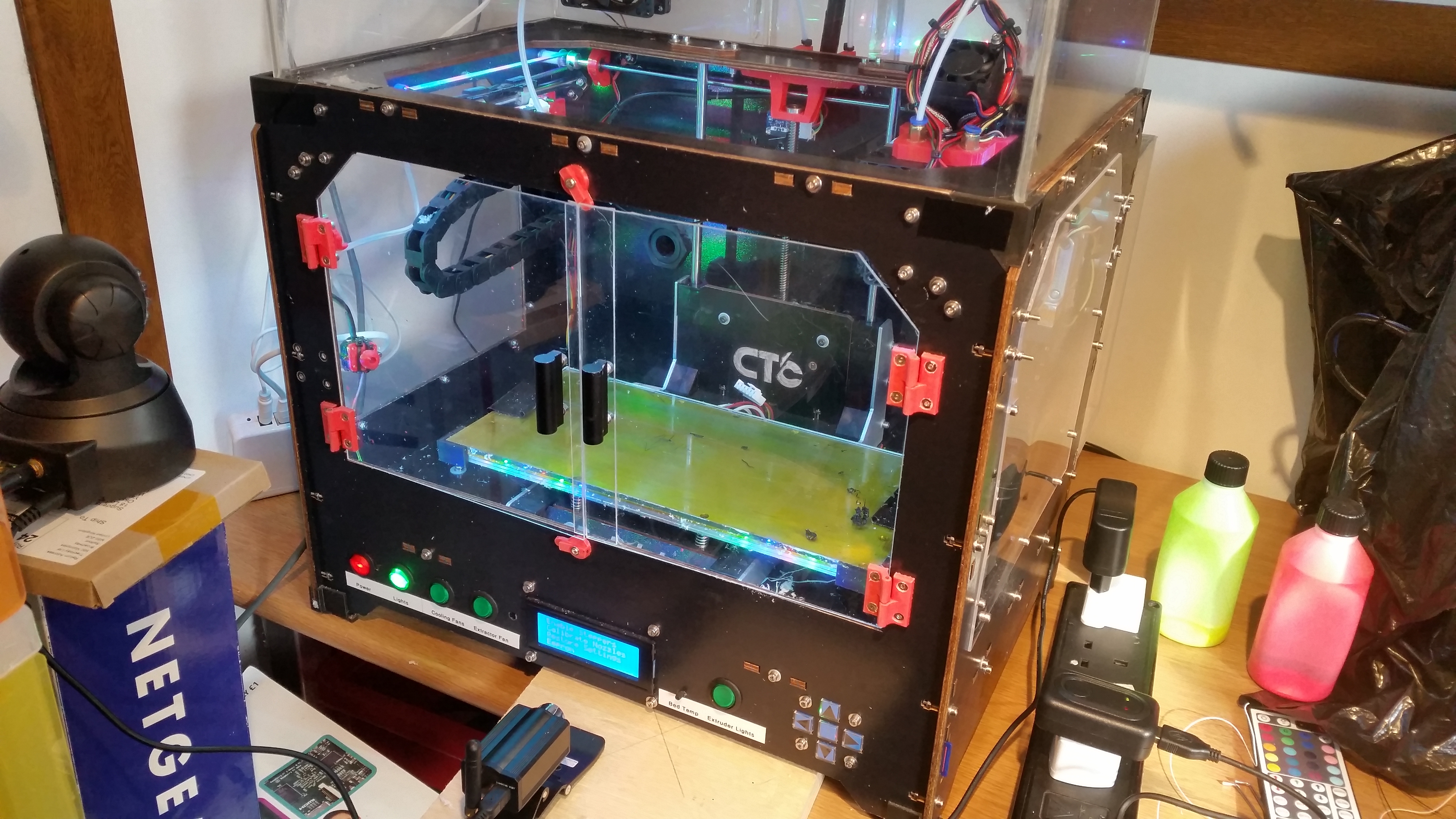

The aluminium arms on the side of the plastic support arm are home made too but you can get them of the bay aswell
http://www.ebay.co.uk/itm/381360135076?_trksid=p2060353.m1438.l2649&ssPageName=STRK%3AMEBIDX%3AIT 13
I also added max end stops to all axis. Added extra moffit for the PLA cooling fan. LED lights run on a separate power supply (12v) as are the cooling fans I fitted to the X and Y axis. Extractor fan fitted to\the hood also runs on the 12v supply.
Igus polimar bearings all round aswell.
I did have LED lights around the print heads but they failed due to the heat and aint got round to sorting them.
Will be doing this very soon as I have just had a jam so it due some TLC

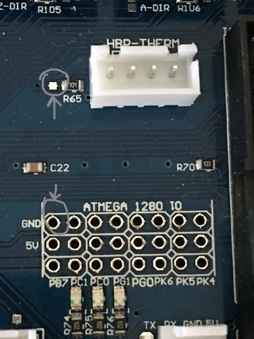

Can you measure the voltage at TP27 when the HBP is at room temperature? that’s a tiny copper spot just next to R65, which is next to where the HBP plugs in to mightboard. Put the other end of your meter on one of the ground pads on the ATMEGA 1280 IO just below that.

Thank you for youre instructions here are the results. Now to make sure im telling you the right information Ive included photos as Im not an electronic`s wiz as you know by now!!!
I have access to a meter but, only use it for continuity testing so that said details are as follows:
Room temp:- 77.5F
Meter set at 20v DC. Reading taken at points TP27 as you`re photo to ground on ATMEGA 1280 this gives a reading of: 0.47-0.49v.
Also took picture of board showing three small red LEDs light dont know if this is relevant but, to much information may be better than none. Hope this helps.
and the screen said that was around 200 degrees i expect? That suggests your mightyboard is fine, and the problem is elsewhere.
