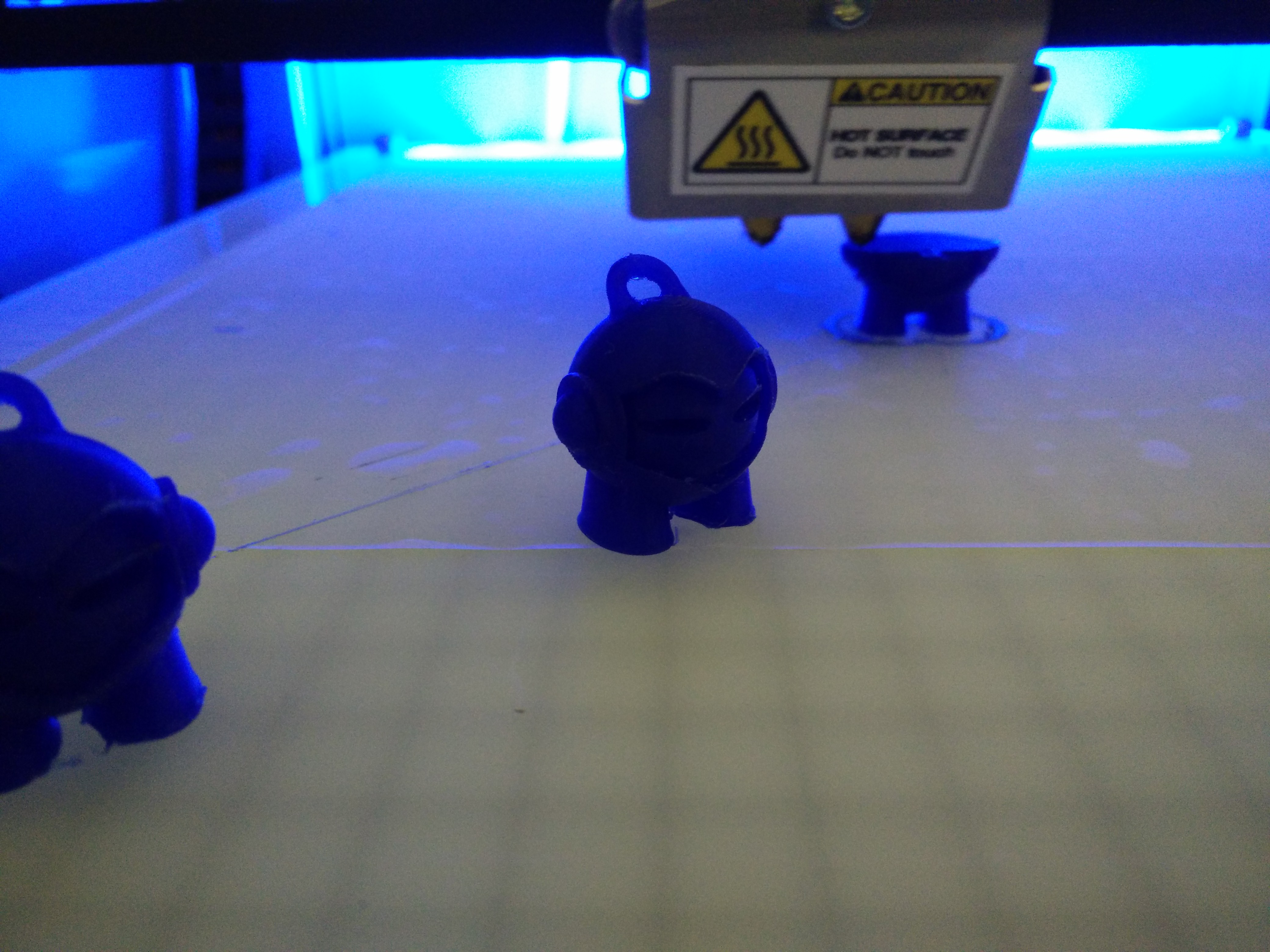

Great insights guys!
We’ve printed a good looking Marvin Using
Temperature : 205
Fan speed : 50%
BedTemp: 20
And everything else on default. The default temp for PLA was set to 185 degrees, which obviously wasn’t working at all. So not a lot of tweaking was necessary :slight_smile: There’s still something wrong with the left extruder… Hope to fix it soon to start combining materials!

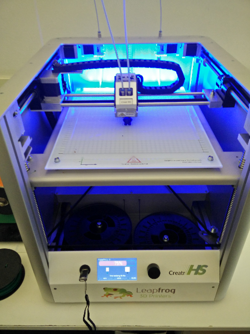

I, after having the printer for a week , am getting more positive about it for sure. We’re getting used to the software and the Printer slowly. The Simplify 3D softwware is really helpful for sure!
However, I do have an issue with the LCD panel- I dislike using it. I feel it’s much to responsive and not user-friendly :frowning:
