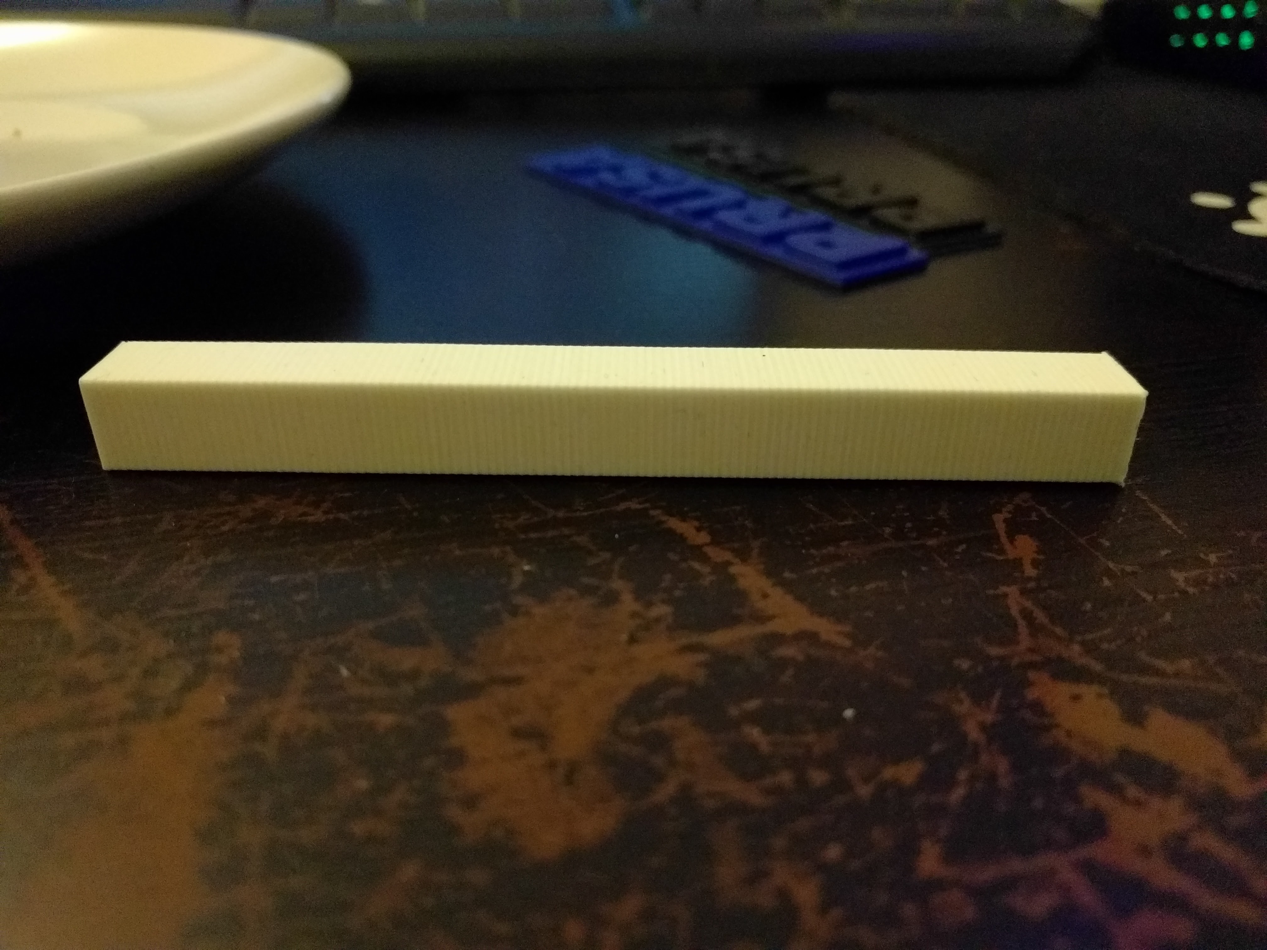

I am having a couple of problems with my Prusa i3 MK2. It appears that most prints have some weird lines. I printed the rectangle at 200 microns, about 15mm/s or less with PLA and 100% fan speed, hot end at 190C. Marvin had the same problem but it has been printed with the file from the included SD card (marvin printed at 100 microns).

Did You assemble it or You got assembled?
It looks a bit over extruded, maybe try print at a lower extrusion Multiplier? And calibrate the extruder following toms guide for example: 3D printing guides - Calibrating your extruder - YouTube

From what I can see, I think possibly the z-axis is slightly tilted because the first layer on the left and right feet of Marvin seems different.
Maybe you should also check the belt tension on the x and y-axis.
I got it preassembled. I have rechecked the belts and calibrated the extrusion multiplier. But still the same problems. I have checked the z axis lead screws, it does look like they are bent. Here are the pictures
Thats normal! They are not 100% centered in that hole and are meant to be able to move around some.
Try print the Marwin GCode again, but reduce flow to 95 on the LCD and see how that looks.

I suspect your problem is related to your build as there are layer shifts. Check that everything is tight including your belts and the x rod tensioners.

You do have some surface imperfections that may elude to a mild extrusion issue but the odd lines on the prints are from Z-banding/Z-wobble… Since the long rectangle has the most surface area hold it against your Z screws… You will notice that the lines are exactly the same space as your threads on your Z rods. There are a lot of documents and posts out there covering these issues with some possible fixes… Not all things are fixable the same way and part of it could be resolution vs setup related meaning your layer resolution is even recognized by the printer and falls into your machines particular microstepping capability. I apologize for not having more answers but Search google for those terms and it will show you a ton of results for possible fixes

The next thing I would try in that situation is I would move the Z axis up and down repeatedly (using the control panel) and watch carefully for any kind of wobble anywhere. The movement should be very smooth. I would ensure all belts are tight (plucking them should sound a note in the bass range) and I would verify the heater block is not wobbling inside the extruder.
