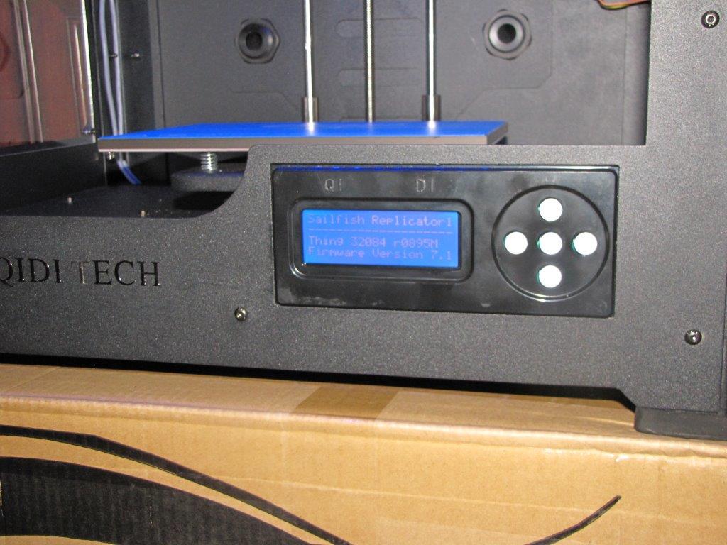

It can be a very frustrating process, but I finally managed to get it upgraded to Sailfish 7.1. Everything later than 7.1 is still giving me trouble, although I would love to try the newer versions! Perhaps we can work together and get it beat. But regardless, the older Sailfish is still way better than the stock firmware.
I started with this tutorial, and even had a couple of my questions answered by Jared himself that helped steer me in the right direction. BTW, the CTC is an pretty much identical to the QIDI but with a wooden frame.
What finally worked for me, was to use ReplicatorG pointing to the Jetty firmware URL, using the machine type Replicator 2X, the board type of Makerbot Replicator 1 Single & Dual, and the firmware Sailfish 7.1 (r895). When you try uploading it, make sure to press the Upload button in RepG at the exact same time that you press the reset button on the QIDI. Also, I removed the white cable to the build platform, since loading the wrong firmware causes the bed heater to turn on and ramp up the temperature as high as possible.
Let me know how you get on with 7.1, and I’ll try and answer any specific questions you have while doing it. After that, we can try and get the higher versions to work. I attached a couple of images showing the firmware version, as well as my custom machine name in the main menu.

Using Makerbot Desktop, I was able to step through their firmware from 7.2, 7.3, 7.4, 7.5 in order. But I still can’t get it to accept Sailfish 7.5. Are you absolutely sure you have Sailfish 7.5 and not just the Makerbot 7.5? If you go into the version info on your LCD screen, does it say Replicator or Sailfish?
Adam
Ah! I’m sorry, you might be right. It just says firmware 7.5 does not say sailfish
That’s too bad, but at least it means I’m not going crazy!
I’m not sure of the differences between the proper Sailfish 7.1 and the Makerbot 7.5 (or which one is better), but there has to be a way to get the later Sailfish versions on this bot. I’m not giving up on it…
