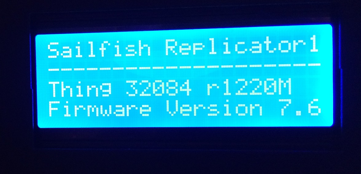

Here is a quick write up on how I reprogrammed the fuse bits on the Atmega1280 of the QiDi controller board. I will post more info as time permits. SF 7.6 seems to be working OK. I can use my 4Gb SD card again. I did do some printing and things worked as expected. Works very much like the FlashForge Creator Pro, including the same PITA things.

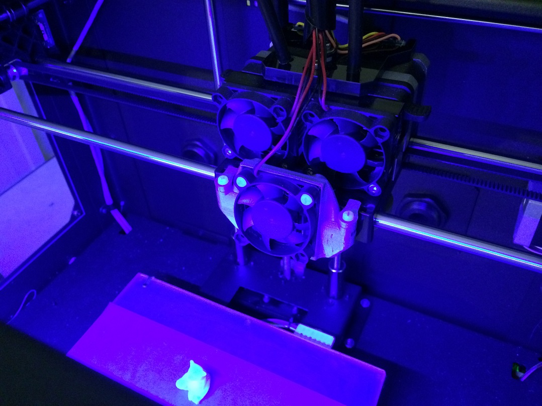

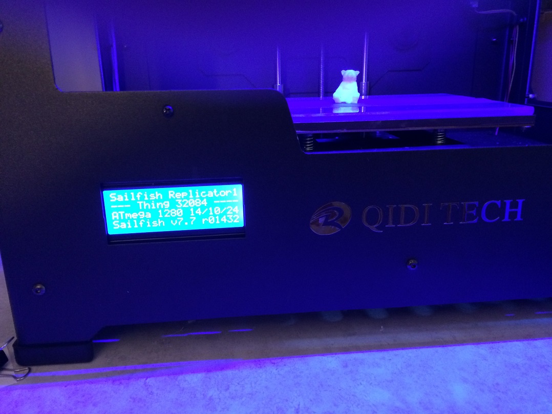

I bumped up to SF 7.7. SF 7.6 was working fine but thought I would test this out next. I was able to get an external PLA cooling fan working OK also (commands M126/M127) with SailFish. (24V/44mm Fan + Thingiverse
Active Cooling Fan Duct v2 for Replicator 1 / Duplicator 4 / FlashForge / CTC by thruit00 - Thingiverse 3). Just soldered the leads to the “Extra” connector on the controller board. Turns on and off under software control. Have a different fan on the way, blower style, to see if the PLA cooling works out better.

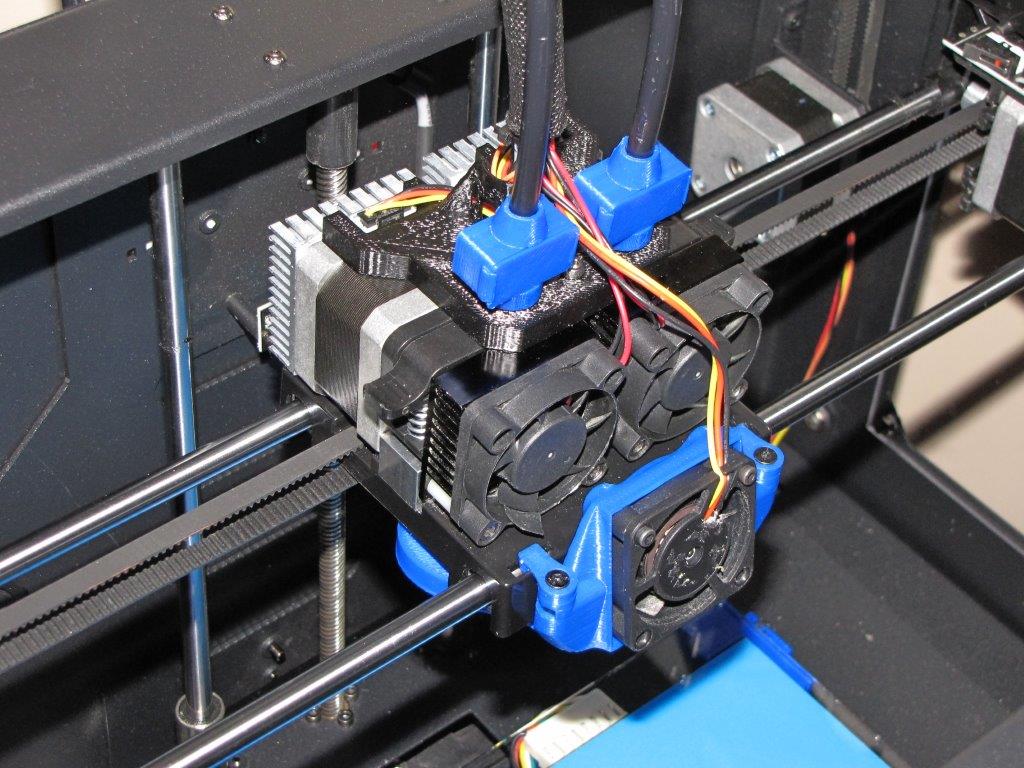

For mods, I also have an active cooling fan (same one as yours), a new filament tube holder above the extruder steppers, dual filament duster/oilers, heatsinks on extruder stepper motors, filament guide on rear of machine, glass bed with corner clips, bed adjustment thumbwheels, rounded bridge top for the upper enclosure, and reversed the power toggle switch (to make it easier to reach from the left side of the printer).
Out of interest, have you tried a dual extrusion with it? It took me a while to get the toolhead offsets to something I’m happy with (-1.19 X and 0.096 Y), but it seems like it could still be a tiny bit better. Looking for someone to share their experience with this and let me know if I’m on track with it.

Awesome looking set up. I did print the filament guide also, a truly wonderful thing. I have done a few dual prints but just some dual color figurines and the like. I see that #3DBenchy has a dual color torture test, which I think I will try. I will let you know if I get any results from that. Benchy is a minor obsession.
The cone looks pretty dead on, maybe just a tiny bit of shifting on the top two layers (or that could just be the photo). I have taken to clamping my glass bed (made some little stainless steel clips from old windshield wiper blades) because occasionally it would slip and produce funky print results. I would love to dampen the frame a little bit to reduce the hard jerking of the print head.

My first couple of tries under SF7.7 were a disaster with the print cartridge trying to drive itself out the left side of the printer. Turns out my extruder X offset had defaulted to 399mm!!!
WARNING! IF YOU UPGRADE TO SF 7.7 DO THE NEXT TWO STEPS…
I found this page:
http://www.sailfishfirmware.com/doc/troubleshooting-common-issues.html 1
I set both X and Y offsets to ZERO (0.0mm) at the front panel using the submenu:
http://www.sailfishfirmware.com/doc/ui-utilities-menu.html#x17-470003.7.11
Dual prints are no longer trying to take the printer apart. The prints are pretty close but about a mm off between layers it looks like.
