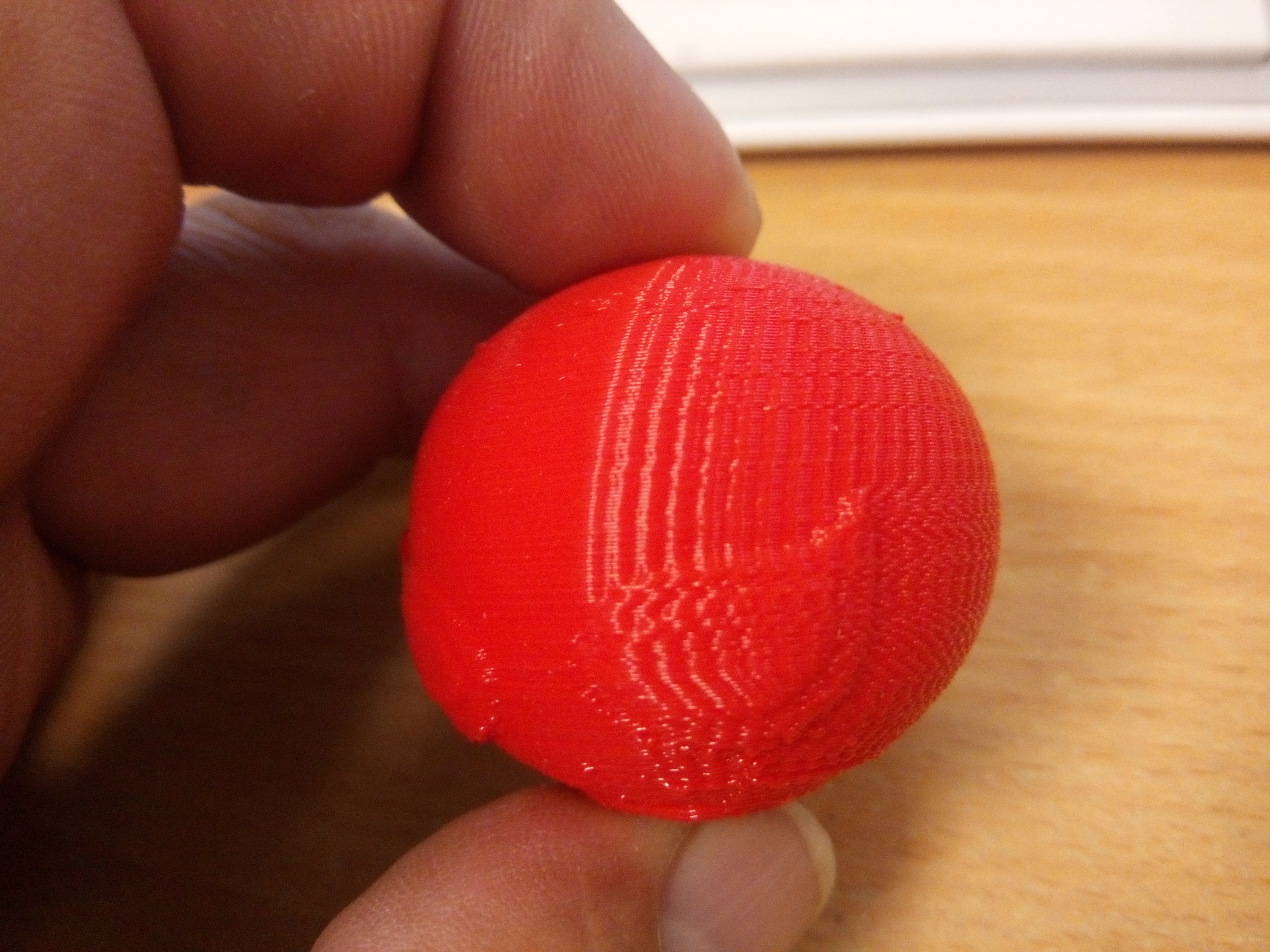

I have been printing with my printer now for about 5 months and I have been getting some nice prints, I did have a bad wire problem on the hot end fan and repaired that, however lately I have been getting a lot of vibration from the y axis. I have over 1000 hours on the unit now and the problem has just cropped up and seems to get worse with each print. I have disconnected the belt and checked the belt is good the bed slides freely so I believe the bearings are good. I checked the wiring and all connections seem to be fine so now I am stumped. The X axis motor is almost silent when it moves but the Y axis is very loud.

Did you managed to find what the issue was? I have been experiencing a similar issue with some of my prints lately, but not everyone. Im getting a lot of vibration on my Y axis movement, especially moving from the back to the front. This is only during a print. During normal Y axis movement commands, the beds moves freely with no vibrations at all.
And this does not happen with every print.
i went through all my bolts and everything seems to be connected. Then I thought it might be a slicing issue so I tried the same print from Repetier and used Slic3r, there was no vibrations … happy days … till 2 jobs later, now its happening again…
