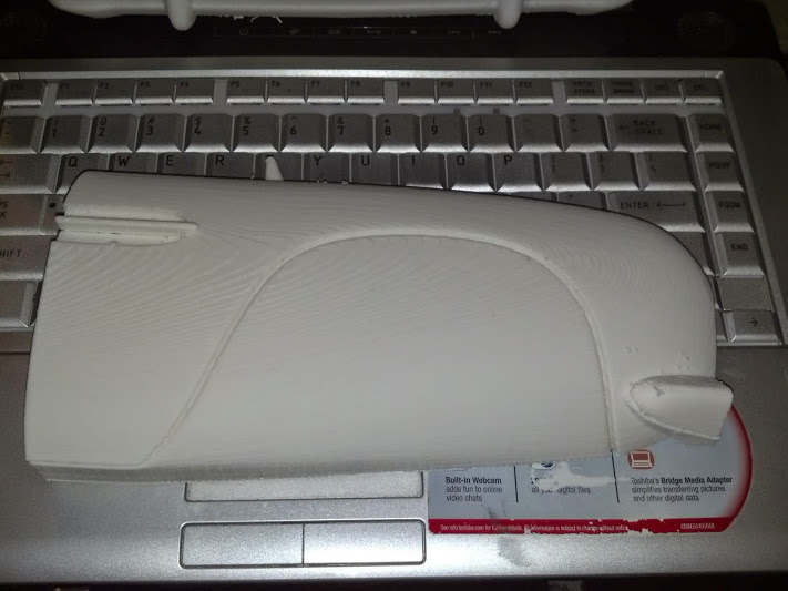

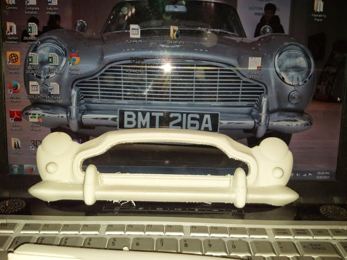

So my question is IF we all are getting clogs with 0.5 mm nozzles, wouldn’t it make sense to make a 0.75 mm nozzle or even a 1 mm diameter nozzle for really large parts? Attached are some successful parts (Aston Martin Model parts)…

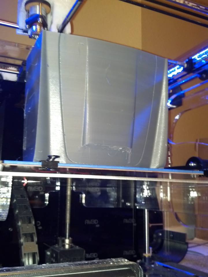

I also switched to silver PLA, and printed a car model hood which was 10 inches tall and 11.6 inches wide. It took 60 hours to print probably because of the 3 layers instead of two but successfully, which is a personal record. HDX is working great now.
