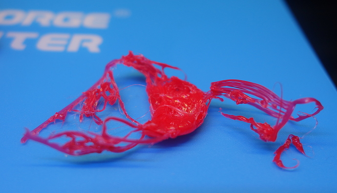

I’ve just gotten started with a Flashforge Creator Pro and gloriously failed on my first PLA test models.
First, I couldn’t get PLA to stick to the blue bed causing an ugly pile up.
I’m now overriding the baseplate temperature setting using the Flashforge preferences. Next, testing with 60°C because that’s the Ultimaker2 glass plate default and PLA filament sticks well there.
Still, the 1st layer is a little shaky. It does stick in most places but often has irregularities and later on during the print the whole base warps upwards (see bottom right below).
I’ve read here on 3DHubs that some of you pros print with the bed at room temperature but I was under the impression that a heated bed increases adhesion, doesn’t it?
What else can I do to finally print properly on my Flashforge? Spray? Glue stick? Lower bed temperature? Switch to glass (where did you buy your glass plates)?
My Ultimaker2 has great adhesion without any additional adhesives. Is that the glass plate instead of the blue custom material of the Flashforge?

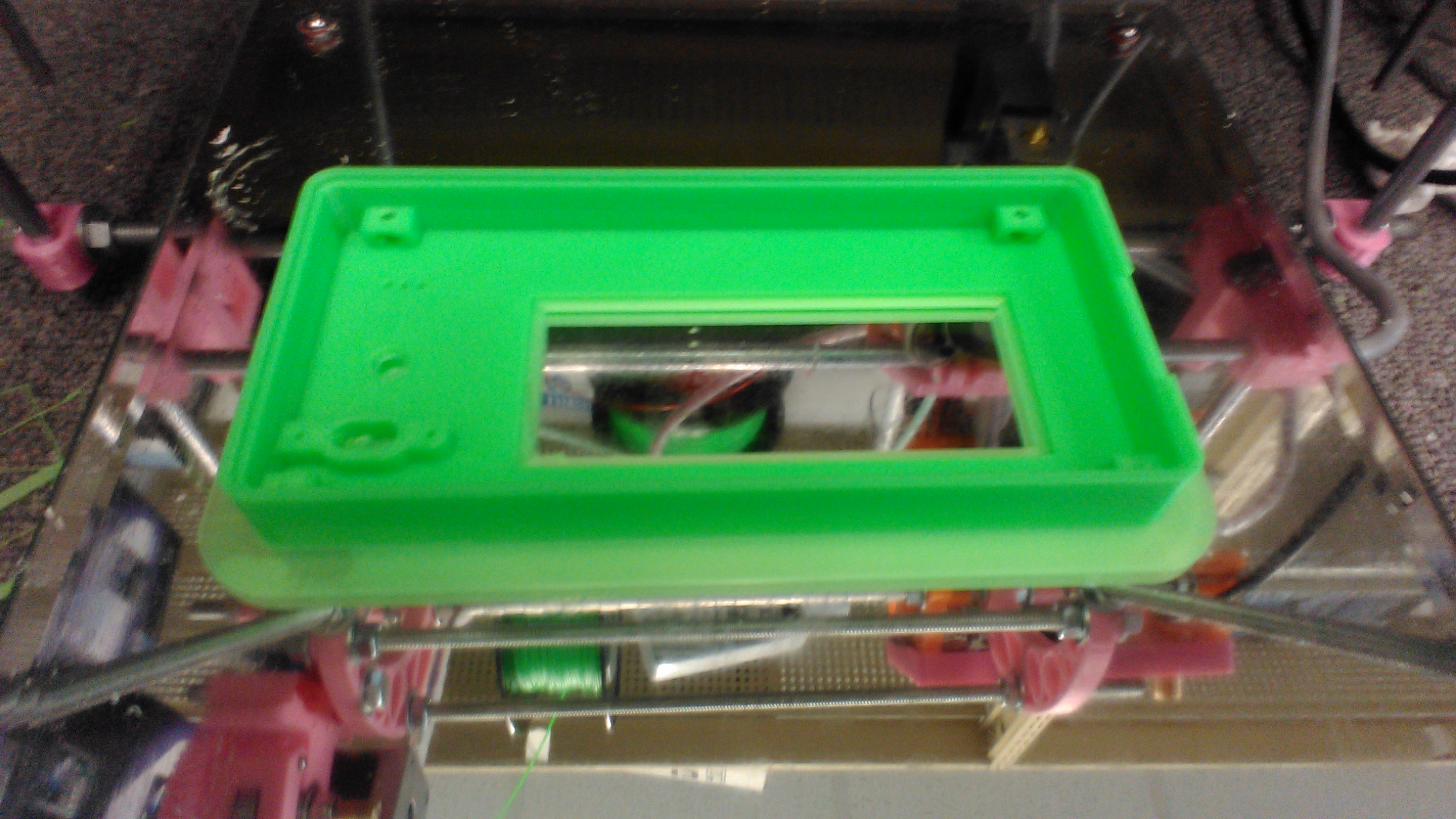

I have a FFPro. I use a mirror (5 bucks cut at local glass cutting shop). You don’t need expensive borosilicate glass. I also use hairspray: http://www.walmart.ca/en/ip/garnier-fructis-style-utral-strong-hold-flex-ultimate-control-spray-natural-bamboo-extract/6000062243949 10 . I use the same setup for ABS and PLA have had no issues with lifting or warp with my FFPro out of box.

The only times I had issues with PLA not sticking to the blue plate (which is made of PET I think) was when 1. it was totally worn out, after I did TONS of ABS prints. Removing those prints over and over again wore down the structure of the blue material and finally it was smooth and shiny instead of its regular dull look.
2. make sure you level your build plate before every print! You can absolutely have adhesion issues if your build plate is not level.
See if makerware has a way to decrease the thickness of the first print layer - say to 80% - that will also help with adhesion. And then of course make sure your layer thickness is less than 0.27 mm if you go over 0.27 mm you have to increase the extrusion multiplier.
Upon my print plate on an Ormerod 2 ; I apply a thin layer of PVA glue on a glass plate (similar to the liquid paint that you used in art) when the bed is cold, heat up the bed to 60 degrees C allow the glue to dry and become clear.
At the end of print allow the bed to cool down and off pops the print.
Another reason for not getting the first layer down is incorrect z-height and the print bed not being level.
Correct/good Z height is when you have a slight grab on a piece of trapped paper.
Use skirt around the print to prime the nozzle and see if it’s going to stick, if not stop the print.
With that print surface on your flash-forge it’s most likely that the z-height is too high at the start of the print;
So I would home Z with a bit of paper between nozzle and print bed and hopefully get a slight grab, if not lower the z-height.
