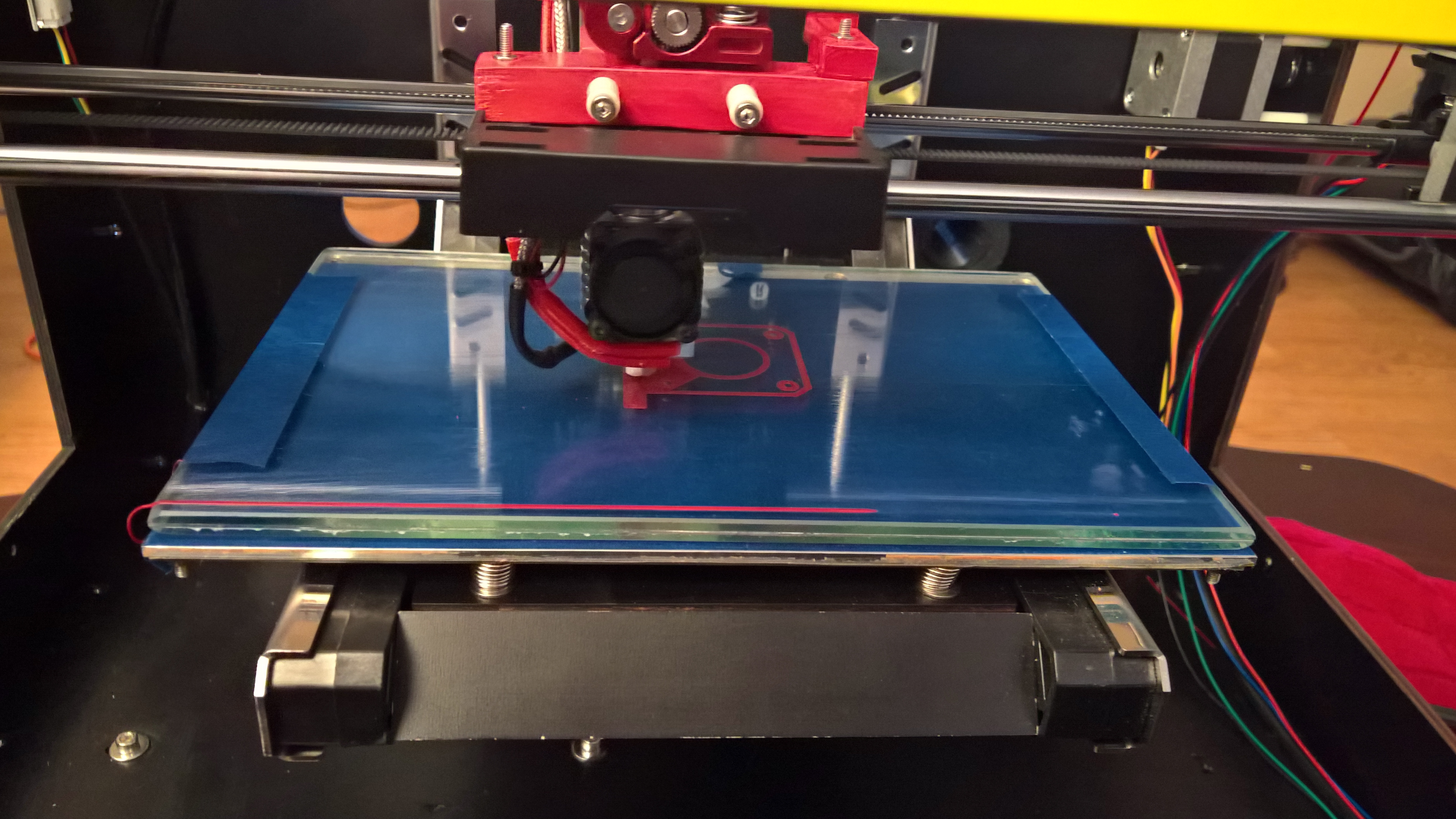

I’m having some huge problems with my modified CTC printer. My prints run off great for a while but eventually the nozzle will clog and the print fails. However, when my nozzle isn’t clogging I am still getting weird anomalies in my prints… I am running a Prometheus V2 Hot End w/ Bowden. All of which I custom designed or printed… All my axis have been ungraded with aluminium pulleys, pillow blocks, polymer bushings, glass build plate, reinforced build plate with steel arms and a few misc mods for case stability. I have attached a picture of a failed print for you guys to look at… Right now I am stumped and it’s costing me a lot in MakerBot PLA Filament to keep troubleshooting and failing prints… Also, I am printing at 235c w/ red MakerBot PLA.

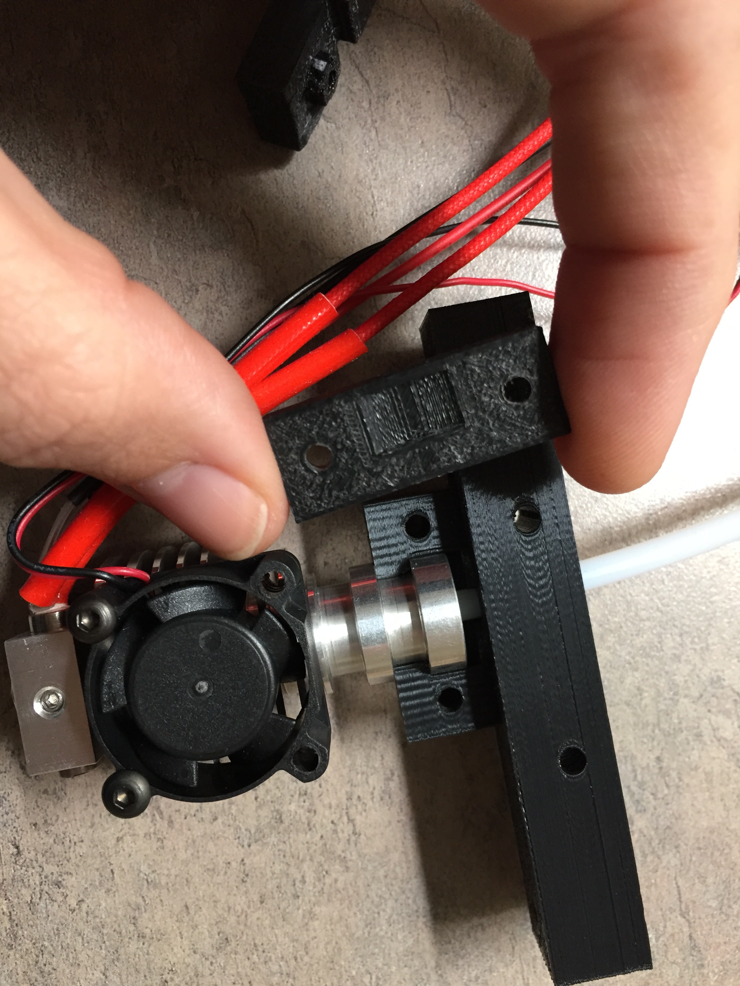

I actually got tired of unclogging the tubing and replacing them so I actually replaced the hot ends completely… I also swapped all those cheap plastic pulleys out. Take a look at my pics. Note: Some pictures are before switched to Bowden. Before I switched was using a custom direct drive j-mount bracket which I remixed.

Some very impressive upgrades

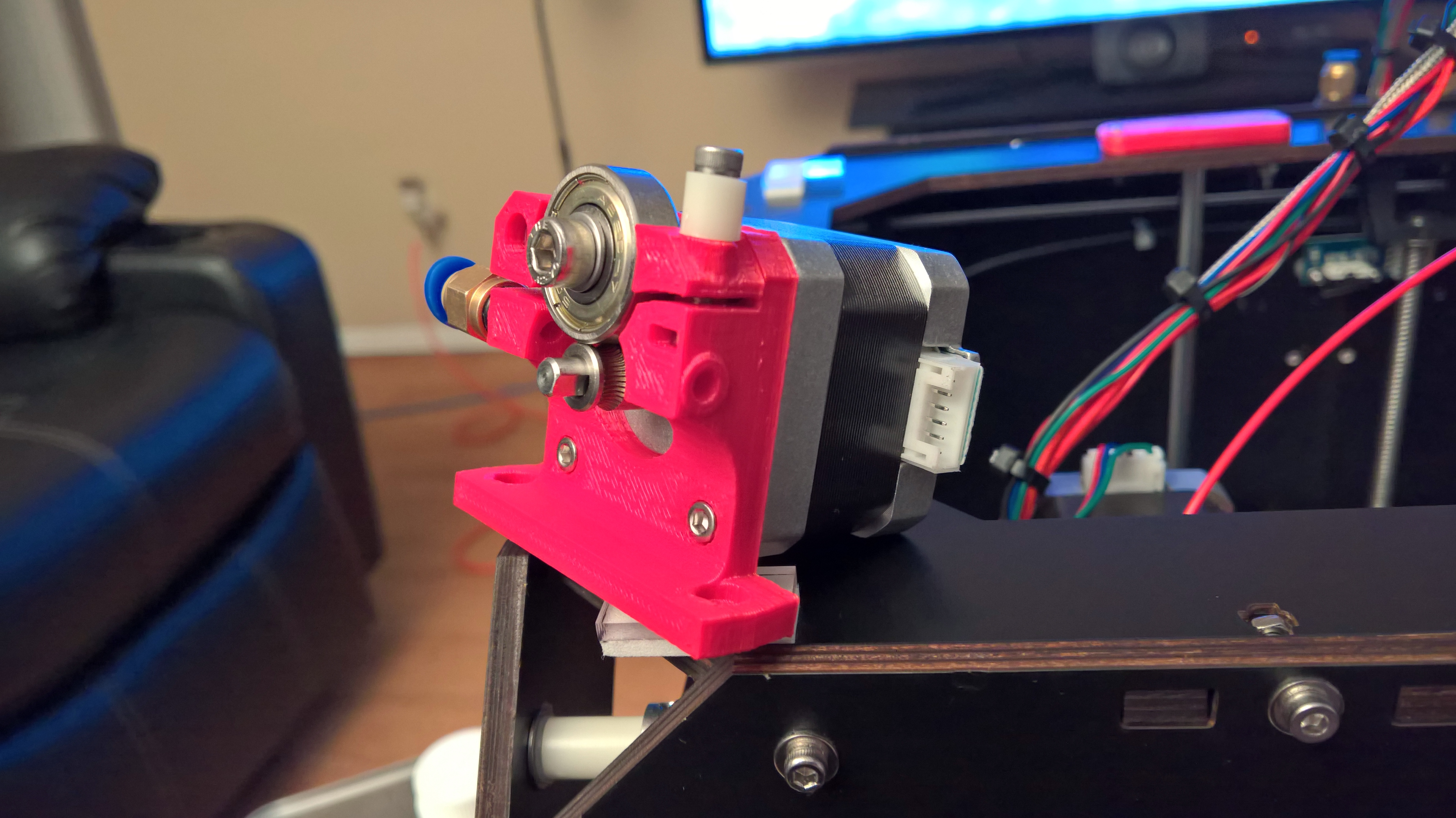

I forgot to respond to the extruder tension, yes I can adjust it via a small set screw on the side see the pic attached to this post and look at the bolt with the white spacer between it and the extruder body.

whats that spacer thing on the extruder tensioner? Normally would be a spring or rubber tube that acts like a spring. Again try feeding by hand through the extruder, If you’re happy with the tension.

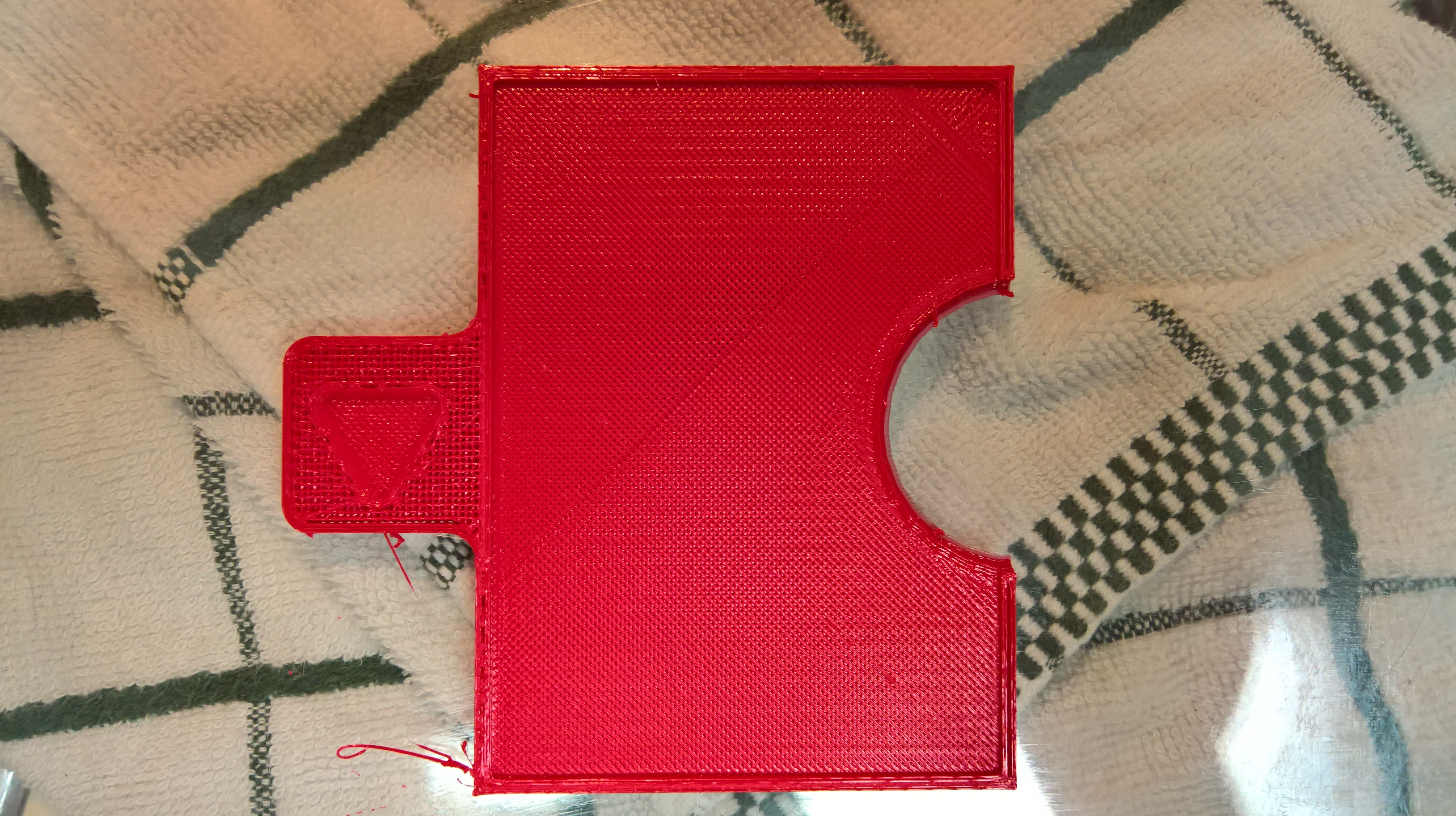

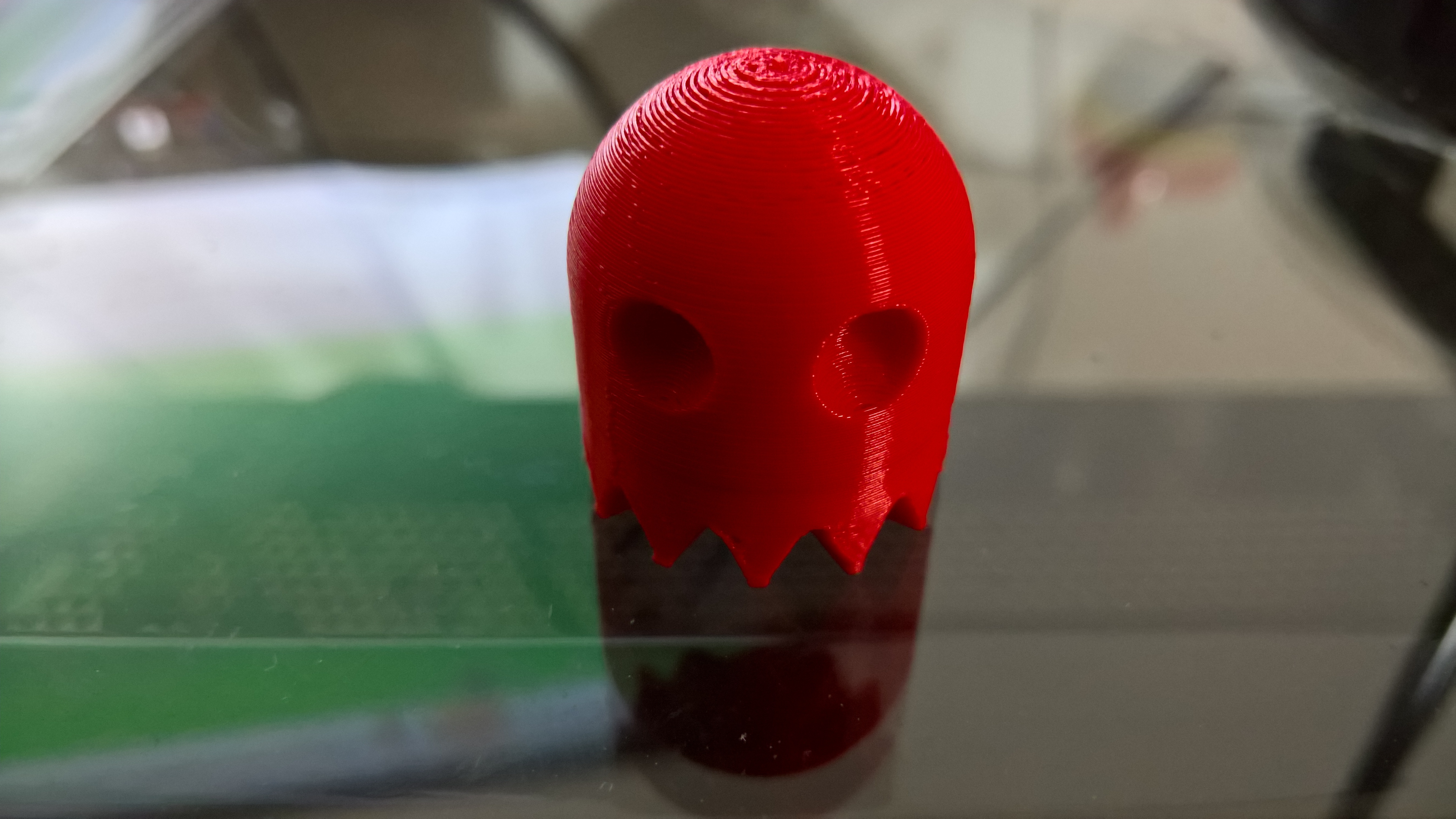

So after many trial and error sessions with MakerBot Desktop I decided to purchase Simplify3D which after applying some of the data you provided along with “lowering” my extrusion multiplayer I was actually able to print without clogging!
Using temp of 212c
I am still having a few minor issues however, as evident in the new pictures I attached below. Got any ideas? ( little holes on top minor bulge around waist and just minor little air hole looking spots )
