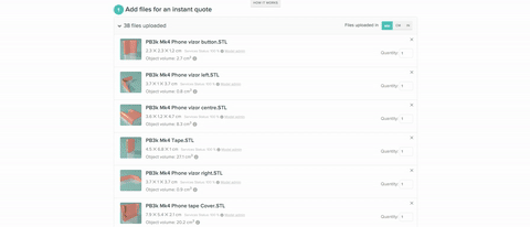

Thankfully, 23-year-old mechanical engineer Yvo de Haas of Ytec3D 44 took matters into his own hands and used his SolidWorks skills to 3D model a custom 3D printable version of the Pip-Boy 3000 Mark IV. The impressive design assembly features 38 parts that are optimized for FDM 3D printing and is customizable for different wrist sizes and smartphones ranging from the latest iPhone 6S models to various Android and Windows phones.
“Designing the Pip-Boy was the natural thing to do after Fallout 4 was announced,” Yvo recently told 3D Hubs. “There were (and still are) many people designing it, but I was one of the first to come with a fully finished design.”
To make 3D printing the Pip-Boy as seamless as possible, we’ve already pre-loaded all of the necessary 3D printing files into three ‘3D Hubs Print-Ready Kits’ designed for small, medium, and large-sized smartphones. These kits include optimized original design files for 3D printing through the 3D Hubs network of nearly 24,000 3D printers around the world.

1) Click the right kit below and wait for the page to load the files, then scroll down to choose a Print Location with a good price.
