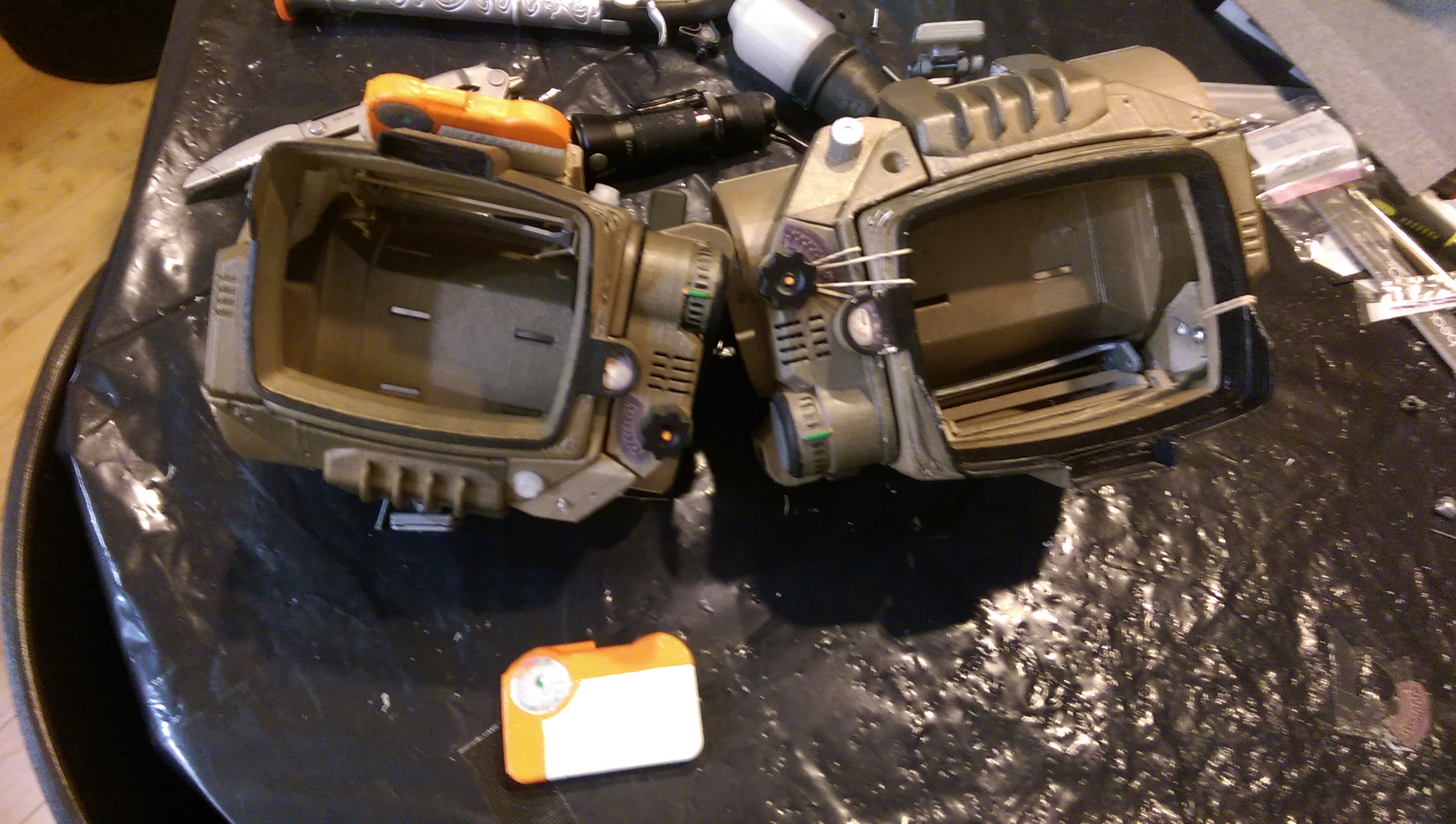

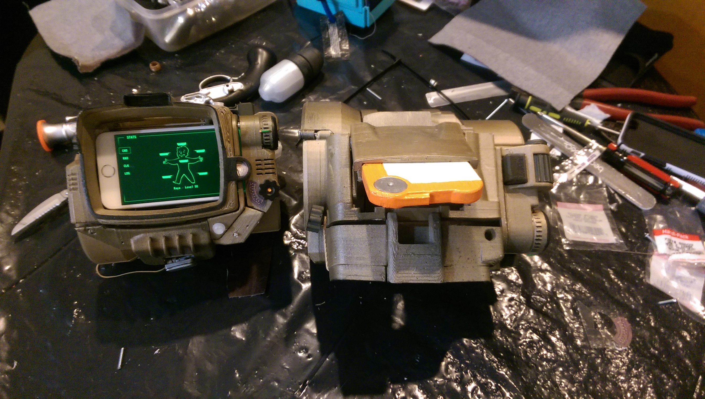

A friend asked me to print up a couple of these for Halloween. “No problem” I said, without knowing what I was getting into(LOTS OF PARTS!). I printed all the parts in ColorfabbXT and shipped them off to my friend who did the rest. He was very happy and I was very impressed with the final product, although I wish he sent me better pictures. Anyway, I didn’t realize how much these were in demand. I’m not sure what I would charge to make more because it was pretty time consuming, even with multiple printers, but $100+ for sure if anyone is interested. https://www.3dhubs.com/miami/hubs/mindfull

Bringing this thread back to life. I’ve filled two orders for this recently. It is a fantastic model to print, all of the parts are built for printing and come aligned correctly to the print bed. I offer the prints in whatever base color the customer selects and then print out a plate of white parts, black parts and translucent for the lamps. This makes assembly and finishing easier as there is very little painting to deal with. https://www.3dhubs.com/grand-rapids-mi/hubs/miaviator
I’ll have to pull up the last order when I’m back at the office. It’s around $50 + $12.50 shipping for two priority mail boxes. Takes about a week continuous to print at 240 micron ABS.
