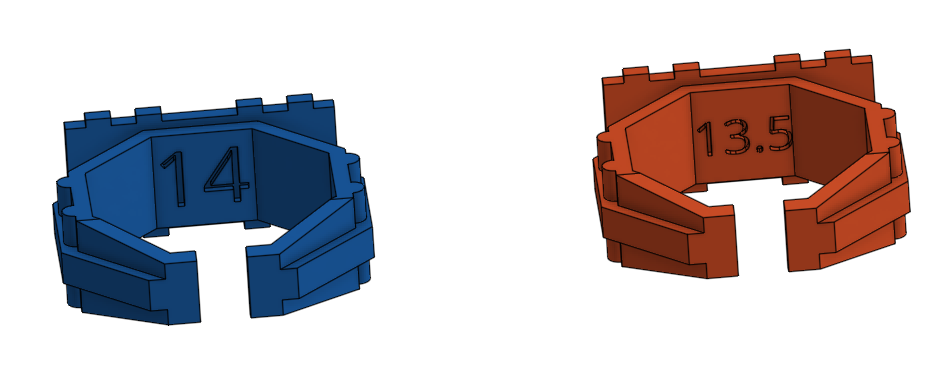

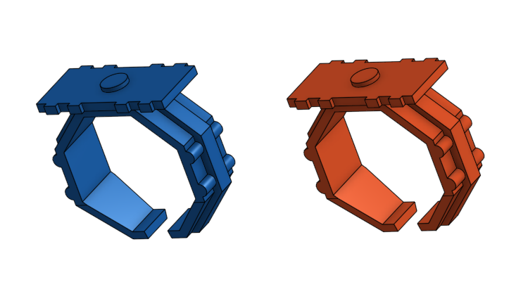

I’ve drawn this up with reference to your photos and the initial image of the 4 silver rings! What do you think, is it close?
I’ve guessed the dimensions. It took about an hour in Solidworks.

More views to compare.

any chance you could put the ring sizes on the inner part of the ring to help distinct the two when I do get them printed I’m more then likely going to have them printed the same color, just not sure on the material just yet

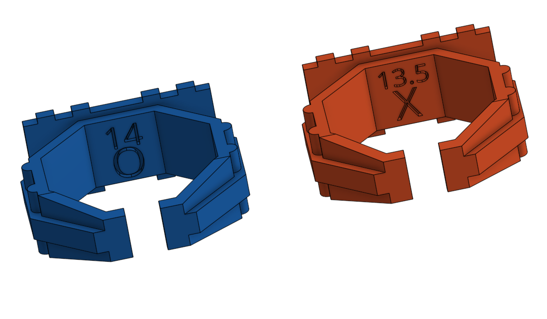

Done!
nice so I take it the models are completely done? but do you think you could make the numbers a little smaller?
you should definitely go wih high resolution SLS or SLA printers, they might cost a lot more to produce that way, but all the 3d modeled details are useless, if the printer isn’t capable of producting them.
Also why not use indication marks? an “X” for size 14 and an “O” for size 13,5 ? That would be way easier to see and would maybe come out in a lot more detail (would also be able to be made smaller).
