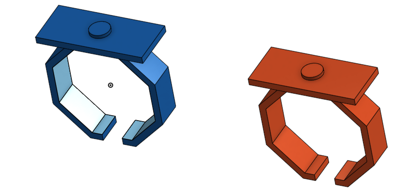

The internal diameter of the octagon is 22.6mm which I believe is US 13.5. If you can let me know what US14 is in mm, I can either rescale the whole Ring or modify just the octagon. The ring conversions I found online don’t seem to go upto US14.

if I got this right the inner diameter for a US size 13 1/2 ring is 22.61 mm and for a US size 14 ring it would be 23.01 I hope these are right since I’m going off of wikipedia, also I haven’t been quoted a price for the cad work just yet and I’m honestly a little worried it might be out of my budget which I’m keeping relatively close to 40 dollars since I have to get 14 of the size 14 rings printed and 30 + of the size 13 1/2 the only part that needs to be modified is the octagon the rectangle part ontop of the ring has to stay a specific size and measurement otherwise it won’t work for what I need these rings for

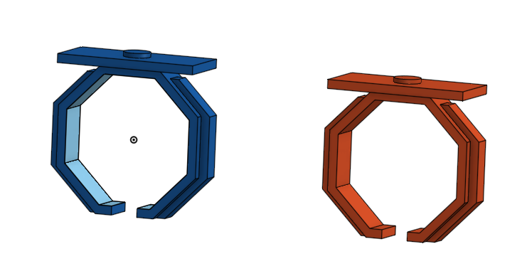

Whoops is right! I fear I may have to “start over”, almost! Thanks Adam!
After starting somewhat over! I can continue to add detail.

I will need the dimensions for the top part and images if any more detail required.
there are two photos of the ring with a side view with a tape measure and a front view with again a tape measure
I’ve drawn the top rectangle part; 30 x 12 x 2mm and the pip on top is 1mm high, 3mm diameter at the top with a 45deg chamfer.
I thought you were going to give clearer images and dimensions of the top part. Do you need anything changing from what I’ve drawn?

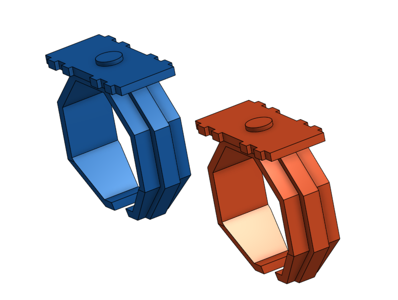

It looked like the two of you were going to “finalize” the design. So I stopped…but I can continue!

Update Cosplay rings!
