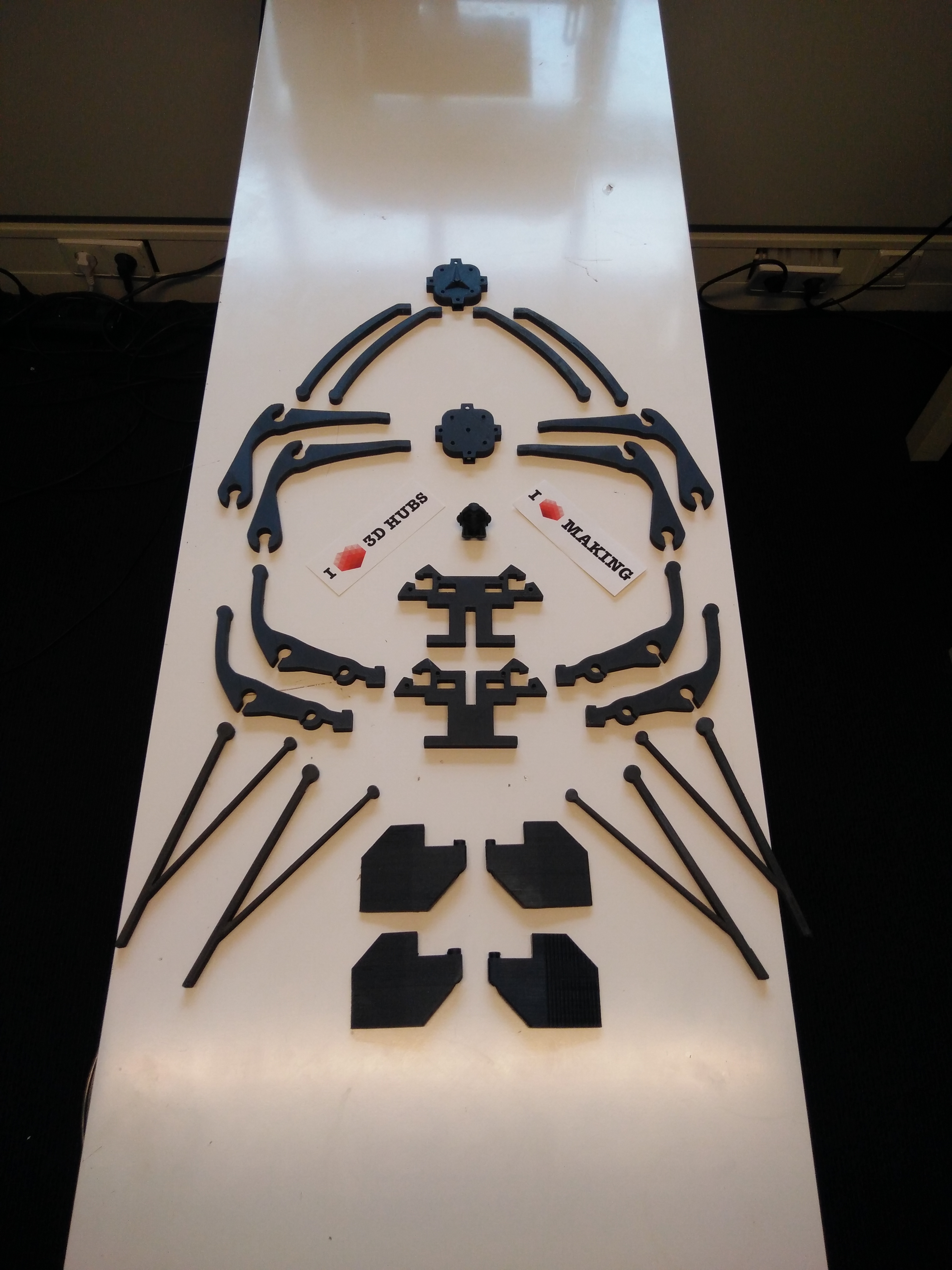

After a nice teaser a while back, about our x0mb1e drone project from @CobraGad 1, I think it’s more than time to give you an update.
So here I am again, this time with all the parts printed and ready to assemble!

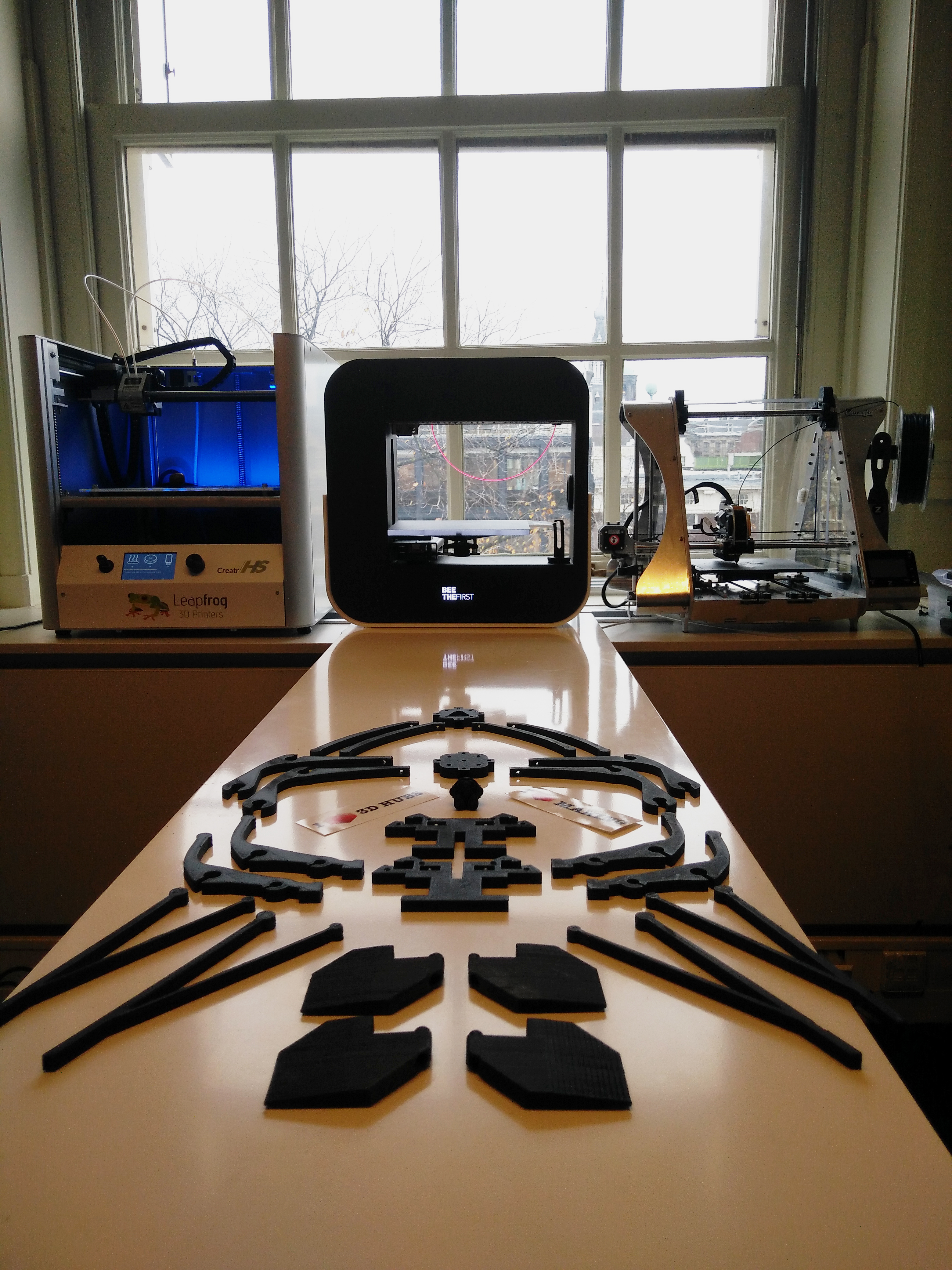

Here they are, in our lab with the Leapfrog, BeeTheFirst and Zmorph (from @ZMorph3D), waiting to be assembled!
Took me quite a long time to get all these printed, because I was working on other projects and experimenting with Carbon Fiber Filament. However if you have a well calibrated printer, with the right settings dialed in and a decent build volume, I guess you can print all of the 24 parts in 2 or 3 batches.

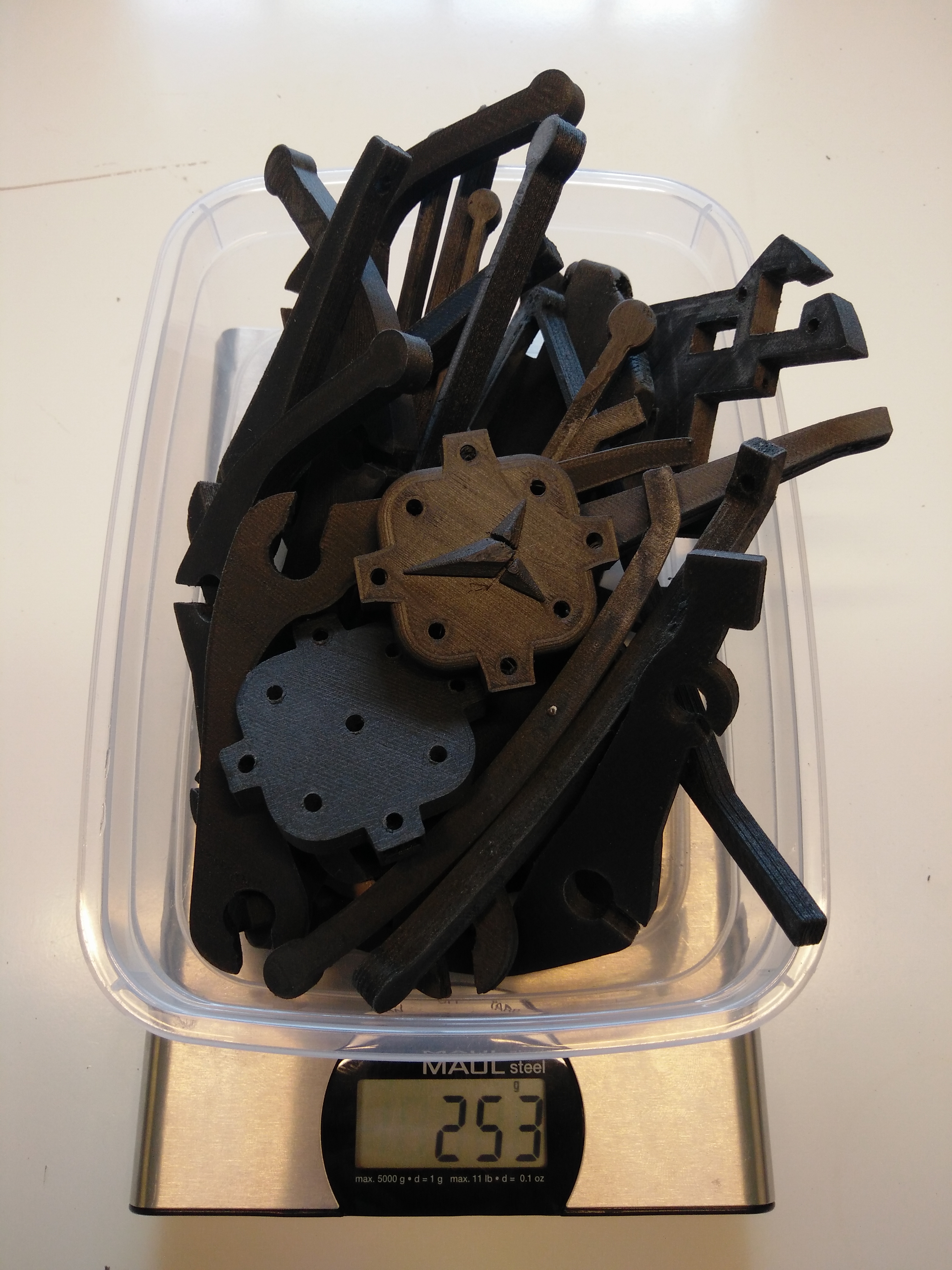

All the parts were printed with XT-CF20 filament from @ColorFabb on our Leapfrog Creatr HS:
  • Speed : 50mm/s (no so HS in fact)
  • Flow : 105%
  • Temp : 250°C
  • Layer height : 0.1mm
  • Infill : 50% for most of the part, 100% for the thinner one (Legs)
  • Cooling : 20% (any higher value gives an horrible mess for me…)
All printed without support, I have to say that the design is really optimized for 3D printing ! Awesome job @CobraGad !
For those who printed with this filament already, feel free to share yours for comparison!
I find XT-CF20 to be a really nice material once you get the right settings for your printer. It’s really stiff and remains quite light !
Talking about weight, here is the total of all the 3D printed parts (W/O electronics) in grams :

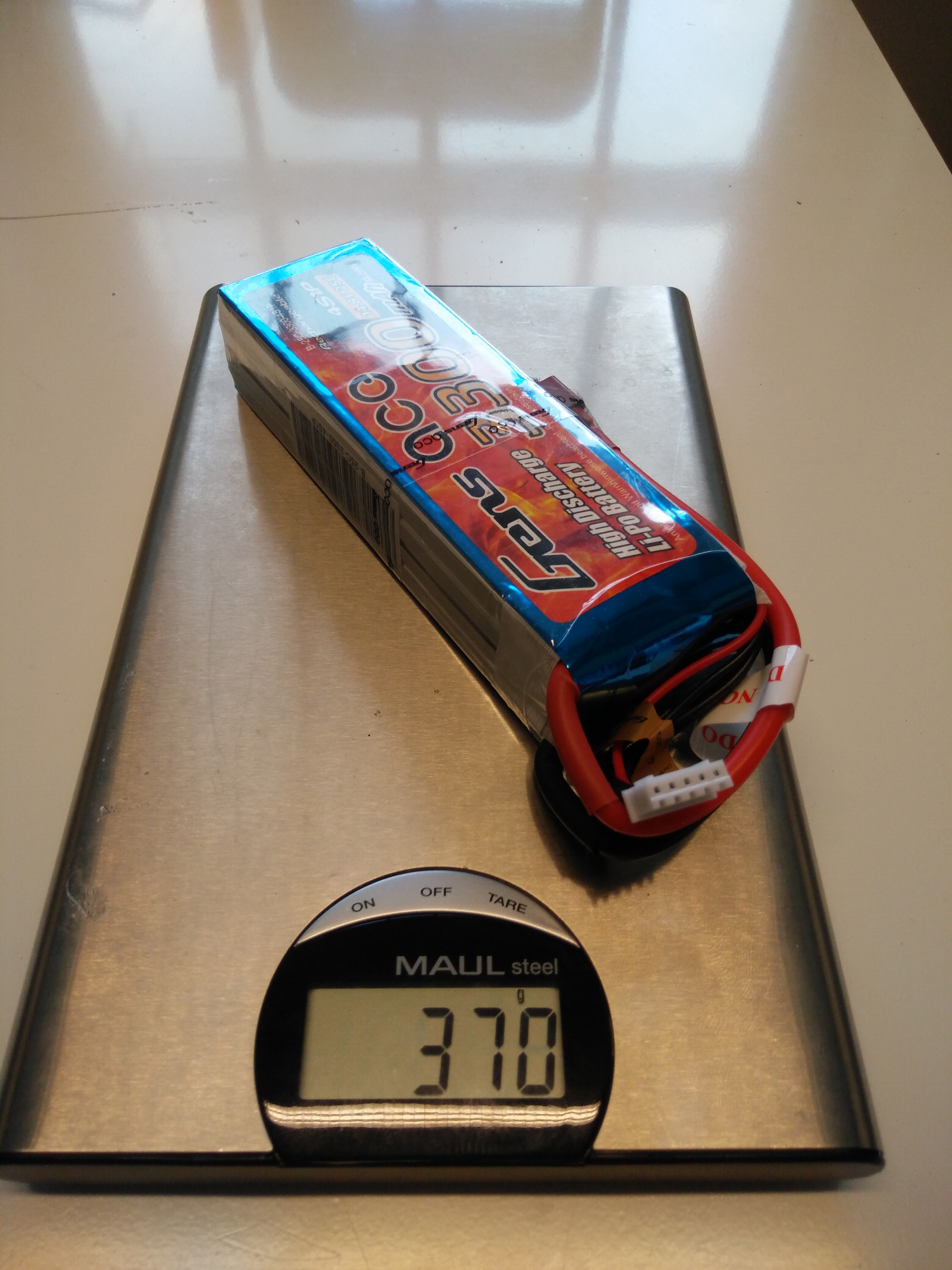

For comparison, we received the battery the other day. Seriously we thought it was a mistake in the order. We double checked aaand… it’s not.
This drone is gonna be a freaking war machine !
So basically the weight of the whole structure is not even the weight of this monstrous battery…

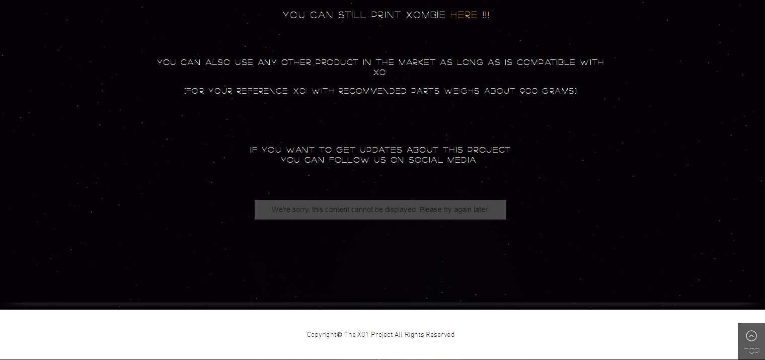

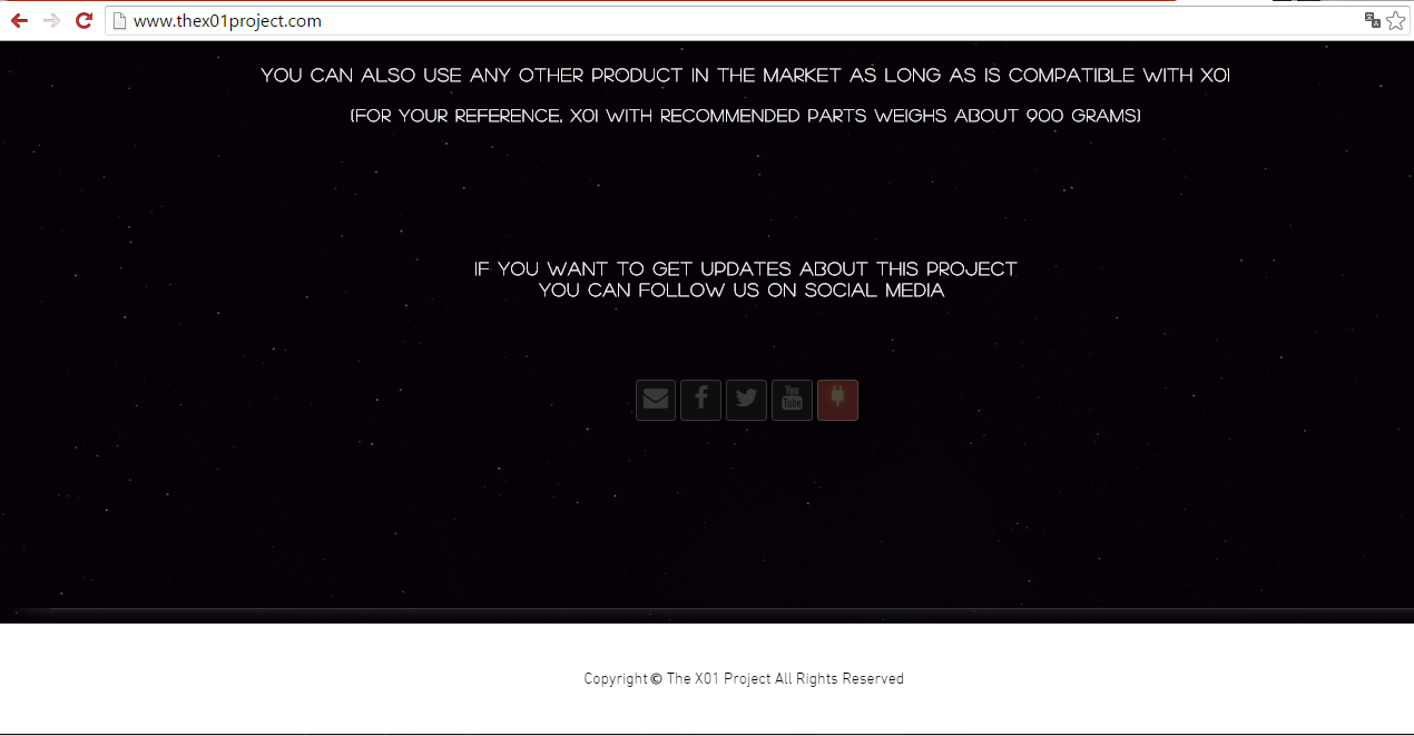

On the Xombie site the home page is filled with
We’re sorry, this content cannot be displayed.
Please try again later.
No links to download.
Site is very disappointing.
