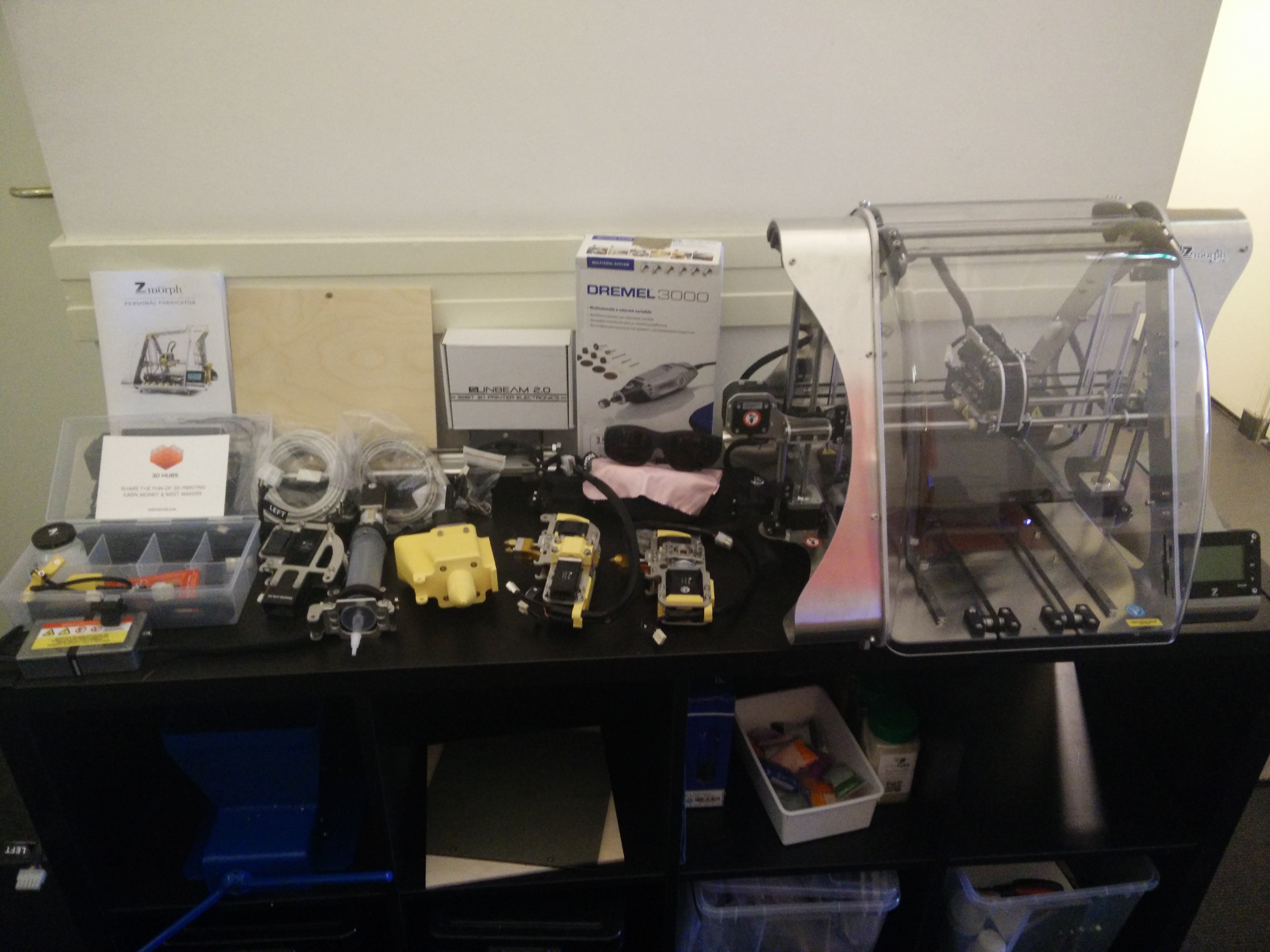

It’s their latest 3D printer with all the things that come with it. It’s truly a personal fabricator, with a lot of options to make some nice models.
Let me just give you guys an idea of what came with it…
  • The ZMorph 2.0 S - 3D printer
  • DUAL head extruder, for 1.75mm filament
  • Print head 1.75mm extruder
  • Print head 3.00mm extruder
  • Chocolate(!) extruder
  • Ceramics and paste (e.g. cake!) extruder
  • Laser module, for cutting and engraving
  • Touch probe for calibration
  • Heated bed + glass bed and a buildtek print plate
  • Dremel + mount, for 3d and 2d milling
  • Plywood work platform for cnc milling
  • Photo camera trigger + rail, for time lapse photography
  • Toolbox
We were pretty impressed by all the parts and possibilities that came with this printer. I think I even forgot a couple of parts, but all the different printer heads already gives you a lot of ways to create stuff
