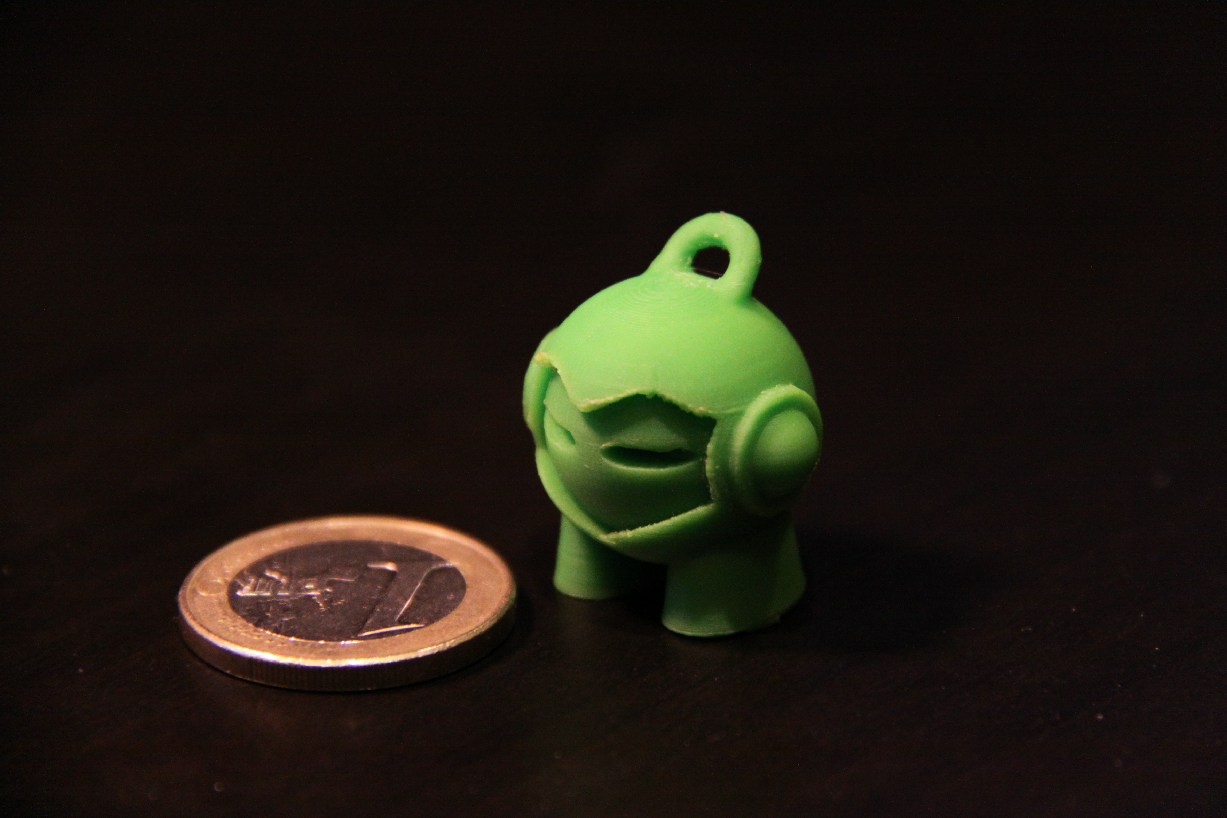

It was my first Marvin, ever.
Settings:
Infill: Medium
Support: 0%
Resolution: 0.09
Fan: Auto
Print time: 38 minutes
Might turn out better with other settings as well, but worked effortlessly for me (thanks to Zortrax). The only thing that was not so good is that the raft got stucked to one leg (only the left, strange thing), and some minor irregular edges appeared on the difficult areas.
Looks good. I had the same irregularities between the legs and the brim of the helmet but overall the Zortrax has no problems with Marvin.
Love Zortrax! What else have you been printing in the mean time?
Pretty solid for the first Marvin ever. Good job and welcome!
Just print four of them together, you will get them perfect, since you will give to the hot end enough time before printing a new layer on the same area.

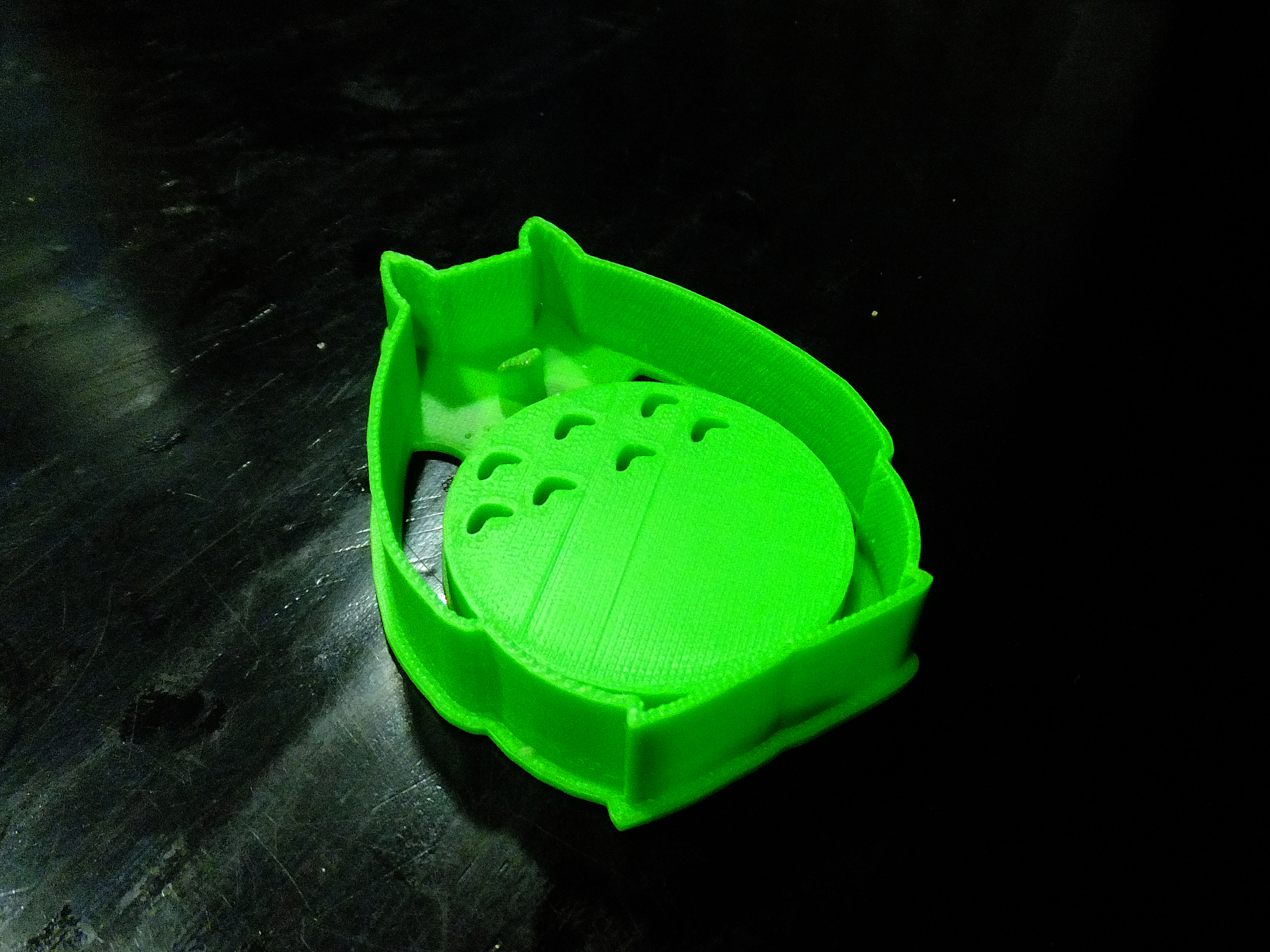

The quality is really amazing! By the way, is that a Totoro print? the green one?
It is a Totoro cookie cutter! From Thningiverse: Totoro Cookie Cutter by TechDante - Thingiverse
Wow, that looks nice! Definitely my next project
