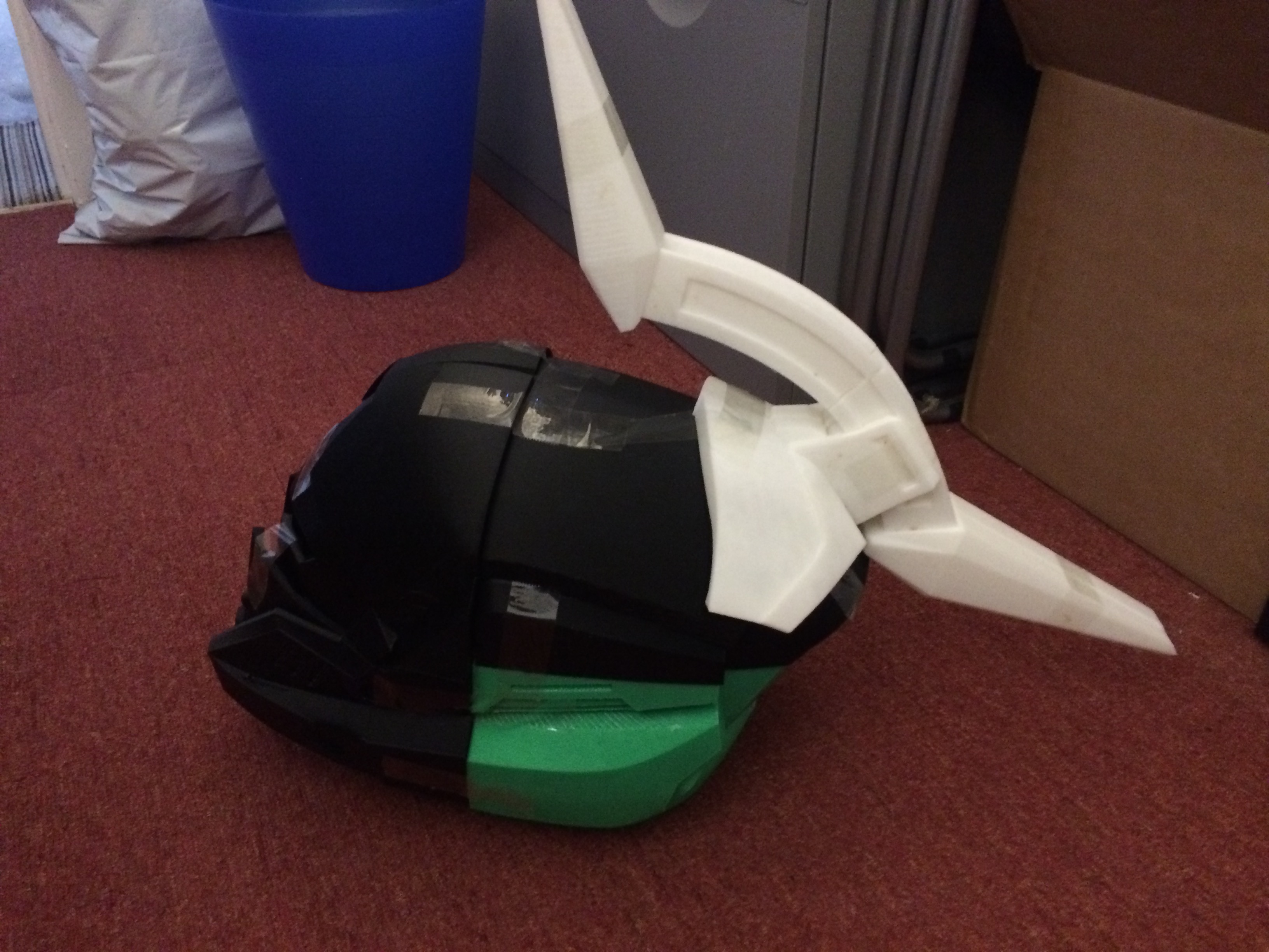

I’ve attached some photos of a few helmets I have done, as they come off the printer and roughly taped together so you can see the shape.
