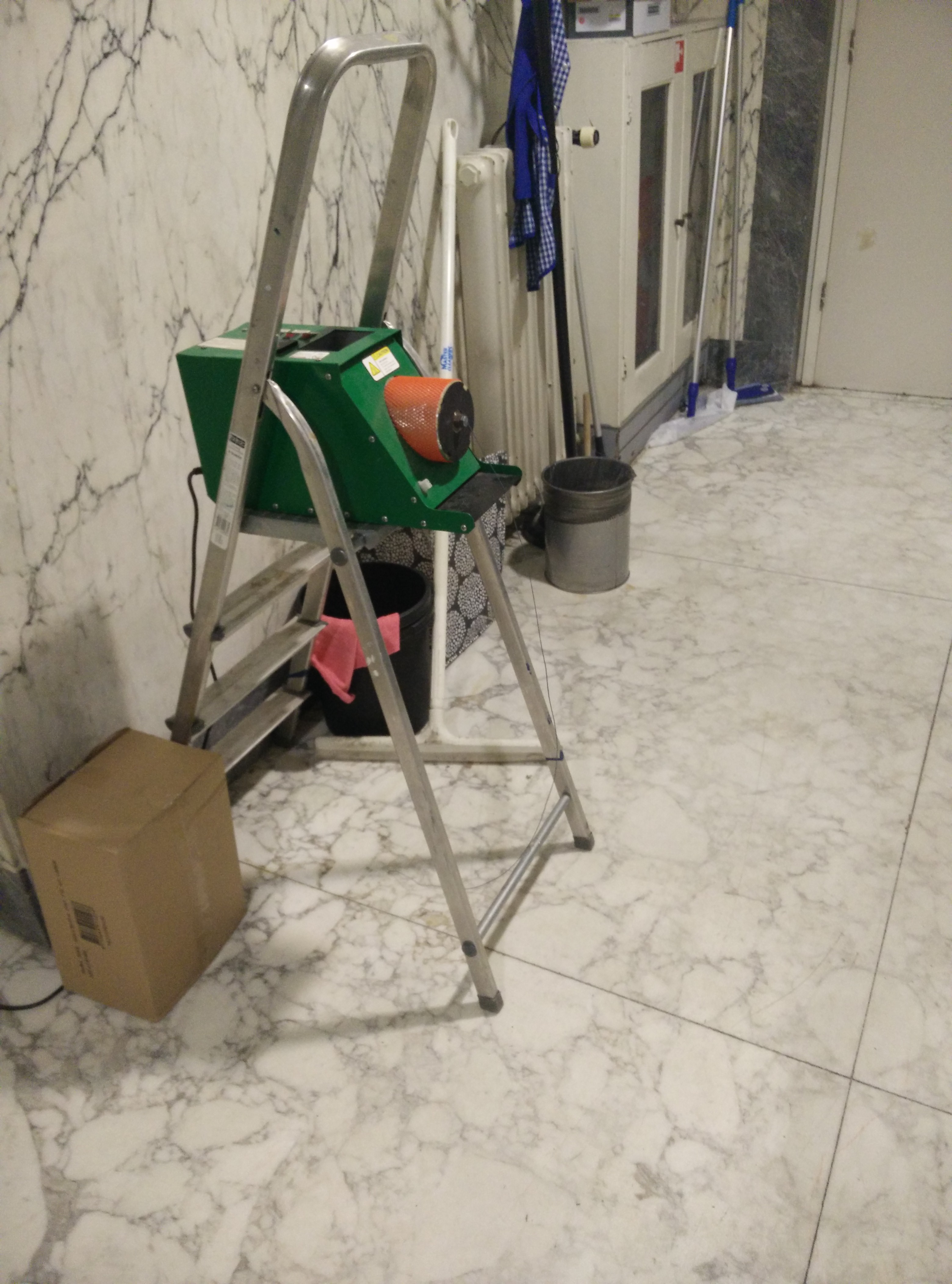

Challenge 1: Switching the Filabot nozzle
To be able to extrude with the Leapfrog here at the office the nozzle needed to be changed to 1.75 mm. Turns out that this is super easy to do on the Filabot :slight_smile: Here’s how:
  • First make sure the Filabot is heated up to the melting temperature of the pellets that you were previously extruding. In my case I heated the Filabot to 140 degrees Celsius for PLA.
  • Then simply use an adjustable wrench to screw of the nozzle and to screw back on the new one. After turning on the extruder and waiting for a couple of minutes the PLA started extruding again smoothly.
Challenge 2: Extrude PLA at the right diameter
This didn’t turn out that well unfortunately. With a 1.75 mm diameter nozzle I wasn’t able to extrude the diameter at 1.75 mm. In fact the average filament diameter was about 1.30 mm. I tried extruding at 130, 140, 150 and 160 degrees each yielding similar diameter results.
So I’d really appreciate it if you guys can tell me why this is happening and how the diameter can be increased?

Hi Bram,
With PLA you might need to use a larger nozzle. It sounds like the PLA is getting pulled from the extruder to much. A larger size nozzle would allow the filament to be pulled to the correct size.
On another note we have a spooler system that we are currently getting onboard and should have it available soon. This system can be dialed in to pull the filament from the extruder to the correct size and it also spools the filament.
