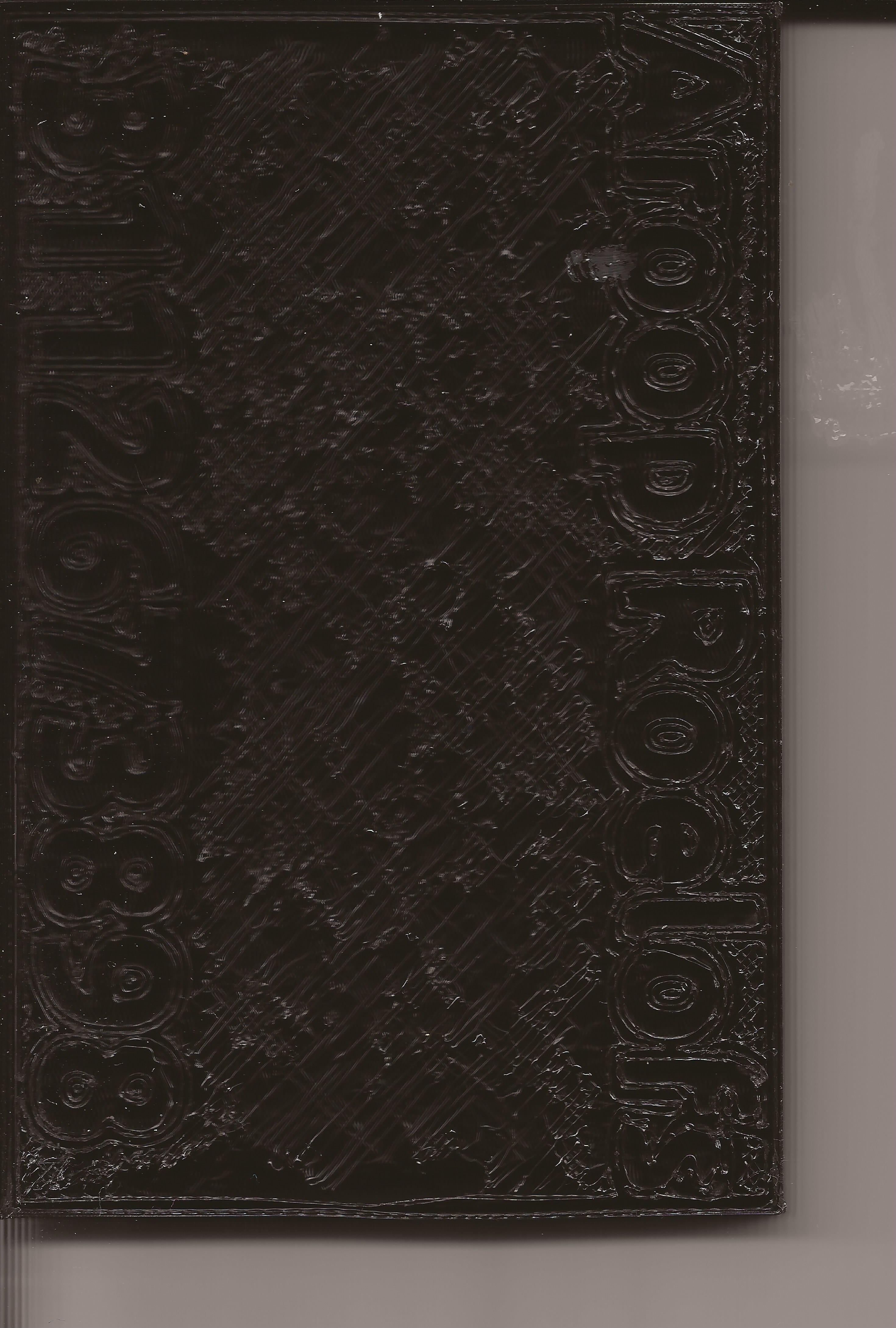

I tried to make a little card with a code of mine (it’s a tracking number thing for a game, nothing special).
However, as you can see in the scan I made (I just slapped it under my old flatbed scanner), the quality is just horrible.
Mainly around the parts where it has to work with “blank” space, the numbers and letters are pretty fine and quite strong.
When I pinch the print between my fingers on the “blank” space, I can hear and feel it crumble when I apply a small pressure.
I didn’t make a scan of it, but the first layer lines are very thin as well.
Now, of course, I want to improve it and I’m curious what causes it, and, obviously, how to fix it.

It looks like over extruding but kind of hard to tell. I might reduce the extrudsion multiplier to .95 and see. I would go back to a .2 layer height to start with, easier to get things dialed in. Also I would look at setting the speeds rather than auto. Maybe start at 35mm/sec for overall then do your top and bottom and perimeters slower. Once you start to get consistency you can start to ramp the speeds up.
Temps seem ok but might be a little high.

That crunching is one of two things, or both. If you do not get good melting between each layer, you will find you can just pull the layers apart. This would mean you need to increase extrusion multiplier, or mess with your temps.
More likely, your infill is wispy. That is why you are able to crush the print, and that the top is collapsing. I see you have infill set at 70%, so it is my guess you are printing too fast, with too low a temp, or something mechanical. The sound you describe is just “not good infill”.
If you could take a picture with your phone, so we can see it better, we could help further. There are also many other things wrong with that print.
If you have access to the printer all the time, then start with small 100% infill 10mm cubes as you adjust. Watch it closely as it prints, and try to connect the dots with what you see and what the printer and the slicer software is trying to do.

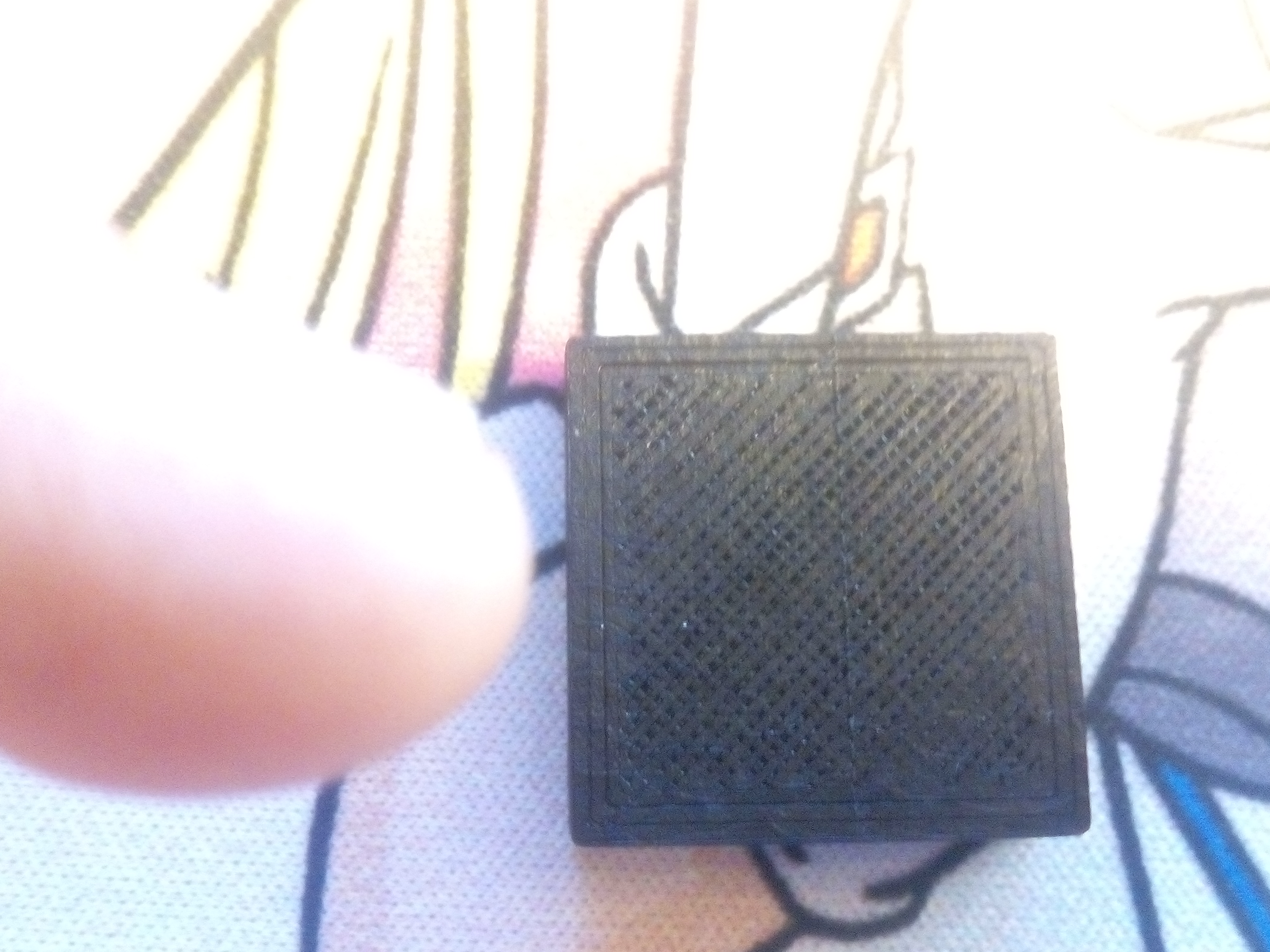

I didn’t have the time to level it, but I made this little print (see pictures below?).
I’m sorry about my camera, it’s horrible (wouldn’t expect more from a 160 Euro phone lol)
I made this little “thing” by making a 20mmx20mmx20mm cube and then stopping the print at about 25%.
The infill density was 100%, and the speeds were all 35mm (except the “Travel”)
Layer Hight was actually 0.1mm.
The “wall” (perimeters?) where heck a clean and strong, just the center/infill was rubbish.
I pulled the thing apart and this is what I found as well:
the 3 perimeter layers were strong and as clean as expected.
The 3 bottom layers were strong enough, and almost as clean as expected (could be better, but not a big deal)
I hope I could provide you with enough information right now
