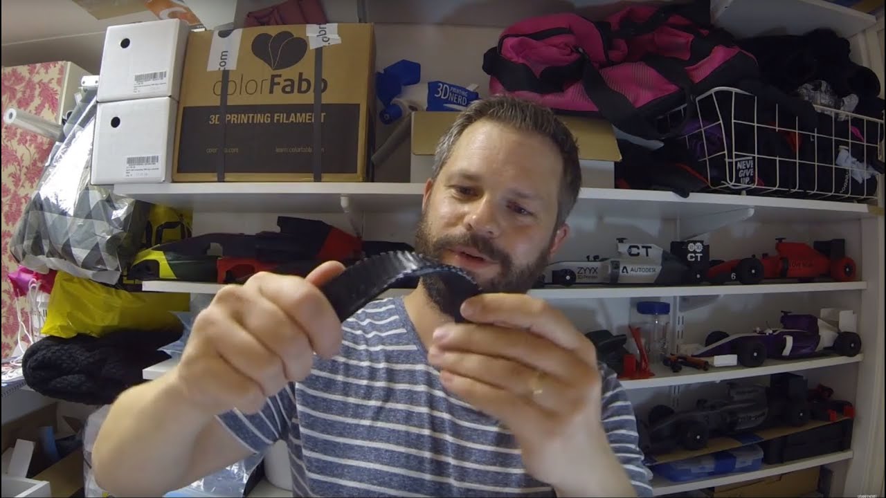

How about Ngen-Flex from Colorfabb.
http://colorfabb.com/co-polyesters/ngen-flex

Thanks Mike,
I see that the link has filament test videos from Tech2C - the 2 materials shown here both seem highly flexible, the black one even more than the white material… Too flexible for what we’ve got in mind, unfortunately.
Appreciate the suggestion, though! :slight_smile:
