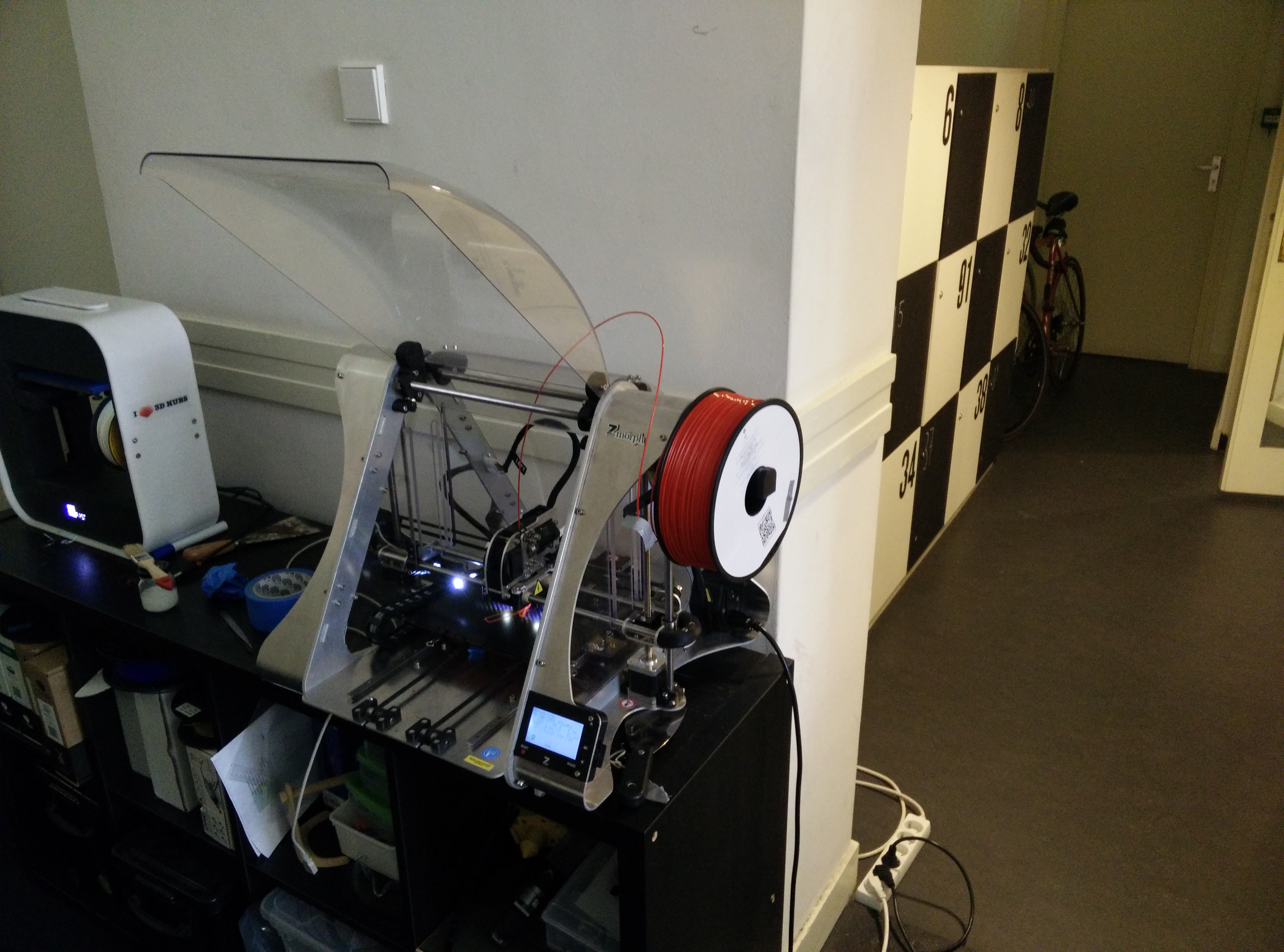

Today I’m trying to print some parts on the Zmorph here at the 3D Hubs HQ.
Although this is a super user friendly machine with loads of options I haven’t been able to get the settings right to counter warping. I’ve already applied a liquid to the platform that contains ABS dissolved in aceton that was delivered with the Zmorph. This has definitely had some effect but the problem is not solved. I’m printing a beam so this might not be the most ideal design to print either.
As soon as a couple of layers are printed the warping starts and the print needs to be stopped.

Hey @bramhallo , Could you show the model that you are trying to print and maybe share the settings that you have tried already?
Hi bramhallo,
my first guess would be that the print bed is not calibrated correctly. If the first layer is not ‘squeezed’ on the build plate evenly, it will start warping already after a few layers.
Also, I’m guessing there is a huge fan on the extruder (can’t really tell from the picture). I suggest you switch it off or reduce its speed. Too rapid cooling will increase warping. I even disable cooling completely and enclose my entire build volume so the part stays warm.
The beam should not be a problem to print in ABS. If you keep struggling, I suggest to reduce the infill (more infill increases stress) or to print your beam upright instead of flat.
Finally, I recommend using 3D-Lac instead of acetone-ABS mix. It’s much more user friendly and after printing, when the build plate is cooled down, the part will simply pop off.
I never use a raft or brim when printing ABS. Unless you’re printing really big parts, this should not be necessary to prevent warping.
Hope this helps!

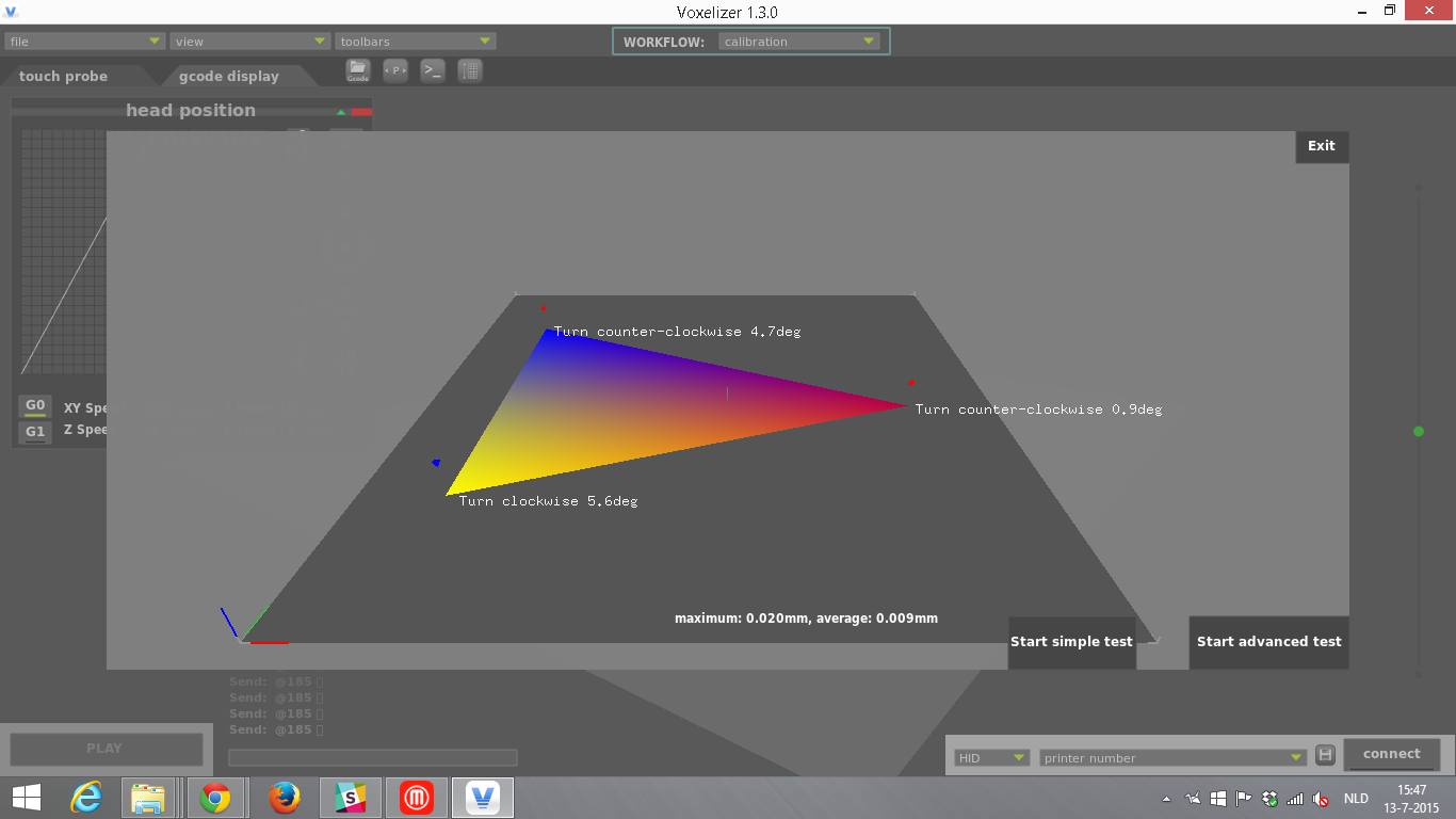

Hi Arek,
I’ve been experimenting with the Zmorph quite a bit last week and today but I haven’t been able to get any results because the ABS filament isn’t sticking to the bed. I’ve had some issues calibrating the Zmorph but I’m quite sure that I’ve got that fixed since a paper can barely move underneath it in all areas of the glass plate and the calibration tool gives the result as shown in attached picture.
I’ve had the heated bed constant at 100C. I’ve tried the glass plate, the aceton-ABS mix and blue tape. I’ve taken care of all other precautions in the link you sent as well.
When flushing the nozzles this goes perfectly fine but when extruding onto the platform very little filament seems to come out and this filament doesn’t stick to the plate but is most of the time curling up in knits behind the extruder. Do you know what might be the issue and how to solve this? Thanks a lot in any case for your help!
Bram
