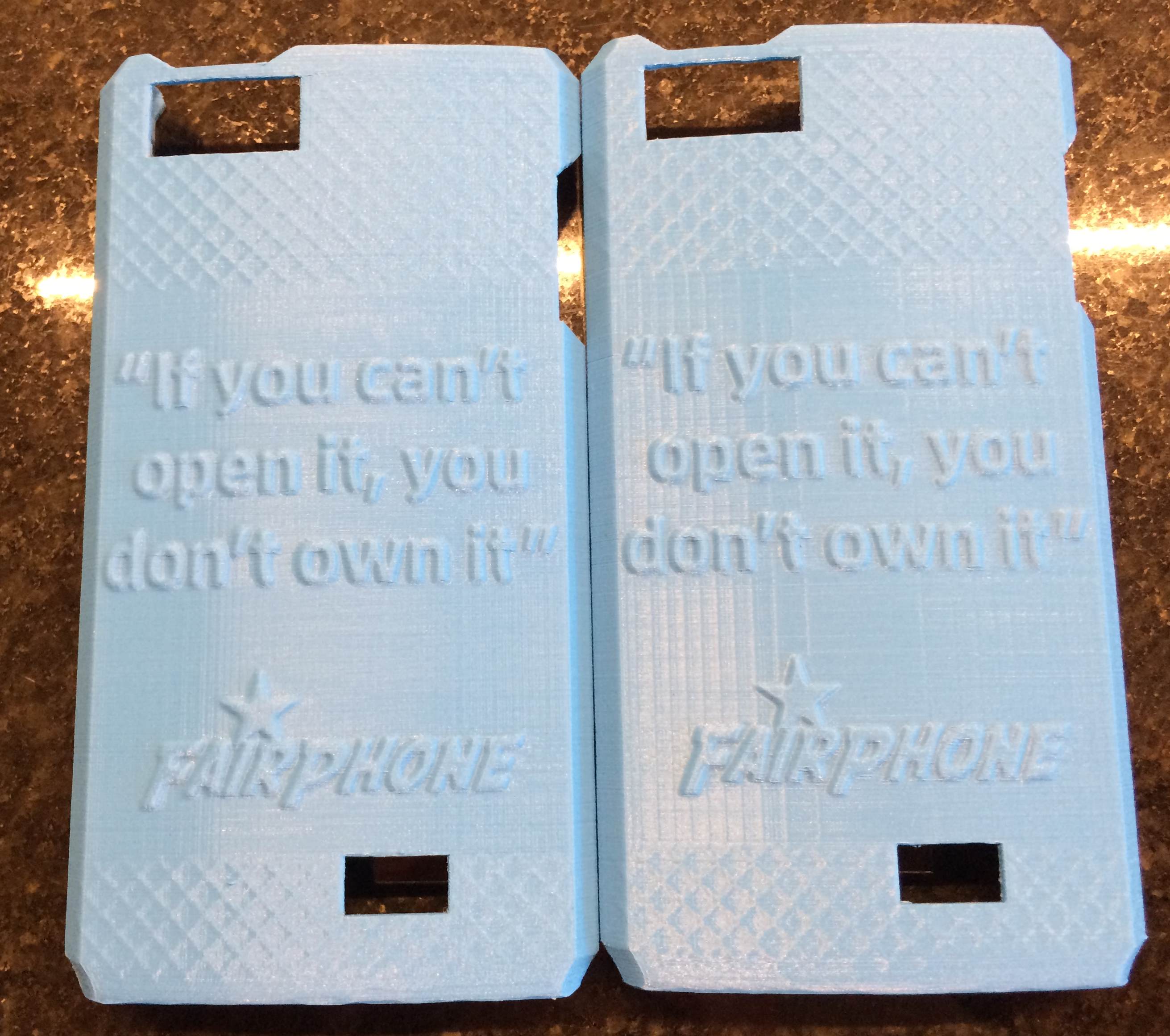

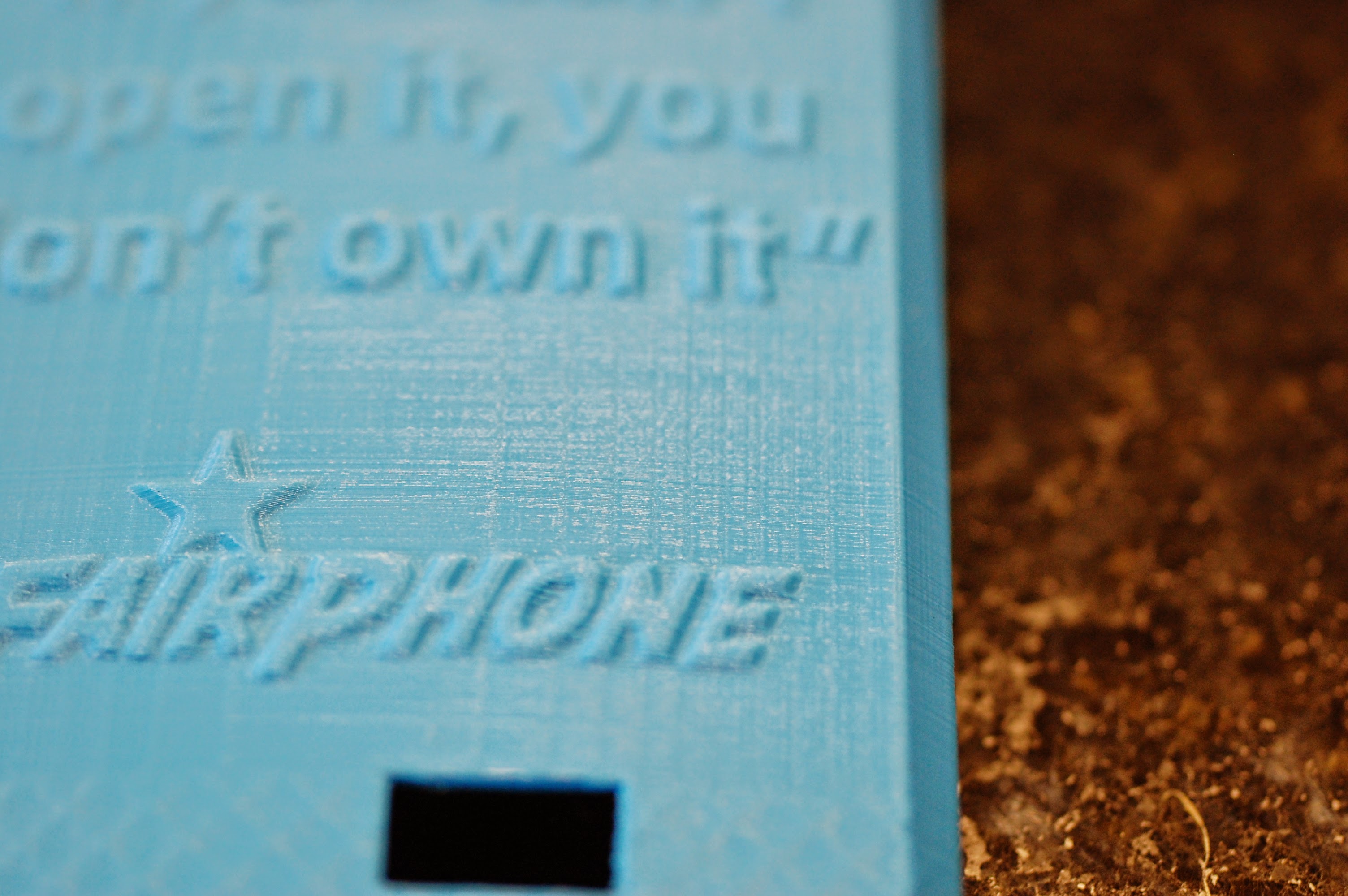

I have printed Day1, day4, test case and manifesto case. On the latter 2 where there are untextured aread, I get vertical striations.

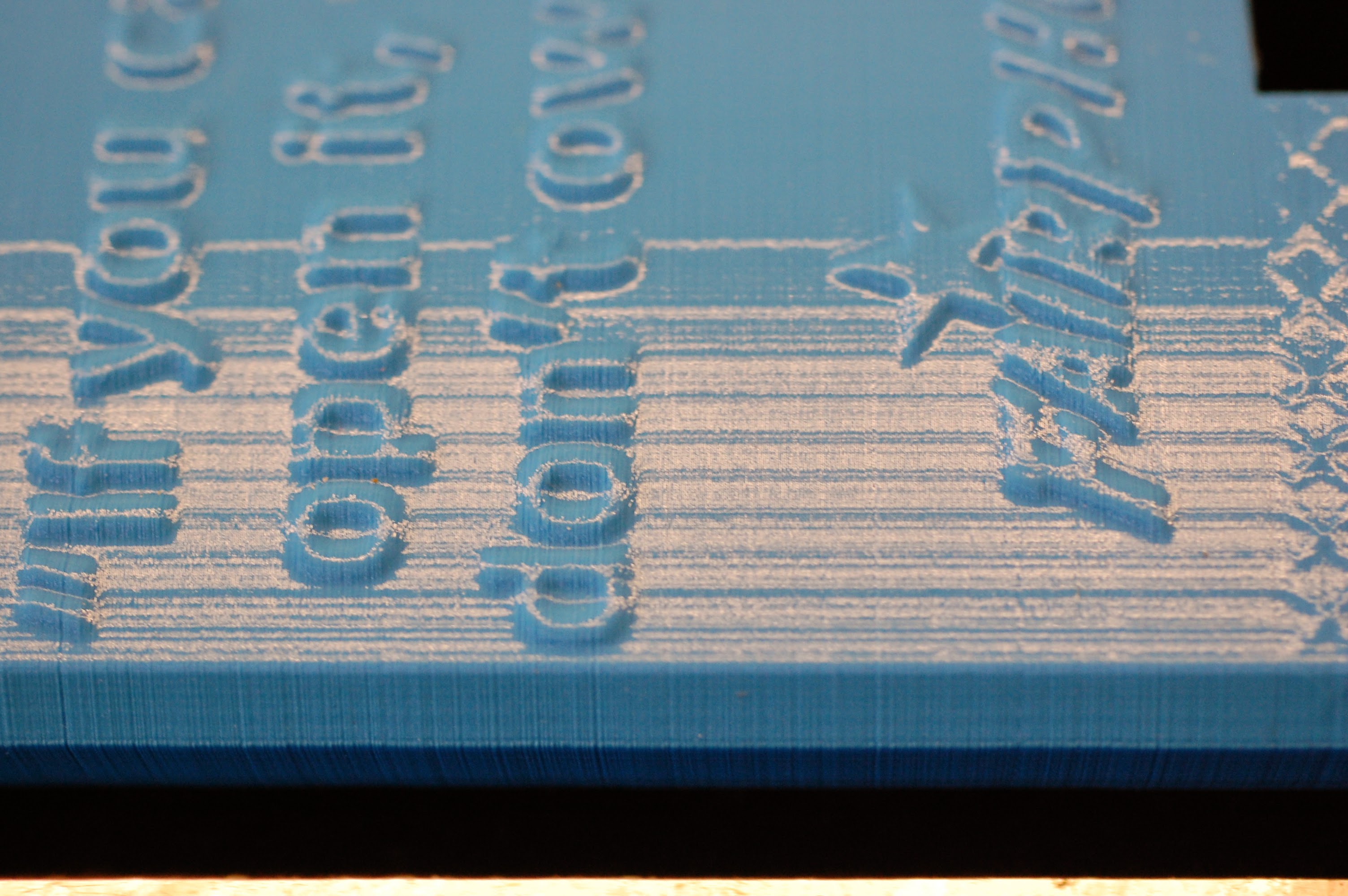

The attachments perhaps exaggerate the issue and maybe I am being too picky. Unless you have light reflecting off these lines (as I do in the photos, as well as the fact that these were taken with a macro lens) they are far less noticeable.
I have seen other examples of this on other hubs photos, but I’d love to figure out how to eliminate it. I am acheiving good quality apart from this.

What I see there is vibration. Think about your machine not as an “X/Y axis machine” but as having a seperate X axis and a seperate Y axis:
The Y axis goes from moving at 30mm/s to instantly STOP (and the X axis begins moving) when it hits a corner. Because the Y axis weighs a fair bit and your model is ON the Y axis, it doesn’t physically stop when the motor stops spinning, it ‘wobbles’ for a little… The vertical lines you see are this “wobble”. The same effect is seen when the Y motor goes from stopped to instant motion. (you get the same wobble at the START of any direction change and it continues for a small length along the part)
Try these steps to help eliminate it:
1) Make sure your Y Belt is sufficiently tensioned
2) Check your acceleration settings in firmware (you can safely send an “M201 X250 Y250” command to the printer to set the acceleration to a low value (250mm/s^2) and if you find the vibrations go away, try again with M201 X300 Y300 and so on until you find a value that you are happy with. Too low will bring in other problems, around 750-1500 should work well for a mendel. X can usually be a bit higher, I run my mendel’s acceleration at up to 3000 on x) The difference you should notice is with lower acceleration values the printer will slow down in corners. These more “cushy” movements aren’t as jerky and reduce vibration.
NOTE that if your EEPROM is turned off, the above M Codes will be ignored and you will notice no difference.
Oh. you can add those M Codes to your G Code file (toward the top) OR if your host software allows sending of manual commands you can send it through the terminal of your host software (Repetier and Printrun at least allow it)

thanks for the responses, for the record, here are the 2 results for comparison. The only difference being the angle of the model on the bed, and I also printed a few degrees cooler as I realised I was possibly printing at the upper end of the range and thought it might help with the stringing across the gaps.
I still want to try alternative James’ suggestion of alternative slicers and will report back when I do.
sorry , to clarify, I printed at 15 deg from the front plane rather that parallel to the front or side.
