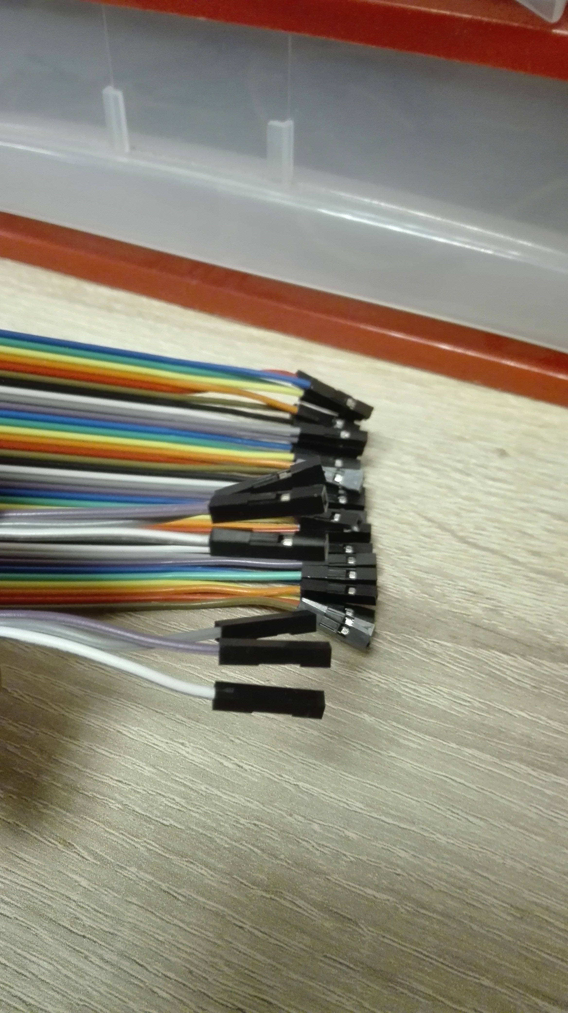

Hello,
installing a heated bed on K8400 is not as difficult as it seems. The most important is, that the controllerboard of the vertex mashine supports a heated bed. Just follow the instructions you can find already written in here.
And a few extra tipps:
I used female-female jumper wires to connect the board with the expander (works great)
I put the Builtek s*** direct on the bed-frame and used it as electrical isolator
I made a sandwich of frame - thermal isolator - heatbed - glassplate and just fixed it with foldback clambs.
Keep in mind that your printbed is much bigger after this. So you might also have to modify the z-endstop to prevent a nozzle-crash. (I used superglue (cyanacrylate) and a pice of filament).
The ability to print on a hot glass plate, a full metal hotend and a few extra pulleys for the 8mm rods complete the vertex printer ;). Have fun with your mashine
