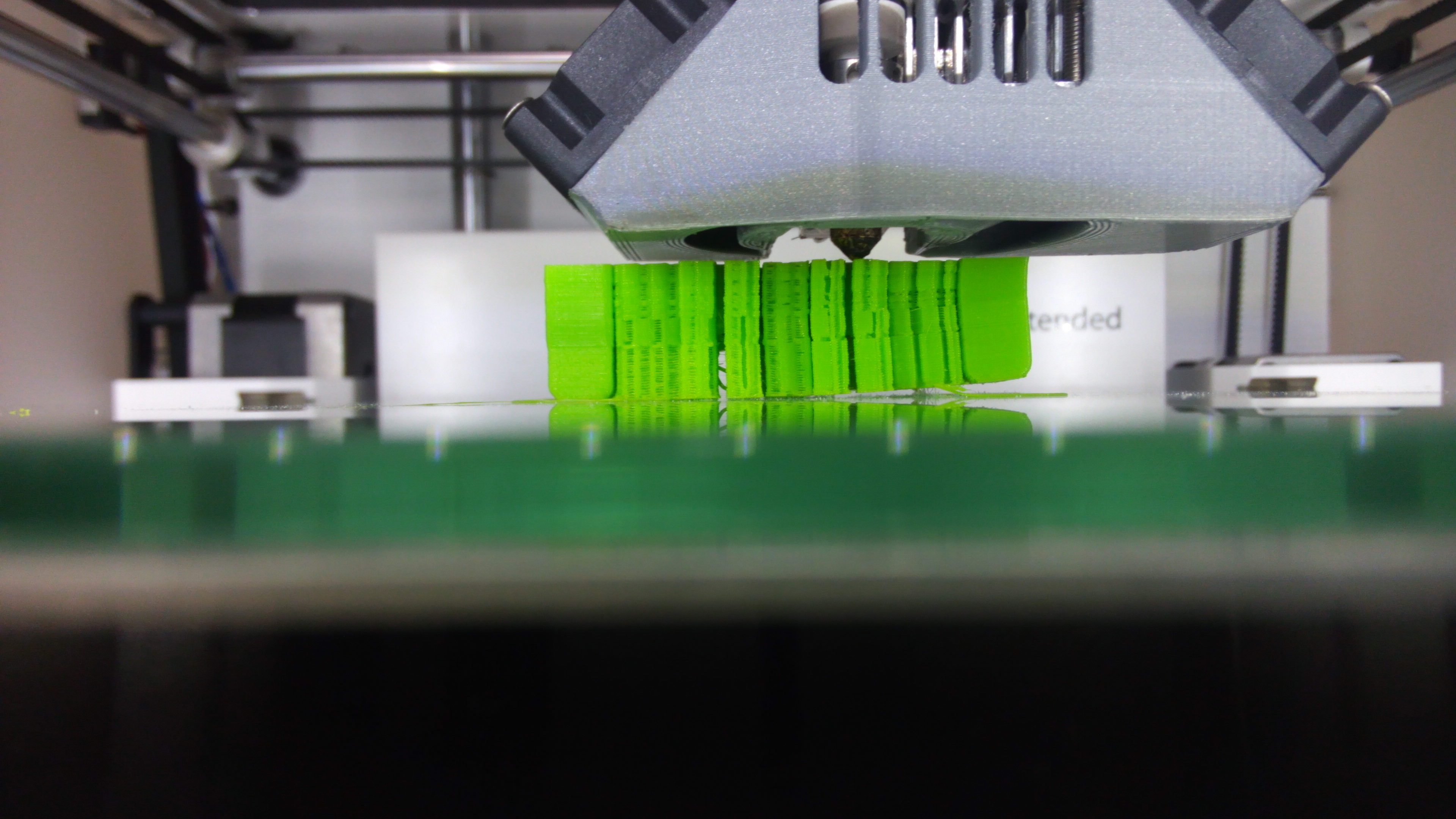

Anyone Else having this problem???\

Are you printing with ABS? If that’s the case the issue is called warping. ABS is a material that expends when heated and contracts when cooled down, as you are printing the print will contract and pull on all edges, some of them might detach from the build platform and lift, while others might stay on the bed. Search for “ABS warping” or “ABS bed Adhesive” or similar to find ways for compensation of this effect. Basically you need a heated bed, that keeps the print warm, since there’s less cooling /slower cooling of the print, it won’t contract that fast and extreme. Secondly you need to use special adhesives of which some like ABS-juice can be homemade, those adhesives bind the print to the bed and will keep the edges/corners from lifting. Cheers, Marius Breuer
Oh yea sorry, I’m using UPET material or CPE filament from ultimaker and it came with my Ultimaker 2 extended which has a heated buildplate. I was previously printing with PLA and had no warping issues.I’m also using a gluestick for extra adhesion on the buildplate but still it starts warping about halfway thru the print and if I leave it, it only gets worse

Check the temperature recommendations from the filament manufacturer, as it’s most likely PET, what you are printing, the temperature should be around 240-250°C for the hotend and 60-70°C for the heated bed.
Also better use a little bit too much gluestick, then too less. I usually swipe the gluestick around the bed until i have a visible layer of glue applied, you’ll also feel, that the surface is sticky, but not wet, when touching the heated (!) bed. Disable your cooing fan or let it just run slow. PLA has a very low contracting factor and usually warping is also not that much of an issue with PET, but it still can happen. Please check all things I listed above and google around to find other’s, that also have warping issues with PET (or whatever UPET should be). Definitely read all information provided by the manufacturer, usually they provide you with guidlines for temperatures, speeds, cooling and so on. Lastly try YouTube to find general informations on how to prevent warping and maybe you’ll find a guide for printing PET.
