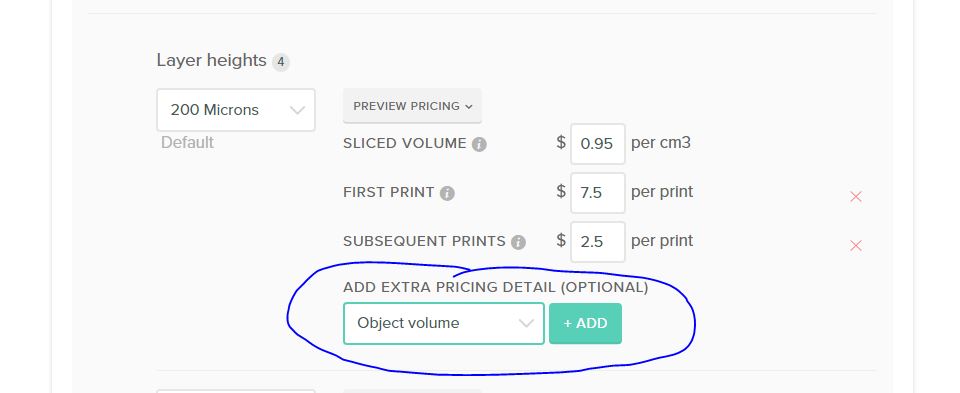

I was having similar frustrations. I ended up just raising my price per cm3 to account for this so at least the customer would know up front a more accurate price. You can also go to your printer settings on 3DHubs.com and change the settings to look at the actual volume of the part instead of the sliced volume. Of course, support material isn’t included anyway in the calculations, so I do have to explain that added material and time, but most customers are completely fine once you let them know.
The attached screenshot shows how to change the settings under “Edit your Printers”. Once you add the extra pricing detail for sliced volume, you can then delete the pricing detail for object volume. I’m still debating whether I want to go this route on my setup or not.
