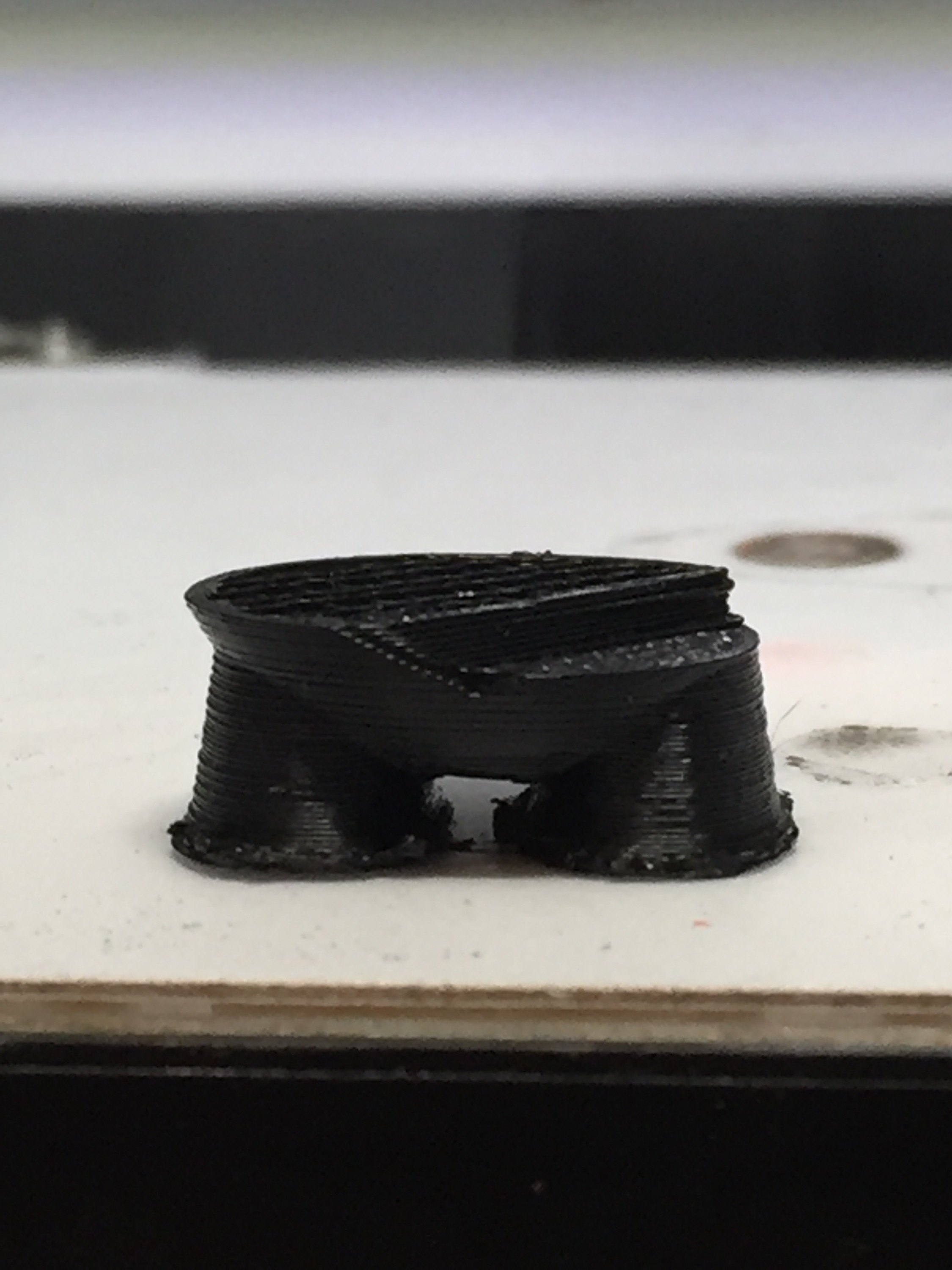

I am trying to print a dual color marvin but I am having some problems. I am using Simlpify3d and I have tried two things;
1. I took the .stl Marvin into Rhino and split the face and ears apart from the rest of the body and used the “Dual Extruder Wizard” in simplify3d to put it back together. When I print, the face only partially prints and leaves “V” in the bottom of the face out. There literally is only a “V” where the face should be. Everything else but the face and the ears prints fine.
2. I took the Solidworks file into rhino and I made the same two features solid and I have the same problems.
Does anyone have any better luck printing in two colors or have a model I can use?

send a picture, I never had problems.
sometimes it is advisable to use wipe & ooze screens for cleaner print but that has nothing to do with your problem.
3dpGeek
5
The second color doesn’t even start

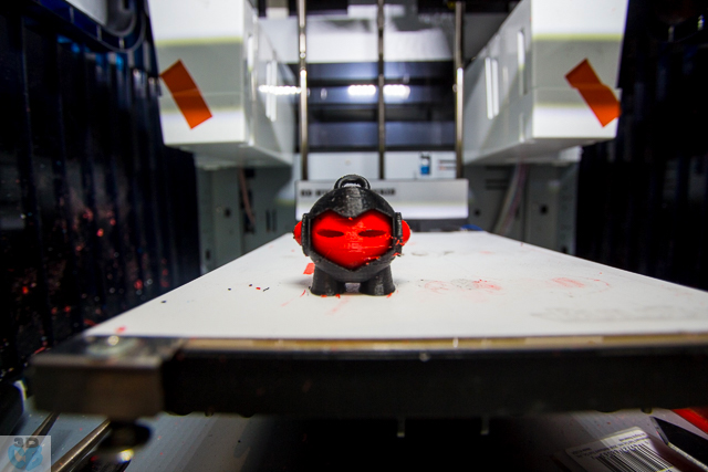

Looking at your STLs the problem is obvious. You separated the parts of the mesh, but you didn’t make them solid, manifold objects. Either one of them. You need to close the holes, make them solid objects, and, to make them nestle into each other a little. I’m not sure the steps to do this in Rhino, but I could do it on Blender lickety split.
I spent way too long on this this morning, and there’s still a small part that isn’t right (see if you can find it), but here you go.
See how these models are solid objects with and inside and an outside that nestle into each other? This is the way it has to be to work.

So the process involved making solid shapes from the shells that you made wasn’t as straight-forward as I would have liked. Mostly it involved locating the non-manifold edges and extruding them to a solid shape, then capping the hole by filling it in with an N-Gon. When I tried to make one model then boolean difference the other out of it, well it didn’t go well. Boolean doesn’t tend to like it when object have exactly intersecting points. So I basically ended up repeating the same action twice for the positive and negative spaces, and hoping that they were close enough. I haven’t test printed it, but I assume it’ll be fine.

I like your model better so far, the one on Thingiverse has a few things different. I don’t think they have one because I already asked which is why I have the model I posted. Gabriela should have your answer in the morning, opposite sides of he world problems.
When my print is done I want to post it on Instagram and Twitter, do you have a tag?
