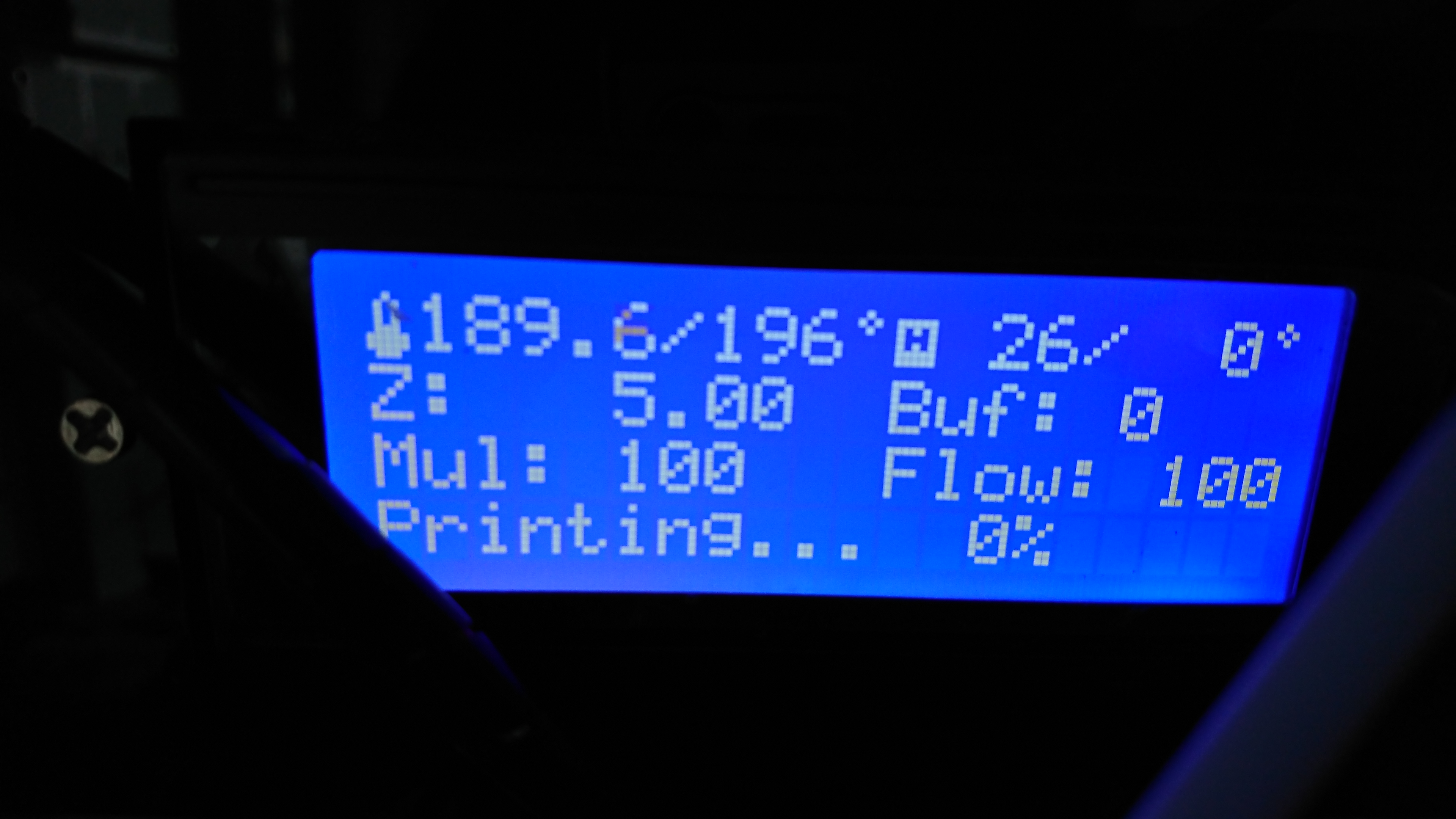

hey people, I hope you can help me. this is my very first time ensambling and trying to print with a Tronxy p208e, I followed all the instructions that came with it but when I try to print it keeps heating up and nothing happens :sob: I’ve been waiting like 1 hour and a half and still nothing, here is a picture of the LSD screen. I don’t know what to do

Your bed isn’t heating. You need to find out why. I haven’t seen your printer specifically, but I suggest looking for a fuse or a connection that isn’t correct, then also looking at a potential firmware issue. Also, check that your bed thermistor is properly installed and set up in the firmware.
Hi, thanks for the advice, I fixed the connections of the bed and now it heats, at least when I try the preheat function, but now I tryed to print the leveling test and still doesn’t print, I uploaded a video of what does it do It still doesn’t print =( 8
now I tried to print the very same file from the previous video :face_with_raised_eyebrow: but this time from the computer and the only thing it does is to heat the extruder and hasn’t reached the max temperature (189.2°/196°), the bed isn’t heating by the way. I don’t have any idea of what is going on or what to do. :sob::sob::sob::sob::sob::sob::sob::sob::sob::sob::sob::sob::sob::sob: again I uploaded a video 5 of what is happening. please help
