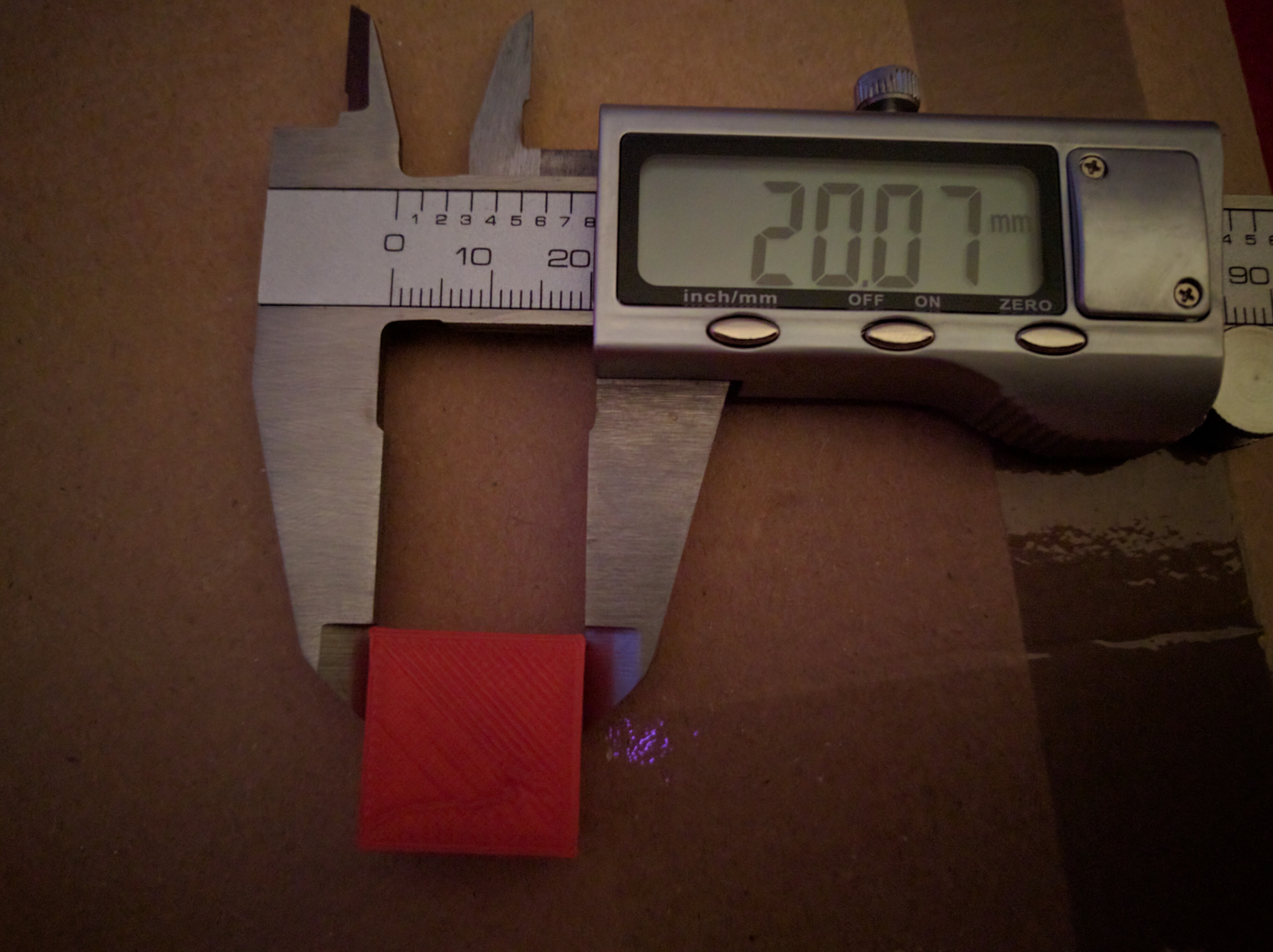

Thanks all for the tips. Printrr arrived today and so far it works great see attached pic of the 20mm cube. Only downside is the printer seems to be missing the panel of wood over the PCB not an issue I guess but still…
