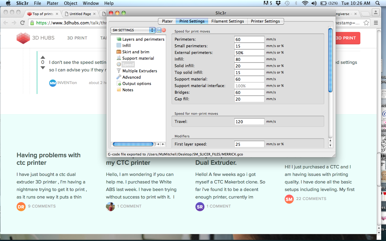

I don’t see the speed settings on your pictures. Very important. Low speed is better most of the time. CAn you upload a pic with the speed settings so I can advise you if they need to be different?
My apologies, I have attached screen shots of my current speed settings.
Try this, what ever I don’t mention leave it the way it is.
Perimeters: 36
Infill:48
travel :48
If you are using PLA then change your temp to Ext 220 Bed 60
Try that.
